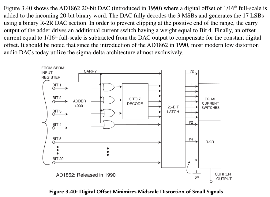

Some AD1862 porn I came across recently, needs sharing where there's a hotbed of 1862 worship😊

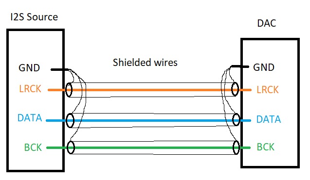

Try to shorten the I2S wires. Or use a shielded wire for the I2S (but it probably won't be the solution 😕)
attachment.php

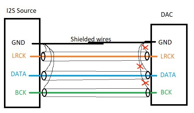

This is not good way of connectio. Try first connect grounds of 2 modules. Even if they powered from the same PS. Then connct the sheilds to ground at the transmitter (driver) side - I2S source. At the dac PCB shields should left un-connected. If the R for the signal integrity needed, apply it closer to the dac input.
