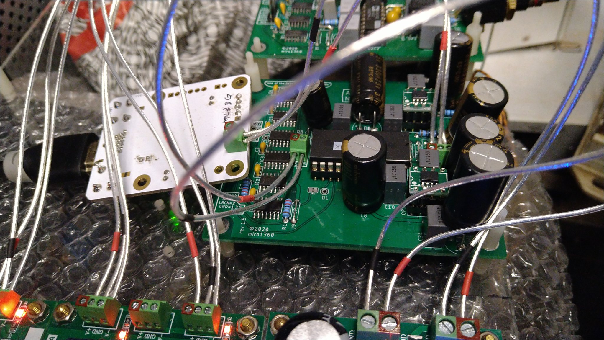

tried ad1865 pcb, really good, is another outstanding diy pcb, must try everybody.
hello ernst
i keep it run over 5 days, sound beautiful, i keep ad1865 chips over 15 years, just give it a try, omg, sound beautiful, my subjective compare, i love 1865 a little bit more.
diyiggy, i am still waiting 1k4 and 100R ac01, cant wait.

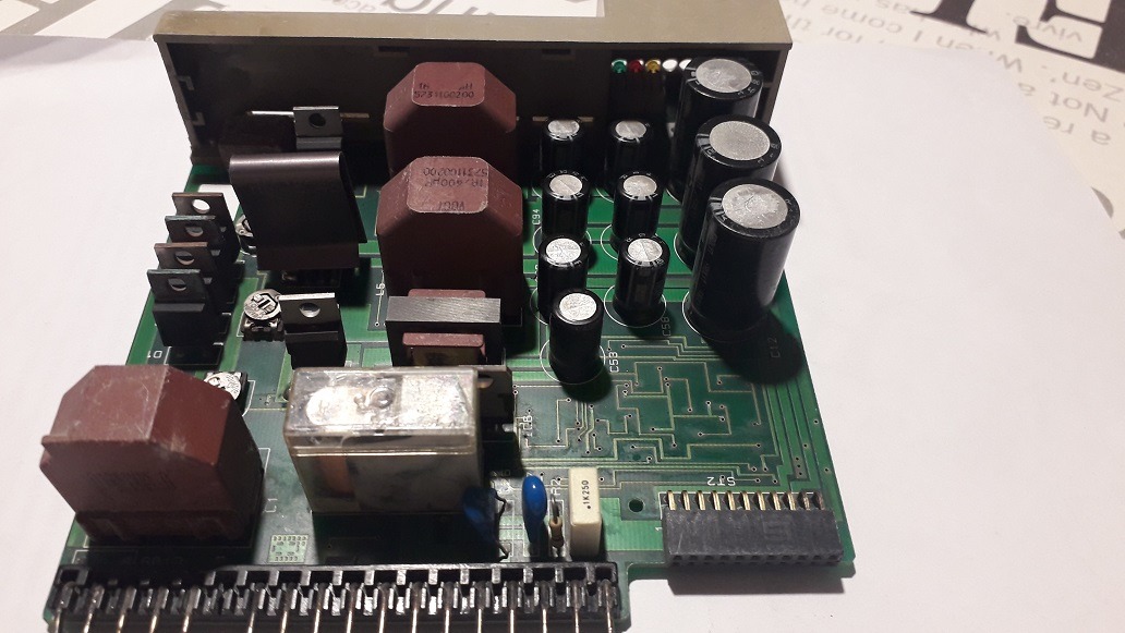

Very good capacitors, often in industrial electronics, in the picture is an old Honeywell SMPS with EKR and ERF series which has over 170,000 operating hours behind. So far I have not found any faulty or that it caused a malfunction of a module. For the Japanese, I can't say that.Ah, always something desirable special. What are Frolyt EKR?
I’ve never used them in the audio so I can’t comment on that.
