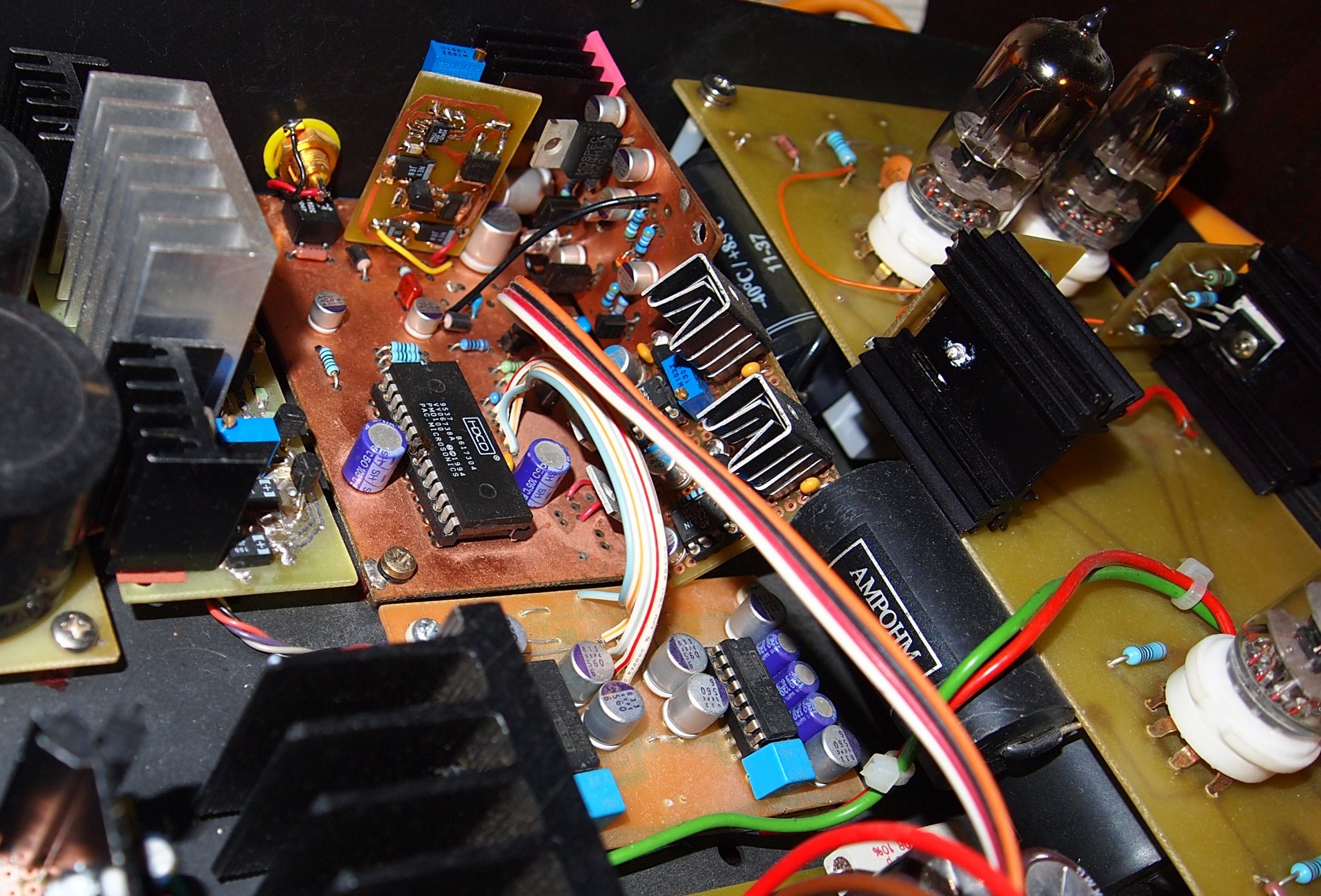

Do not bother to change the caps...vias are too small. Your board is goo enough on your picture.
True, os-con may sound bad, but if used around digital and with good regulators there is no problem. There are regulators that do not work well with os-con due to their low ESR, especially serial. I use UKZ only for references due to low leakage current, it has nothing to do with sound but measurements. Os-con better attenuates RF interference generated by dac than other electrolytes, you can do a simple test with an oscilloscope and see for yourself.Personnaly I do not like violett SEPC. Nore the UKZ that have odd and strange short bass, plus they are better if 100V. Anyway I would avoid both. But in the Grunf layout it maybe give some compensation that sounds good in the end withbthe others devices. You have to test to know. Be aware ad1862 and pcm1702 are very different animals as well.
I have tried os-con around other dac ic ,filters and digital recivers and would always be pleased with the results.
So we just disagree, sometimes more than often the sepc sounds bad in the digital as well, the sep are more forgiving most of the time. The sepc will fit only if your layout supports low esr, even that they are dry and thin...yes you can hear it in the digital by earing your loudspeaker... two caps that are ok with the scop do not sounds the sams whatever. At least I like to voice my dacs at the end with caps and I beleive I do because I can.
If you need low leakage then use the UKL serie in spite of the UKZ. Please try one day the United Chemicon I highligthed above.
We will agree on the good Amphom on the picture. I love all their caps, too bad they are NLA.

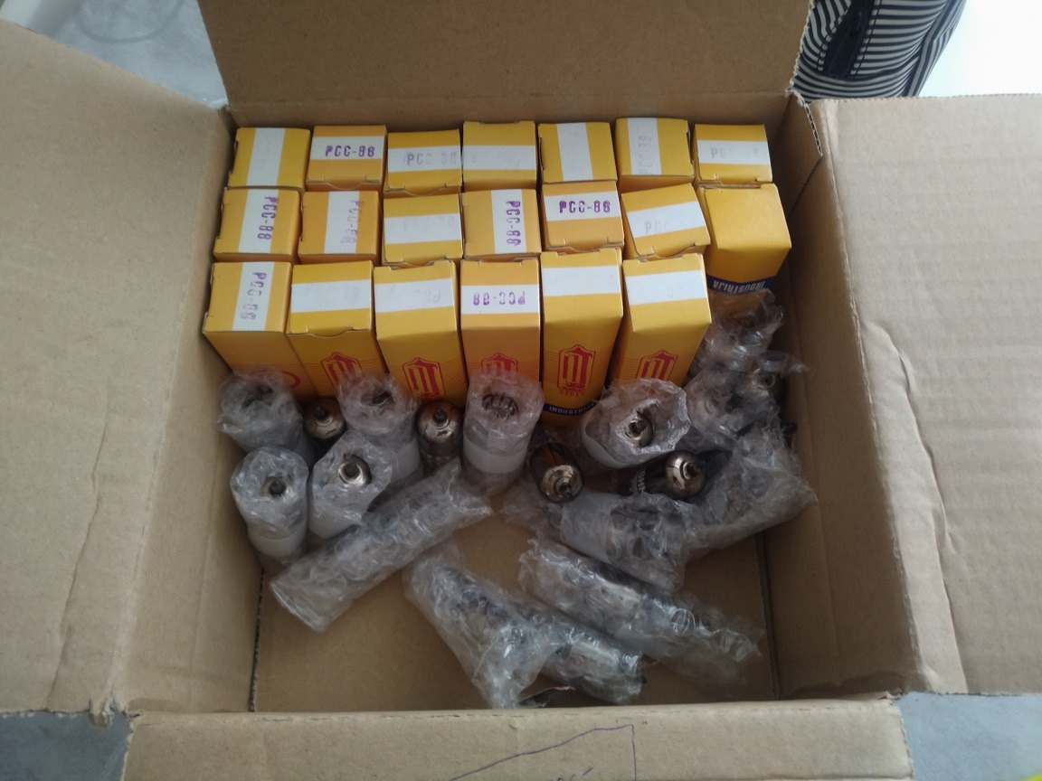

Your pcb job is very clean. Wanted to ask you about Ei tubes: what is Ei meaning please ? Where those ECC88 Ei were made? Herleen ?

Ei was a factory in the former Yugoslavia, exactly in Nis, Serbia, the tubes were made under the Philips license and on their machines, so they are almost the same tubes. They have a good reputation in the EU but also in the world. Unfortunately, they are difficult to obtain and expensive today.So we just disagree, sometimes more than often the sepc sounds bad in the digital as well, the sep are more forgiving most of the time. The sepc will fit only if your layout supports low esr, even that they are dry and thin...yes you can hear it in the digital by earing your loudspeaker... two caps that are ok with the scop do not sounds the sams whatever. At least I like to voice my dacs at the end with caps and I beleive I do because I can.

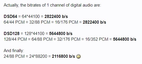

Basically, there is a clearly audible difference between CD and Hi-Res. The prerequisite is the comparison between well recorded and real Hi-Res files and 44.1 kHz files. There are numerous outputs that are merely upsampled. It is always worthwhile to look at the spectrum of the recording with a software tool. In my opinion, 96 kHz (still a doubling of the Nyquest frequency) is sufficient, which leaves room for improvement. Higher resolutions quickly become a kind of data grave, but have their raison d'être if someone follows a special temporary upsampling/software filter concept. With suitable player software. Or even if you want to test this in conjunction with hardware filters on your NOS DAC. My recommendation: Faith does not help here! Test yourself if it is good for you.Does anyone compare a different frequences (44,1KHz, 96Khz, 192Khz) on the same music? - is there a difference between CD and Hi-Res?
I have a few hybrid SACD disks and difference between CD layer and SACD is noticeable. SACD have more warm, volume of the scene and more realistic voice. I listen on my Denon 3910. The other thing - is that music on SACD is boring (jazz, blues, old rock) - I like a modern styles.Basically, there is a clearly audible difference between CD and Hi-Res.

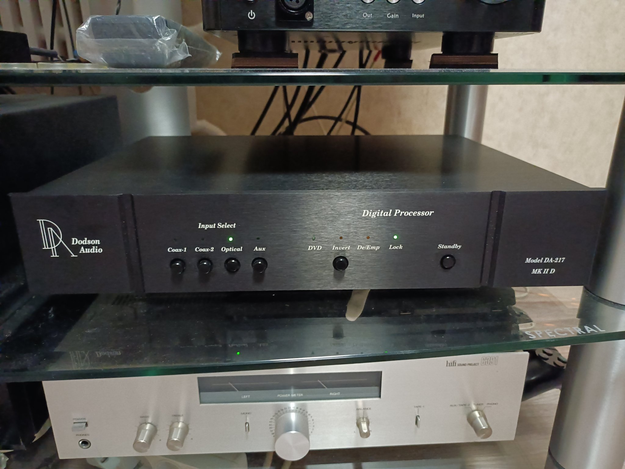

Now I have Dodson DA-217 mk2d (2 x PCM1704-K). He is same level like Levinson 360s. He's away for a week. I can tell you that it plays very maturely. Unfortunately I can't compare it with Miro's Dac. I will compare from memory later
My sources - PC with optical and Akai CD-79 as transport for Dodson.
