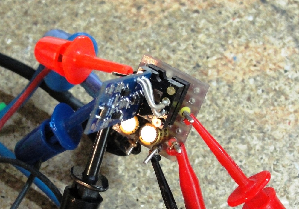

Built a special test fixture to measure the new SFC CEN IV.
Very happy with the results. All work first time.
Without any trimming, DC offset was already ~10mV.
After trimming, it drops to 0.4mV +/-0.5mV after 3 minutes.
Start up was 13mV, but already dropped to ~2mV after 30s.

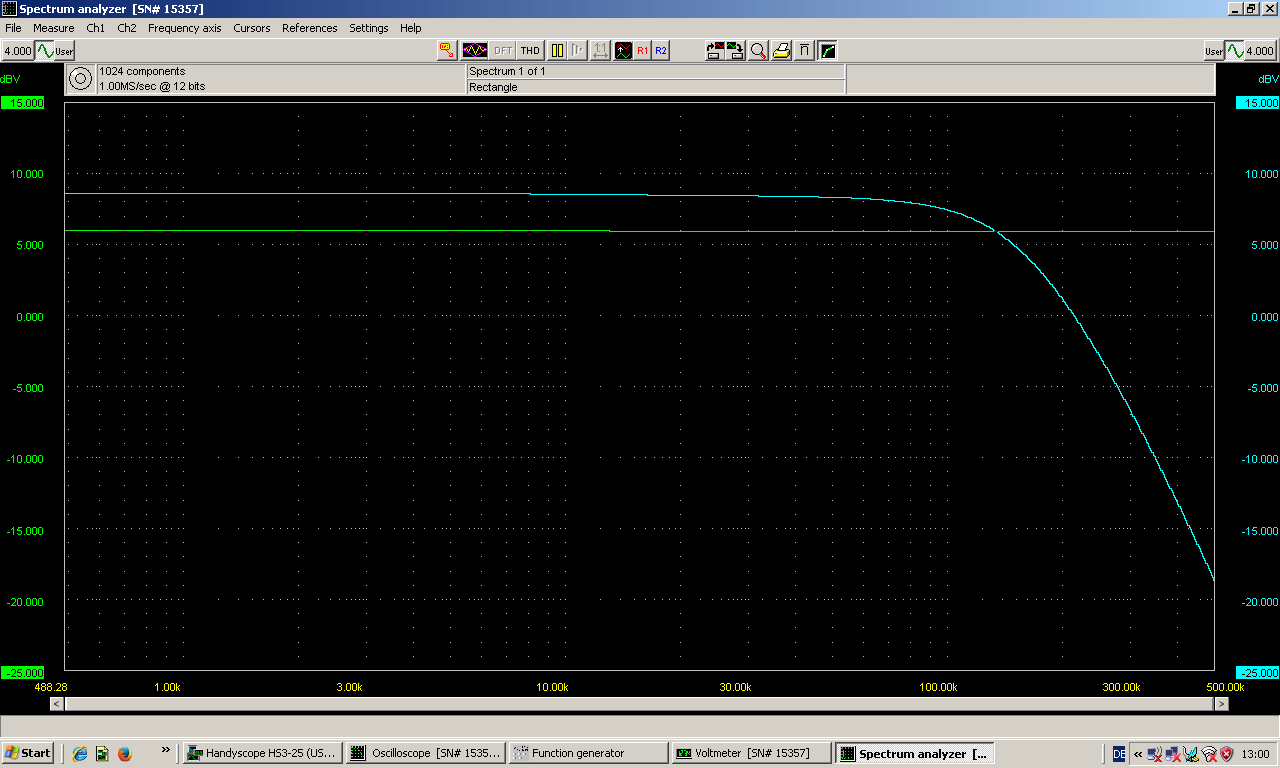

Perfect triangular and square waves.
Frequency response as expected.
This has built-in Sallen Key, so 3rd order drop.
So shall built 2nd channel and then send them off to Ireland for independent auditioning.

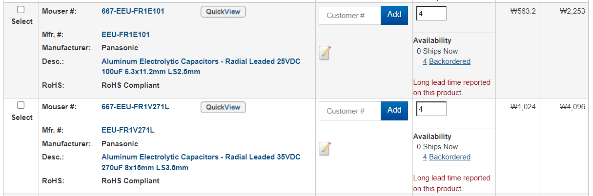

Hello
I am preparing to build an AD1862 DAC. I'm preparing PSU 2, but I can't find a Low ESR capacitor. Do you have any recommendations for substitutes?

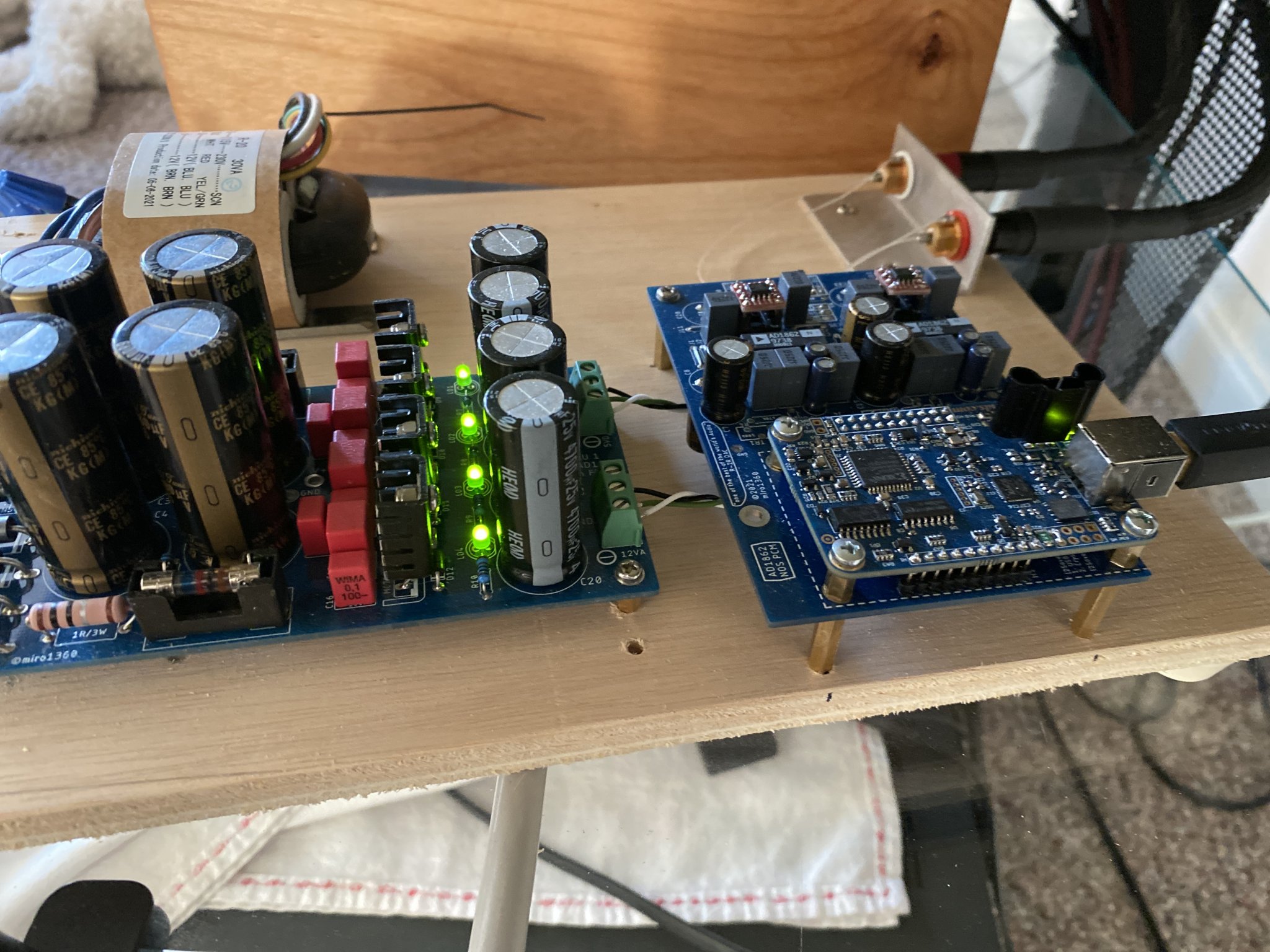

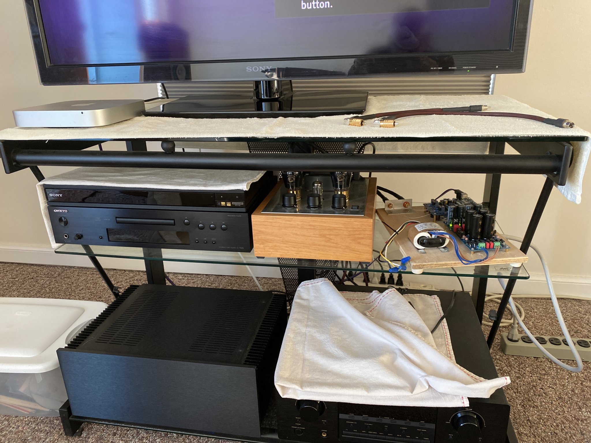

I need to settle down and just listen for a few days … first thing I noticed is the sound stage has improved.Just now listening for the first time,
PSU 1, LM 6171 , jlsounds, late 2012 Mac mini using jRiver player
Impressions to come
And thanks to those watching over me:
Miro, asilker and paddy and so many folks who I will never meet except of course online in this forum
Thanks everyone!
Must listen now…
For those positions Panasonic EEU-FM and EEU-FS would be fine subs, and some values in stock at Mouser; also don't ignore the very nice ChemiCon EKZ series.Hello
Be careful with lead spacing and diameter; the PSU2 board is densely packed.
Have fun!
Thank you for your reply. I pick ChemiCon EKZ series.^^For those positions Panasonic EEU-FM and EEU-FS would be fine subs, and some values in stock at Mouser; also don't ignore the very nice ChemiCon EKZ series.
Have fun!
