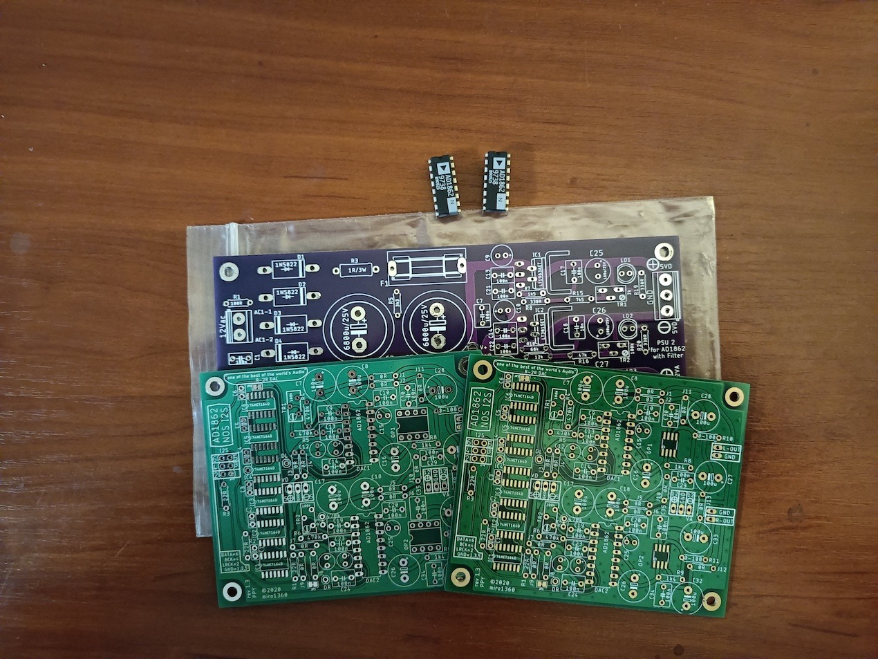

I got my boards and chips! Everything is ok. Thank you @Paddy Garcia
I will be order a details for boards.

You can do, it is comfirmed as working and great sounding device 🤩
Instead of modifying the DAC PCB I started designing a new 🙂
I would like to using the AD1865 DAC, with my Rpi4 and FiFoPi. I already have I2S to PCM card from Iancanada, but I would like to create pin compatible HAT with FiFoPi.
What is better (technical, sonical, jitter) feeding AD1865 with I2S signal through your shift register solution, or using Ian's I2S to PCM card where the I2S conversion has been done by CLPD (ALTERA MAX II).
