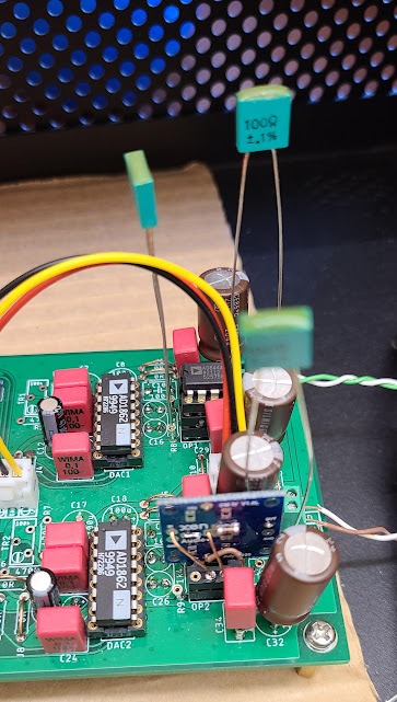

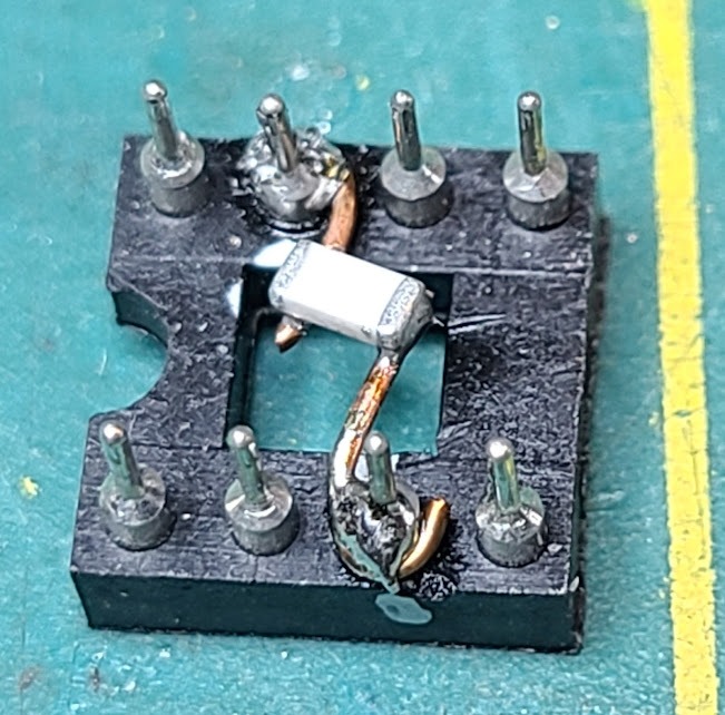

I just tried the AD797 with Hidy's recommendation of putting a cap across pins 2 and 3. I used a 1000pF cap and it does sound nice. I will try the same thing the the LM6171 and ADA4627 I have. May even try doubling the cap to get the recommended 2000pF on the AD797.

Well, it wasn't until you said that... I stole the kit I set aside for my son and built it up without the onboard SMD Civ in order to use the Xen IV.
I like to test op amps by putting different ones in and listening to mono music, so P&P would be great. Hmm. C31 and C36 don't have to be onboard, do they?
I seem I spot a couple of rhopoint... how do you like the sound? I have to look for a couple of those I/V boards...Well, it wasn't until you said that... I stole the kit I set aside for my son and built it up without the onboard SMD Civ in order to use the Xen IV.

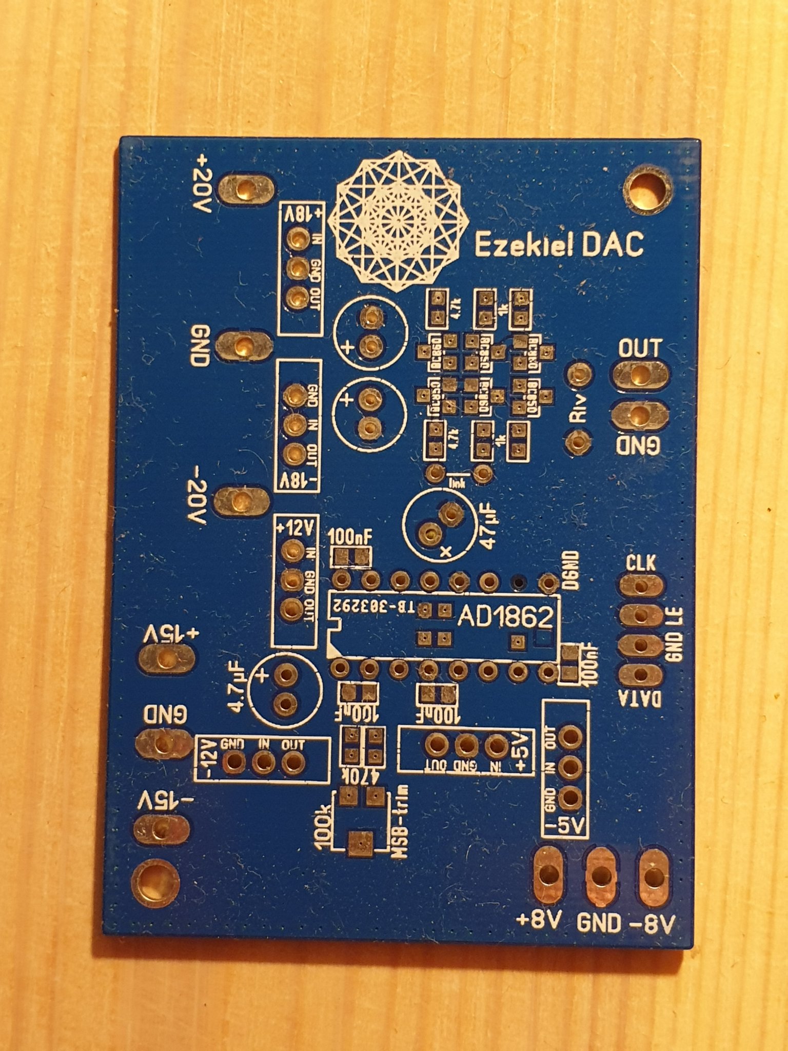

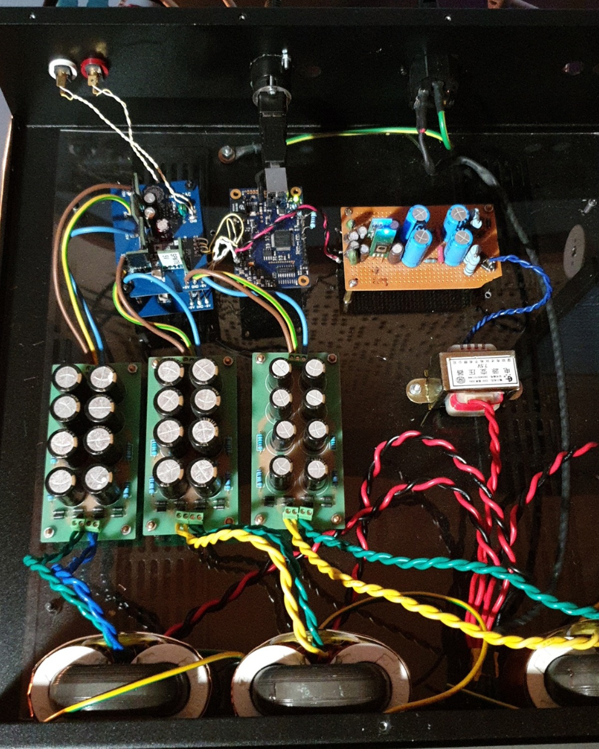

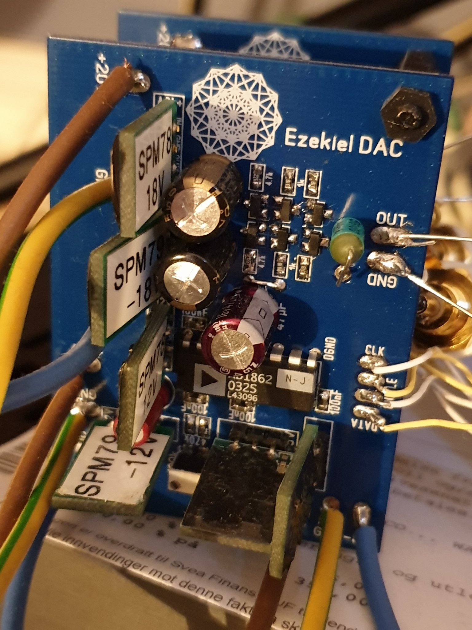

Back in 2019 I made my own AD1862 dac. I think there's a thread here on the forum. I went with a bit of a different approach, with two mono boards stacked on top of each other. And I use the JLSounds USB board to avoid the timing issues. I also went for a lot more surface mounted components, and a pure smd zero feedback discreet I/V stage. I have been using this dac in my main setup every day since. The AD1862 is absolutely amazing!
One question tho. It seems like most people don't apply the trim resistor. Why is this? In my experience it is absolutely crucial. As per Jocko Homo on diyhifi you trim it by feeding the dac with a -60dB sine signal and just trim it until the scope shows no noise. Or you can even do it by ear. Fire your amp up on full volume, play some music, and just trim until the noise goes away. The noise may be inaudible at normal listening levels, but it's certainly there.
I attached some pics of my build. It looks messy as heck, but it sounds wonderful.
