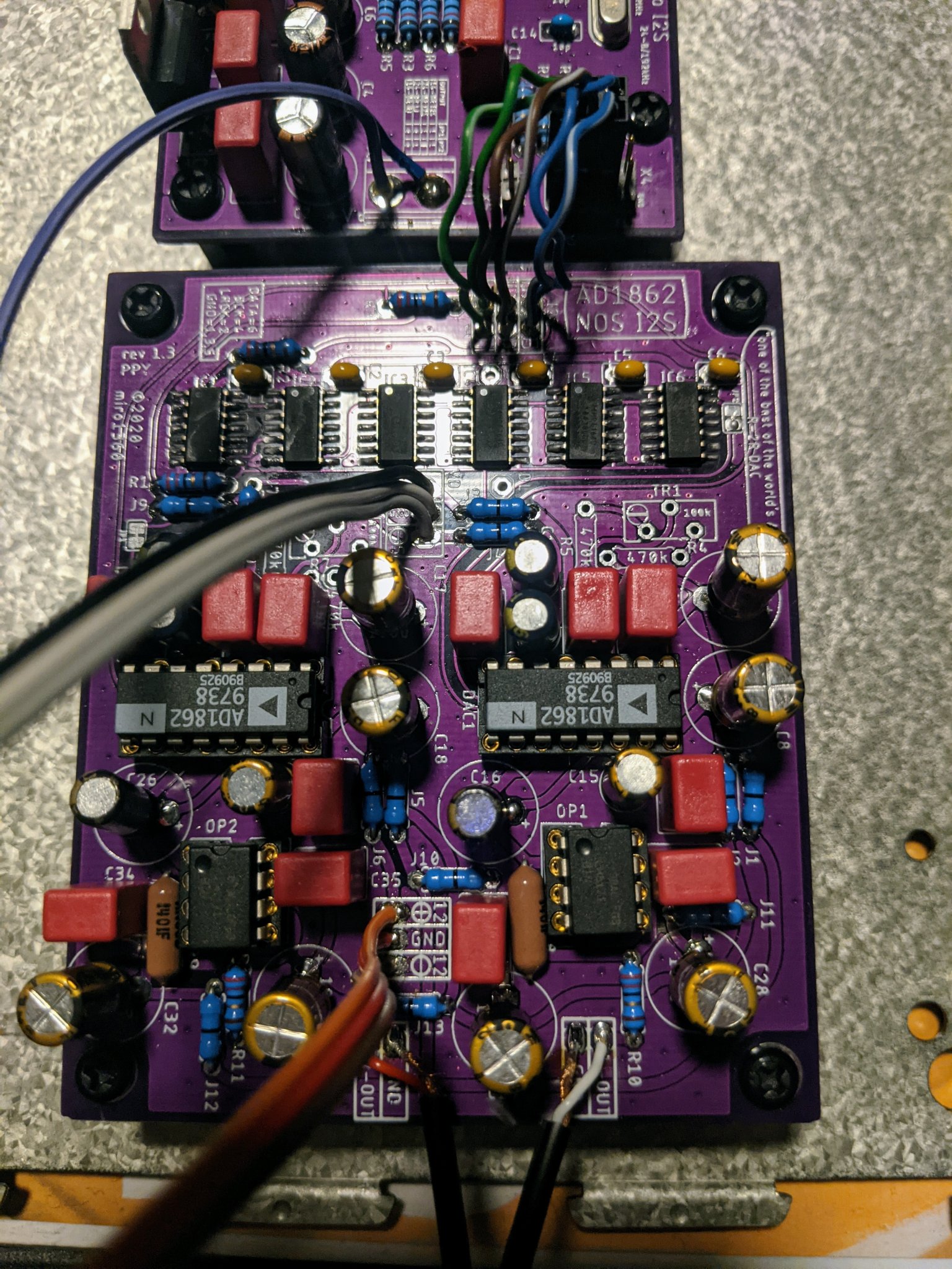

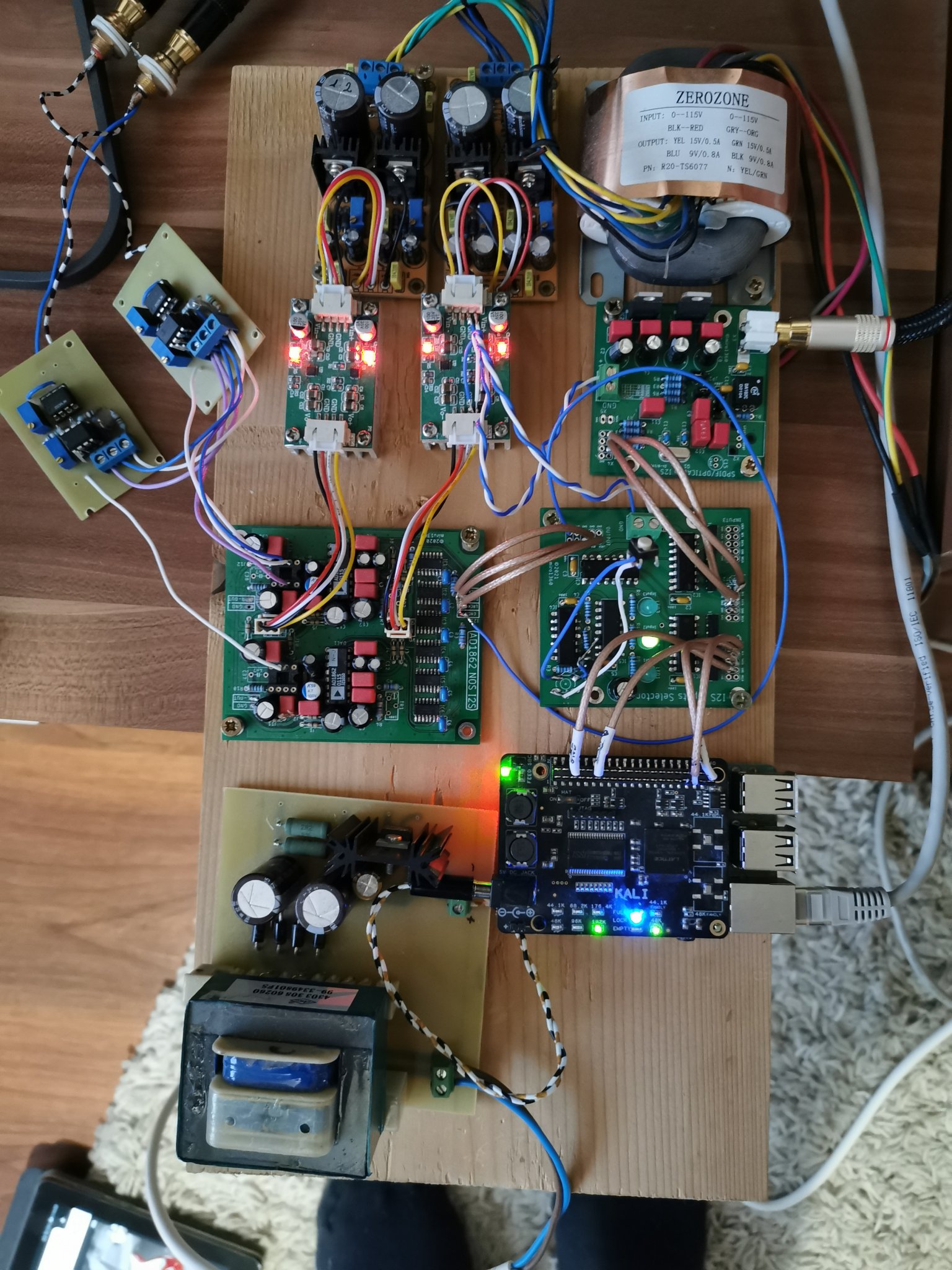

DAC AD1862: Almost THT, I2S input, NOS, R-2R

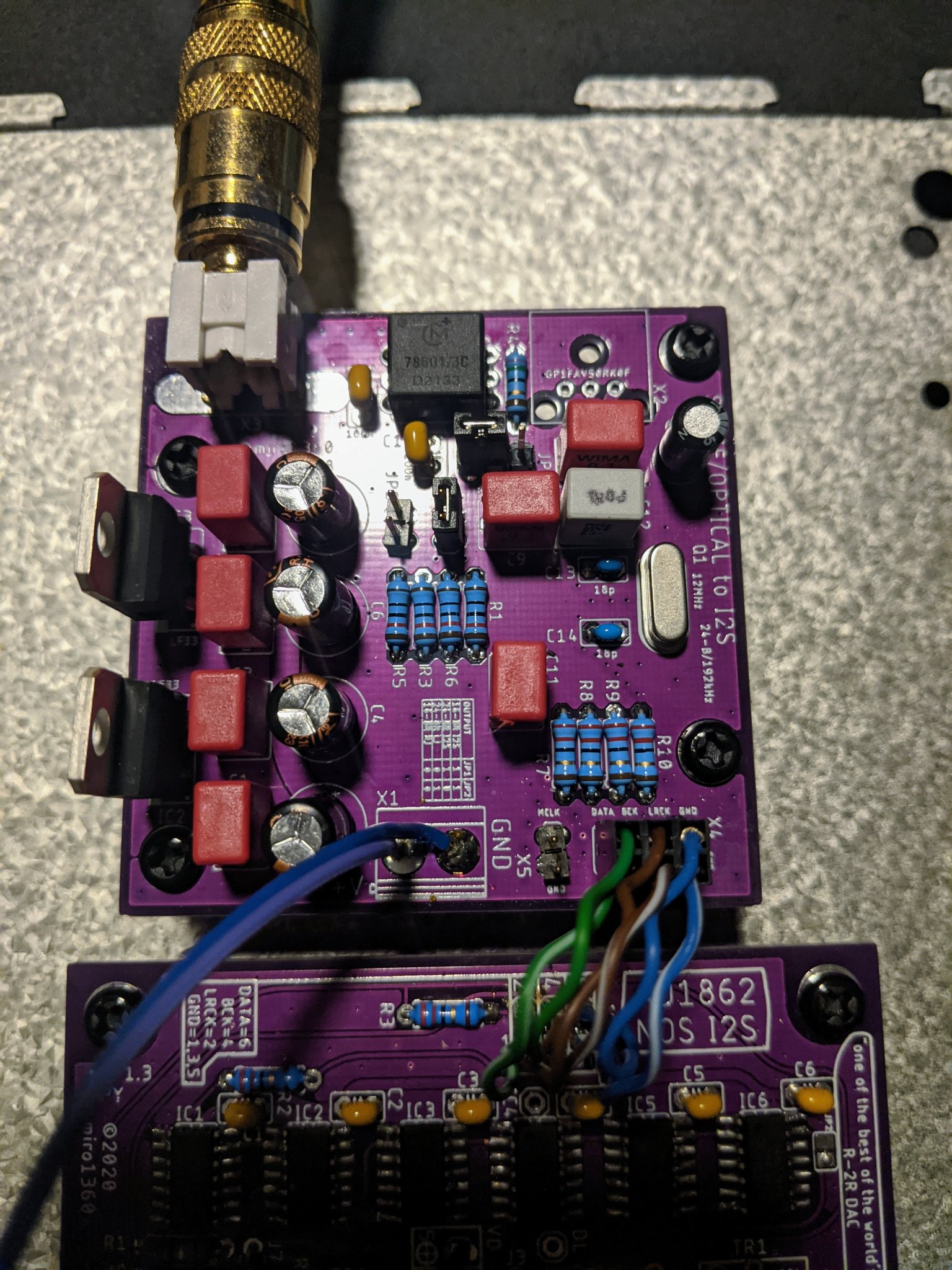

Good news is my SPDIF/Optical board works - get data, lrclk and bclk signals on the scope
Bad news is the DAC doesn't work.... need to trace some stuff out. Got power in all the right places, but data isn't getting through. Time to see what I can find with the scope. Expect I messed something up on the 74HCT164D somewhere
When I connect the DAC to the I2S board the LRCLK signal is still good. But the other 2 signals drop to zero/noise. So I am not sure what's going on at the mo. I've pulled the opamps and DAC chips out for now.
Fixed it - had shorted 2 pins on one of the 74HCT164D underneath the chip with a blob of solder. What a muppet!
Better go and listen to this thing now!
First impressions spinning some of my regular test tracks. DAC sounds beautiful. Much better imaging over the standard DAC in both my Roksan K2 CD and Hifiberry DAC (RPi). I'd say a much better overall balance, slightly smoother treble than the others. Overall very good, was a worthwhile venture to get this far. Need to finish it off now and figure out how best to switch between the Optical and Coax inputs.
Rest of my system for reference is DIY VTA PH12 pre amp and ESP P101 MOSFET power amps with AE2 speakers.
Forgive the dodgy test layout.

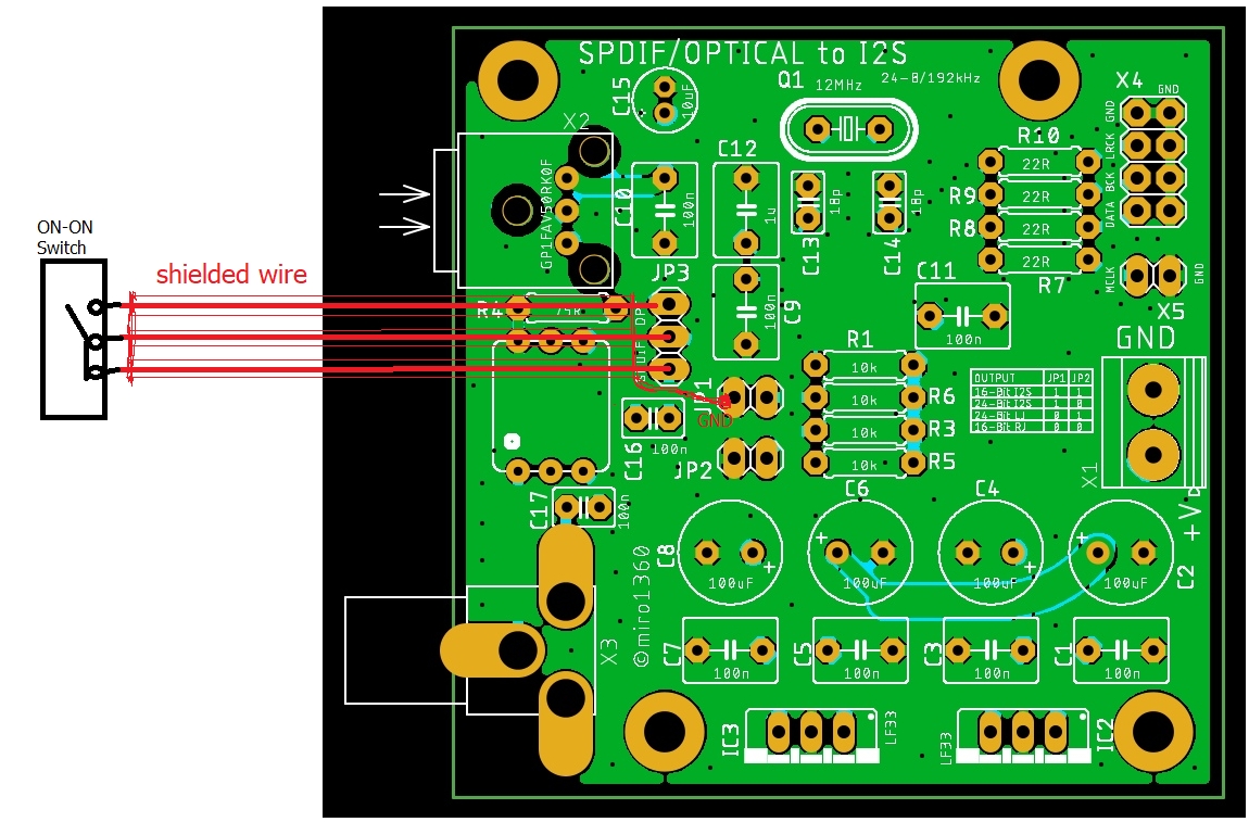

Question for the collective. The SPDIF/optical input board has a jumper to select one or the other input. I really want to use both with 2 different sources. Can I fit a remote changeover switch given that this is in the digital signal path? It would be around 6" of cable to the switch on the panel.
Would it be better to build another input board and switch them with an I2S switch? I have the boards and components to do that, but if I could run less boards then I'd prefer that.

Use a switch wired with shielded wire (it can be SATA cable or anything for HF) ... the shield must be connected with GND on one side (shielded wires near the switch are connected together) 🙂
Another option is can be relay as jimk04 suggested.
Thanks very much! I'll give it a try and let you know how it goes. I have some spare SATA cables kicking around so will use one of those.

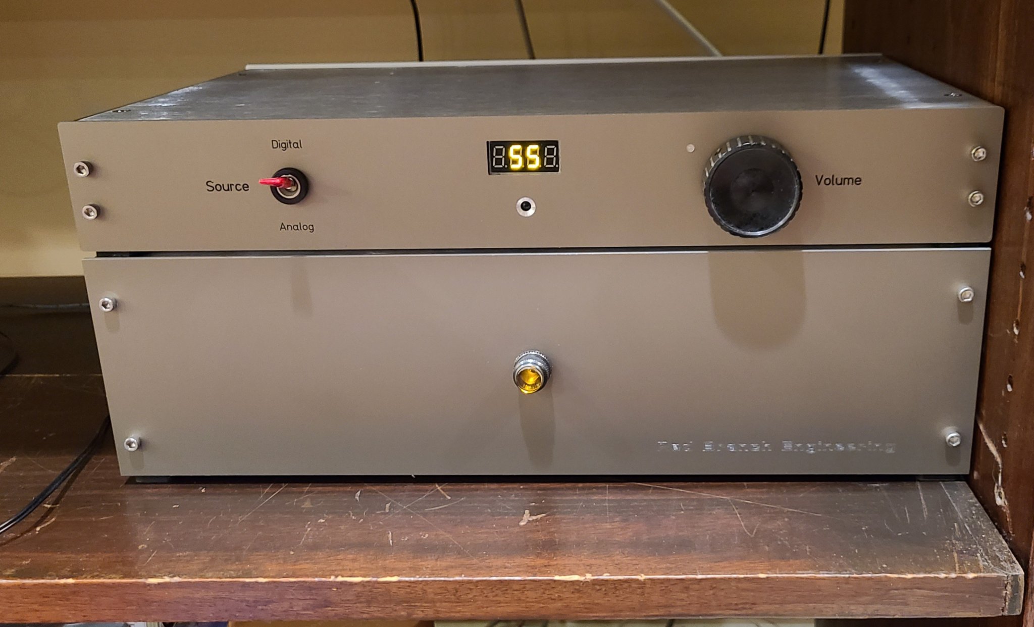

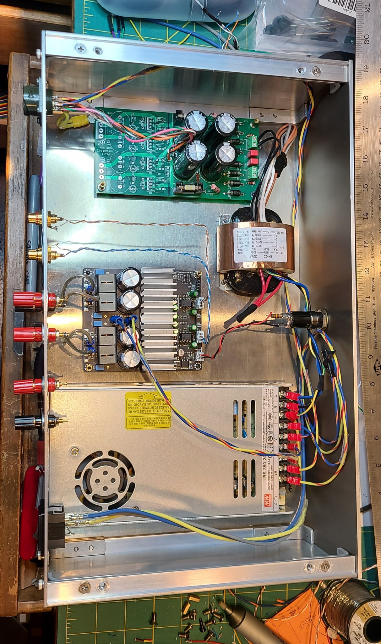

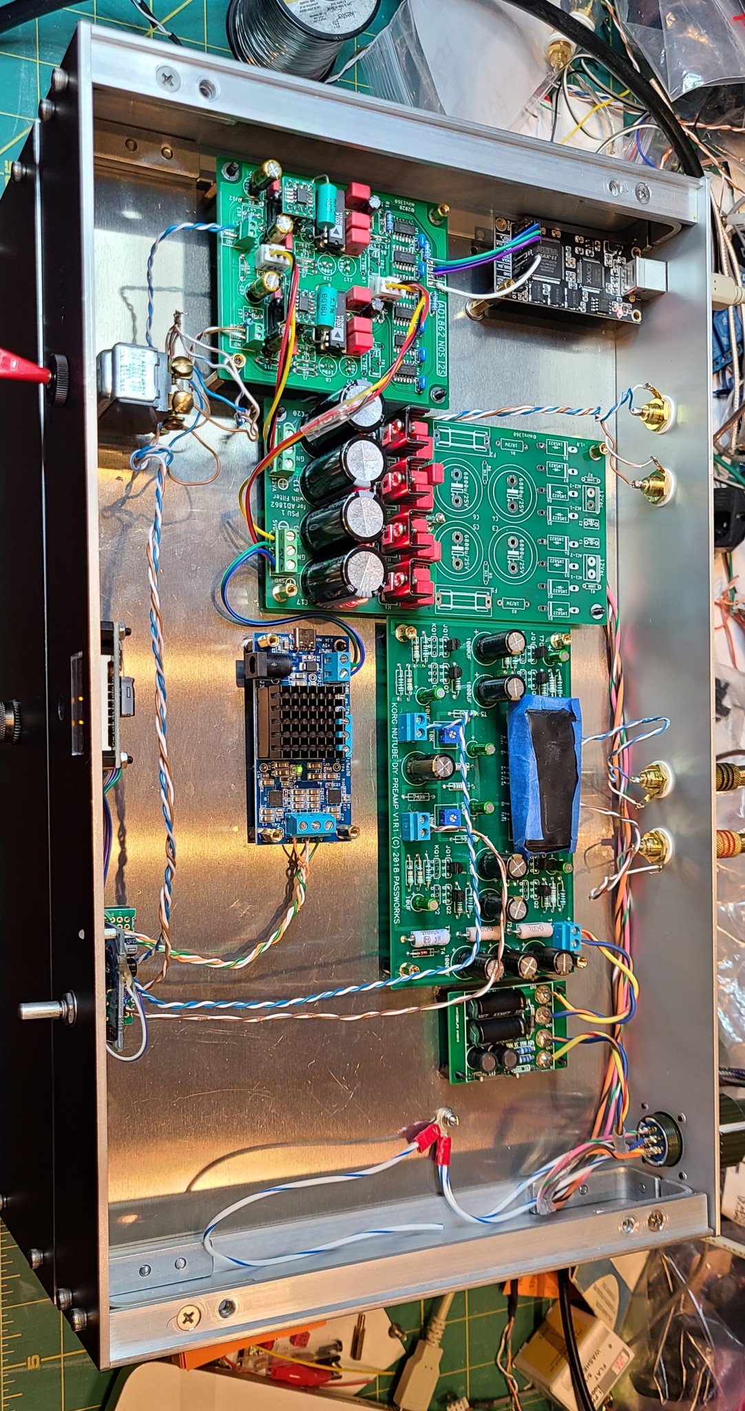

I've got a nicely tuned miro DAC system in my office, one for my dad, a kit packaged with a Whammy headphone amp kit to give to my son when he finishes his Masters this spring, and now one in the living room. I guess I could build one for the garage, but that seems excessive.
Here's the latest package, all follow the same pattern of a Miro DAC, a Pass DIY B1K preamp, Academy Audio Muses volume control, 3e 3255 class D amp, and power supplies. I tried in the past to cram all this into a single 19" chassis, but that's 10lbs of electronics in a 5lb sack. Here, the power supplies are packaged with the amplifier in one box, with the rest in a second box. Was going to put the DAC psu into the lower box but read here that the regulators should be close to the DAC, so there's a half a PSU in the lower box, rectified DC runs through the umbilical, and the other half upstairs.
Very nice work Paddy! You’re not kidding, lots of goodies packed in those two chassis. I see you tweaked the NuTube to kill microphonics and have MJ’s smps filter, nice!
I think you need another system in the garage, not excessive in my book! 😂
