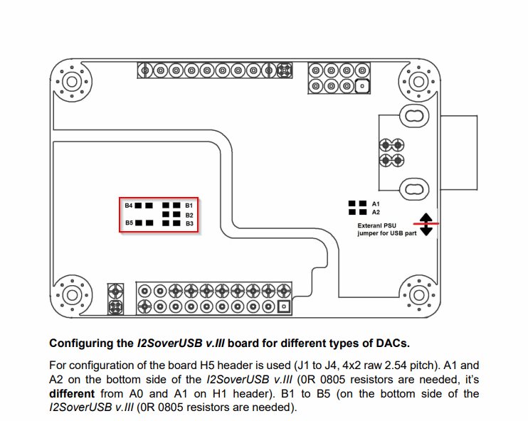

I configured the I2Sover USB according to manual

@baggerbole - if you are getting static type noise then it is likely that something is wrong on your digital lones - eg lrck and bck mixed up or maybe a ground not connected. That heatsink n the jlsounds board gets pretty warm, and that is normal. If you have a multimeter, you can check that you have signal flowing on the digital lines - your dmm will measure the high frequency i2s data as DC votlage. So with material playing you should read a DC voltage of .7-2V on each of bck, lrck and data (when something is actually playing) (measured against ground). If you have signal on those lines, then there is a very good chance it is one of the i2s lines mixed up.

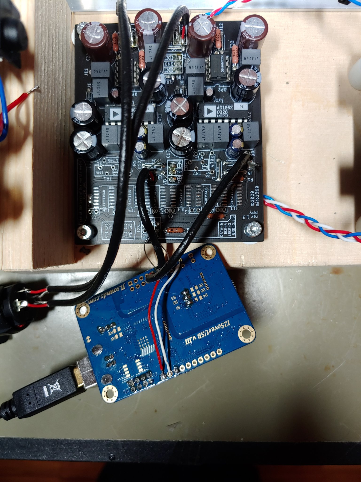

@miro: As on Vunce´s I2S board there is no U10 installed. It looks like a layout design revision.

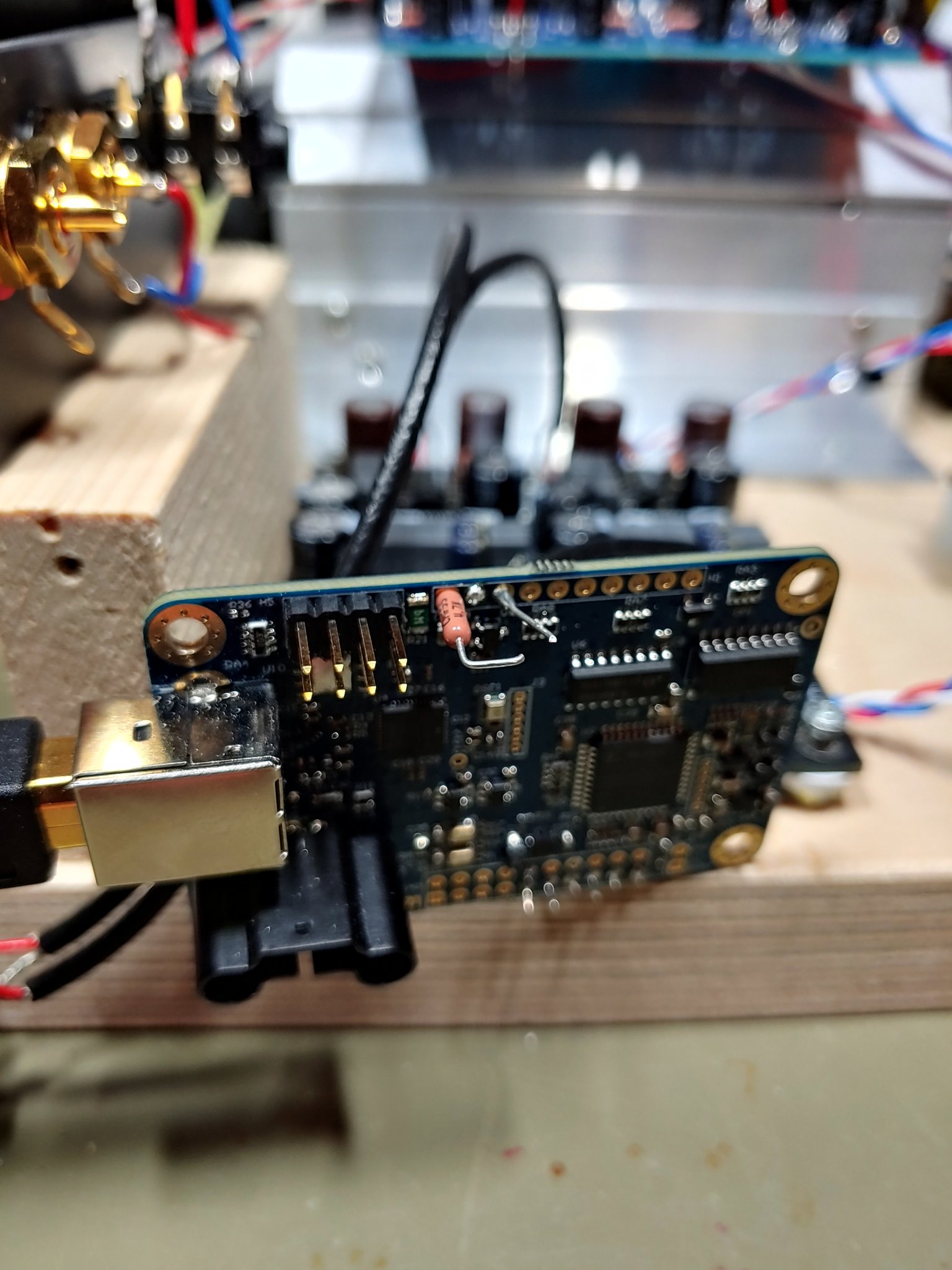

The jlsounds doc describes B1 to B5 short bridges. On my board it´s B1 to B6 as you can see from first picture in post #3245.

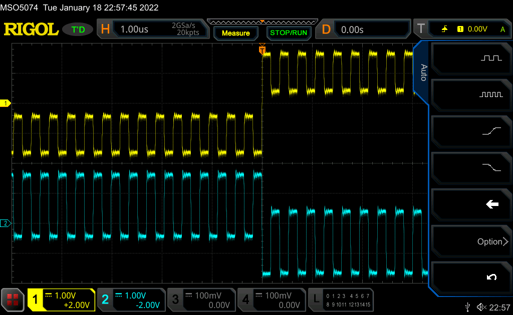

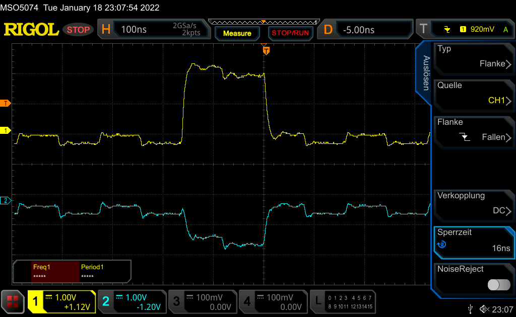

@woodturner-fran: Yellow trace is lrck, blue is bck (first screen shot)
Yellow trace = DL, Blue trace = DR (third screen shot)
