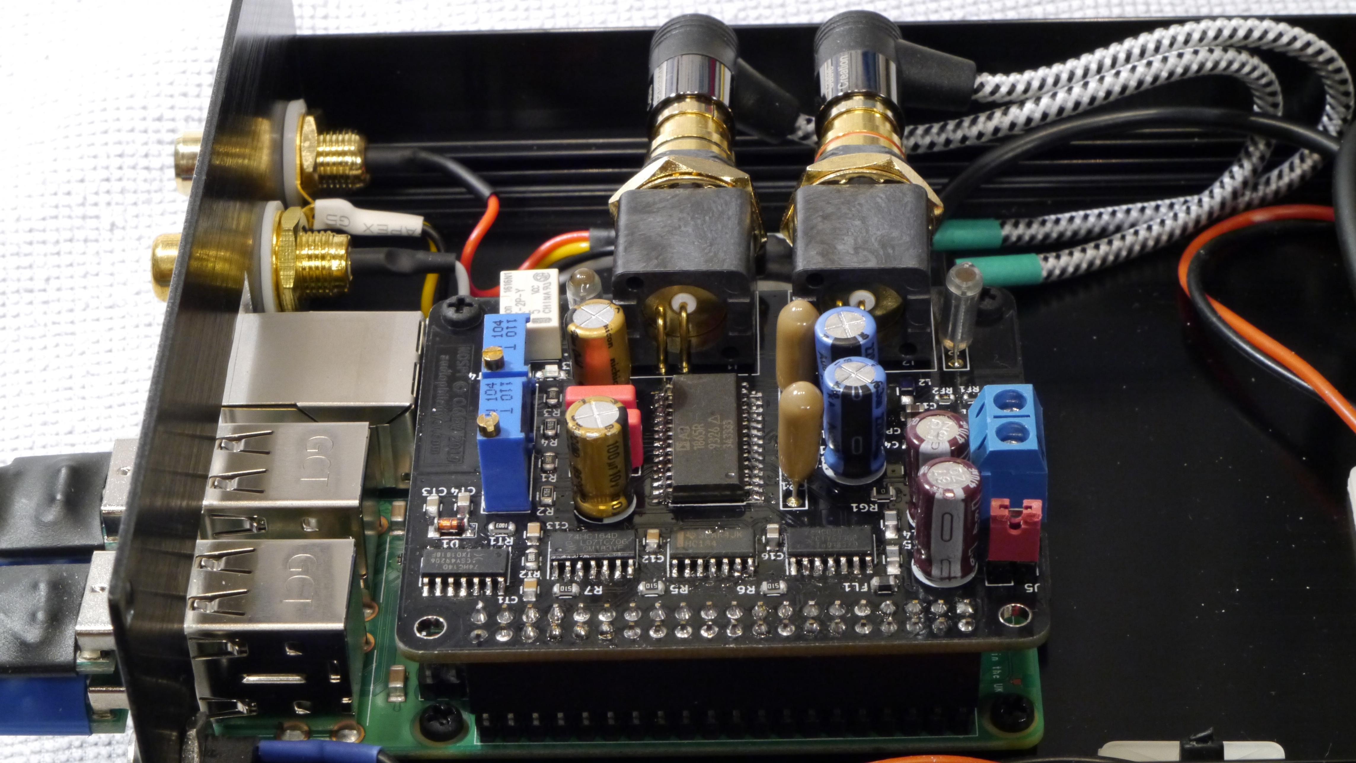

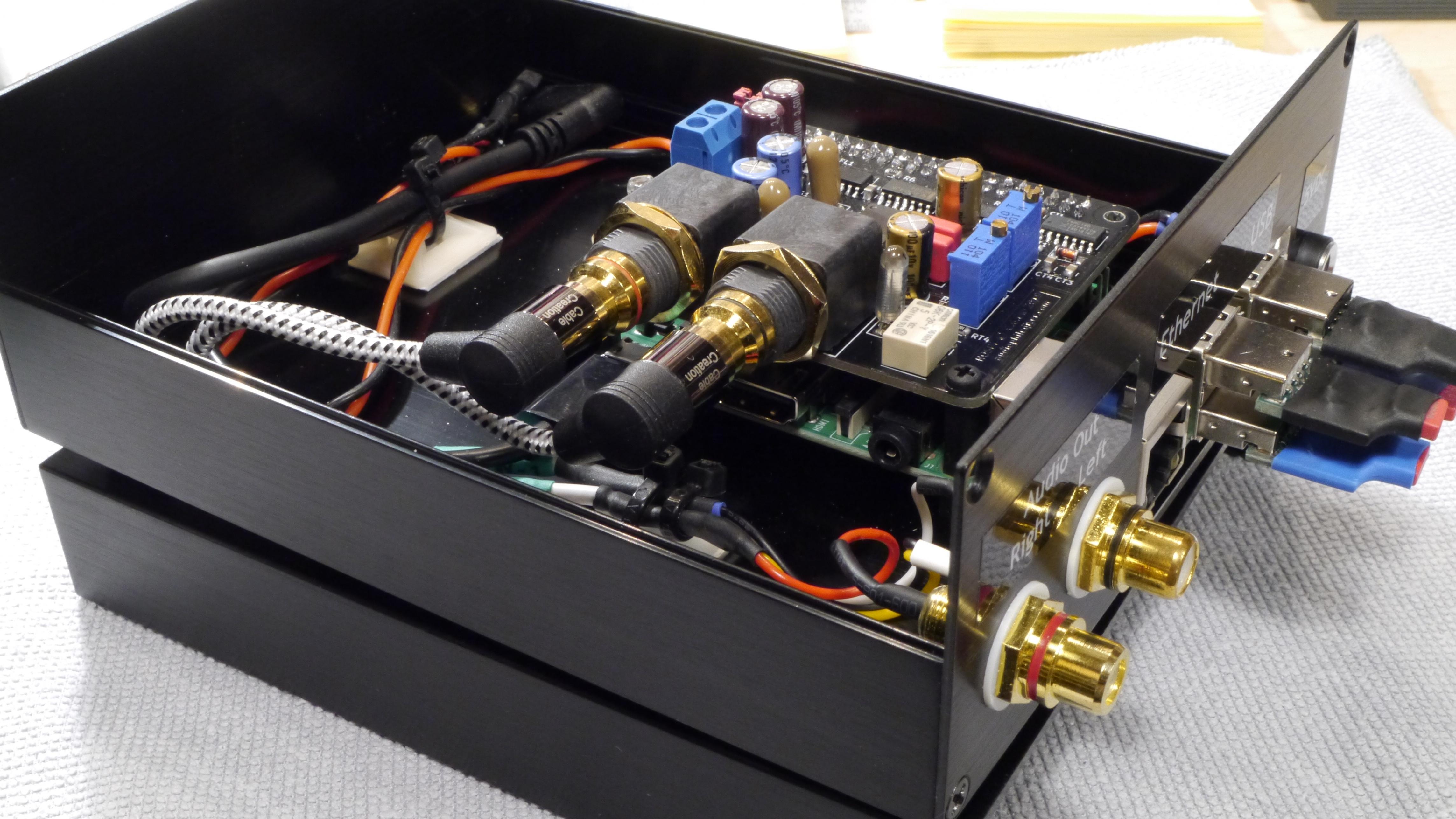

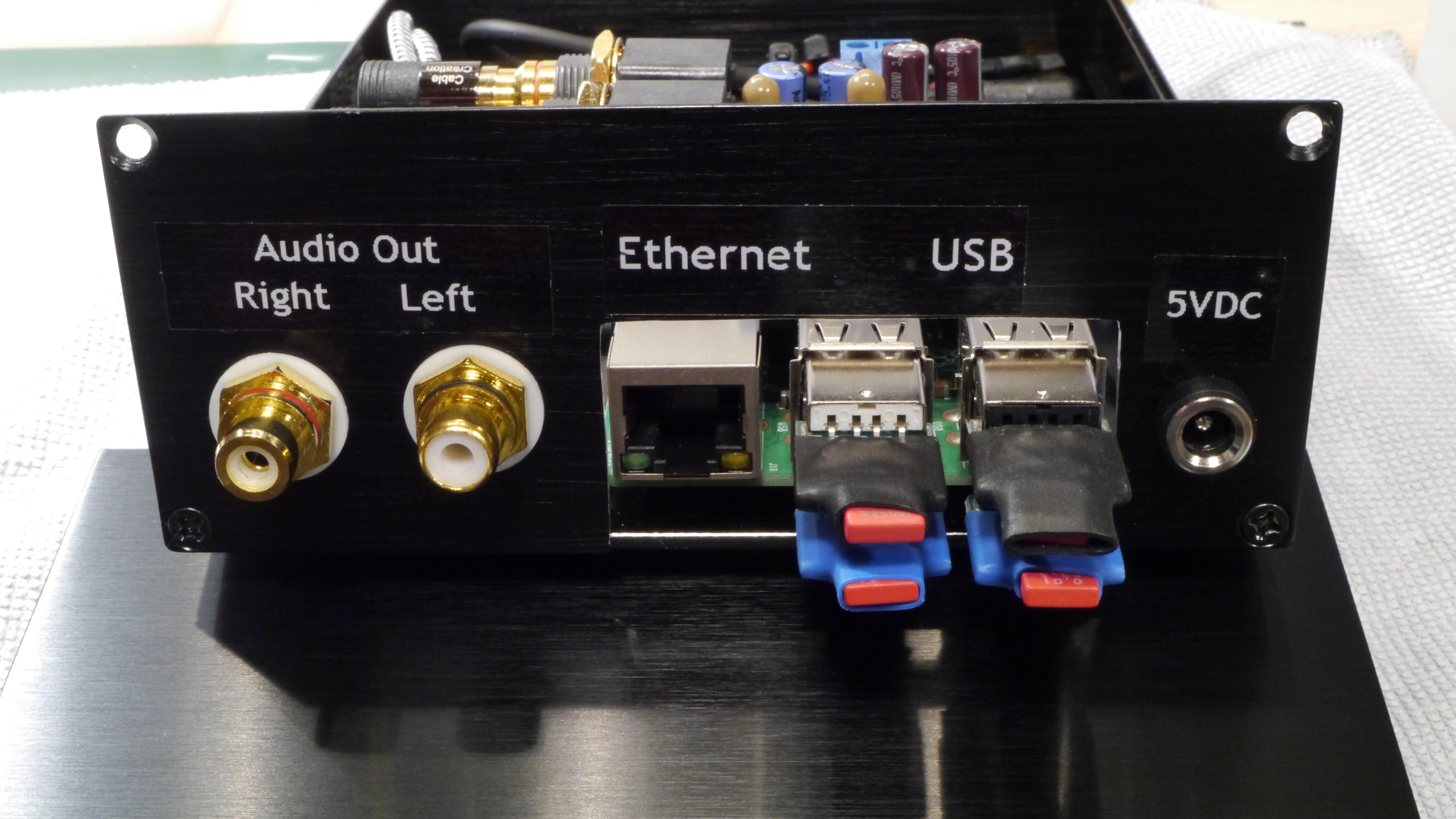

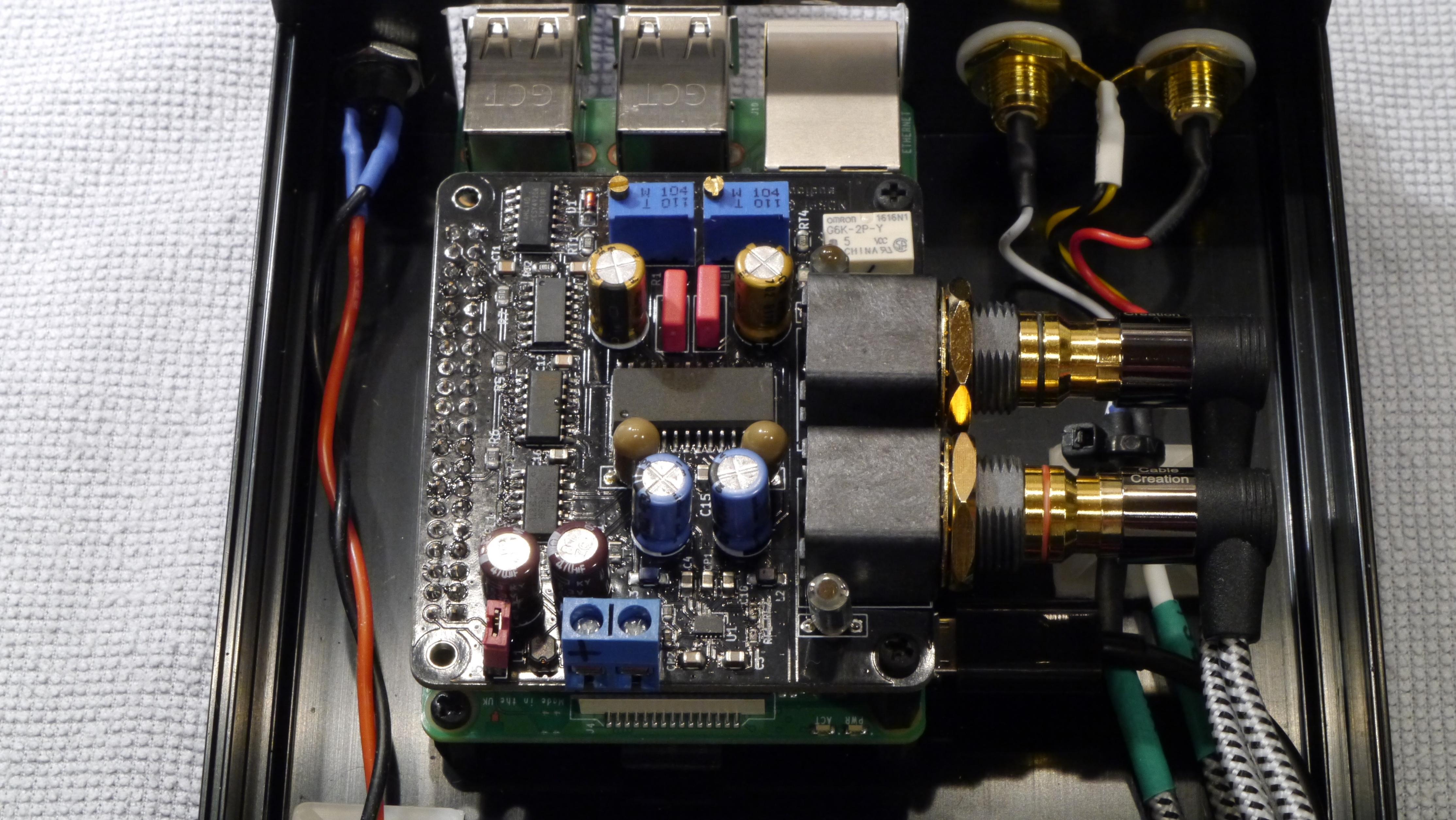

A couple months ago during the lockdown, I discovered another DAC that was based on the R-2R AD1865 chip. I found a guy in Malaysia who had adopted his larger design to the RPi form factor, and thought I'd try one. He had hand solder some a few years back and had one on hand. A week later it was in CT! 😀
Some pictures of the RPi based board in my little streamer chassis. In the present configuration, I have it running on a single linear 5V PSU. When I fired it up I was pleasantly surprised by the overall sound. Especially, for a NOS chip. In roon it's very easy to group 2 DACs (endpoints) together and do A-B comparison of two different DAC, using the same source just by changing the pre input. Funny thing was, both me and my son couldn't tell that much difference in sonics between the two; my big multi-PSU system, and the little single power source AD1865! My ES9038Q2M system still had a slight edge though. Sometimes NOS surprises you!

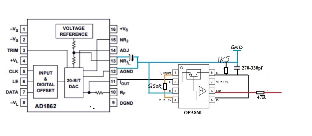

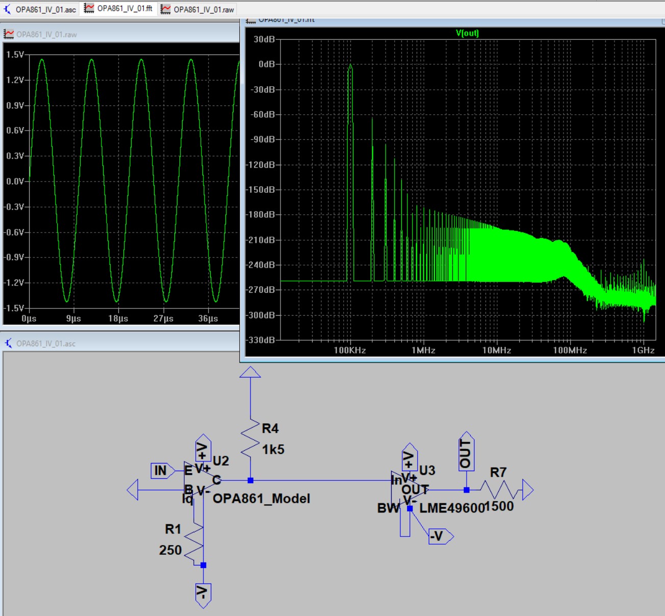

Has anyone used the OPA860/861 Operational Transconductance Amplifiers with the AD1862 for I/V and buffer duty?
The OPA860 has the buffer integrated, so I’m thinking this could be simple solution with a few modifications to Miro’s board.
https://www.ti.com/lit/ds/symlink/o...ll-mousermode-df-pf-null-wwe&ts=1594306753798
https://www.ti.com/lit/ds/symlink/o...ll-mousermode-df-pf-null-wwe&ts=1594306798961
Maximum supply voltage for OPA861 is +-6V (+-5V is ok).
The best THD from this OTA is about 0.05% (100kHz) with a good external buffer like LME49600. This buffer can handle any headphones and THD will be stable.

Thanks Miro for running a Sim with the OPA861🙂
The +/-5v supply isn’t a problem.

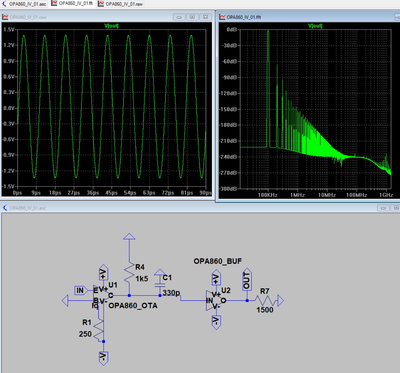

For an even simpler option, the OPA860 has a buffer already.
If you have time, can you run a Sim with this OTA also?
Thanks!!
stay with the opa861 for a better result, you can divide by two the 1k5 I/V resistor if not needed 2V outputt. R7 is 150R, not 1500? A // styren with tin foil from LCR till 1nF is advised if you listene to NOS material lile RedBooks. The opa861 without buffer can drive a pre or an amp with just serie resitor.
Is it not better toputt a resistor between the opa861 outputt and the LME ?
You can also use a 861 reversed instead the LME for the buffer. the 861 has no feed back s quiet simple.
You can share the same 5V but local decoupling is important at the feet of the chip.
OPA860 with integrated buffer has similiar THD (about 0.05%), but the noise floor is worse (if the load is 1k5), THD is way worse for higher load (0.8% for 32R load, in LME49600 it still be nice 0.05%)
