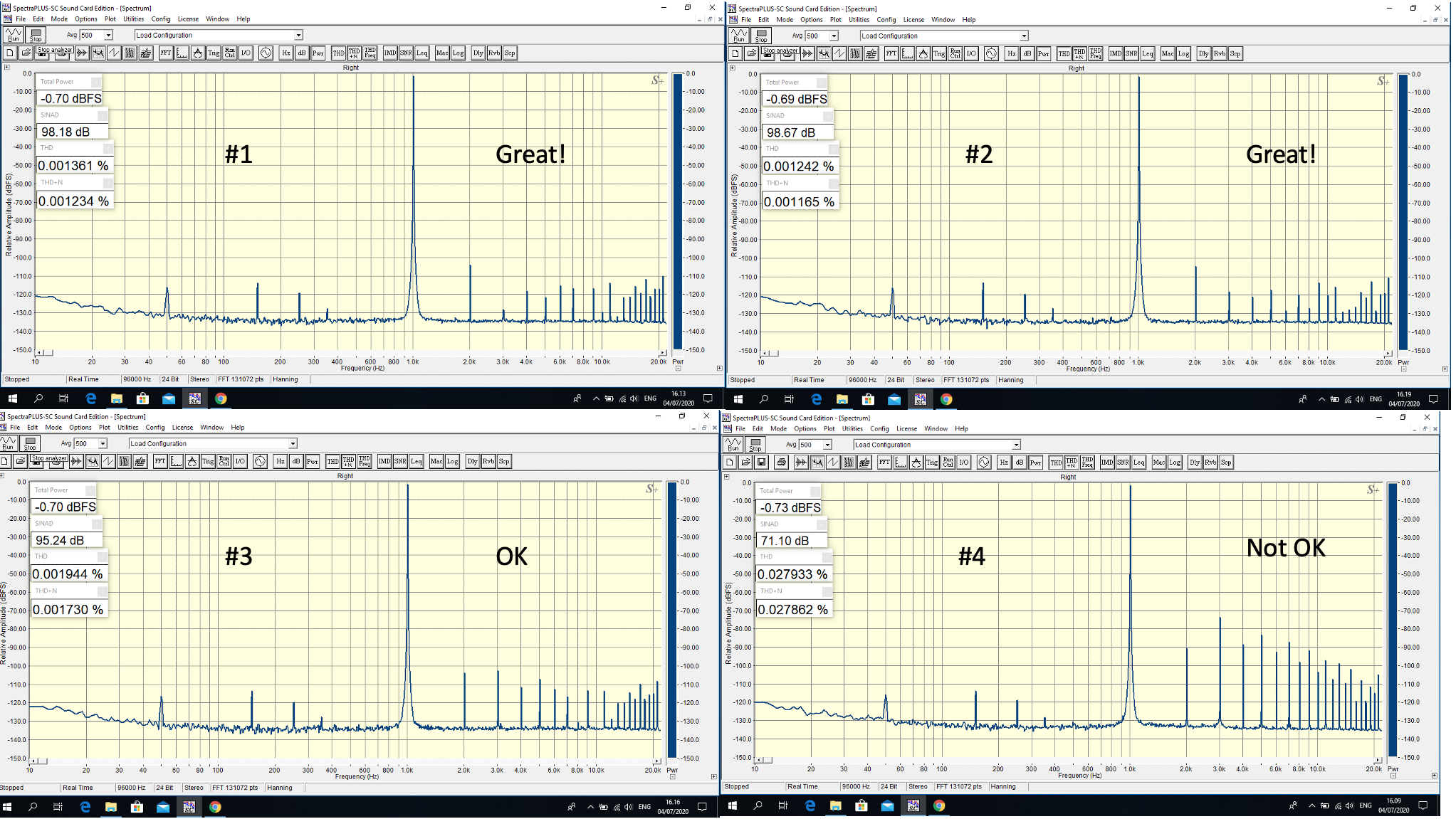

just received some AD1862NJ from China. measured them in one channel. they appear a little different and I would say one needs to buy 2x in order to pick the good ones. and yes, the distortion is audible - dirty highs and sibilance 🙁
they are real AD of course, but being used, so good luck is needed
I think, the shop is no worse than any other one. apparently miro1360 has left a good feedback there. this is just how the things are with those obsolete chips.

It can simply be a second choice quality control genuine stock that are planed for garbadge ! putt one in a pair or a quad : no little economy if you're a merchand ! Commercial ethic is poor in China, they sells themselves contaminated milk for their babies, so a bad da chip, you joke, no problem, lol 😉 . Such people waste the efforts of the others good vendors alas !
I received my pair in less than 15 days from a China shop but I didn't measured the chips yet ... I never tried though, maybe with Arta or Rew... not sure my Pre tracker pro soundcard fro E-Mu is good enough for such a job. While the 70 db noise floor on the thir harmonic posted should be detected if it's a bad chip as above !
