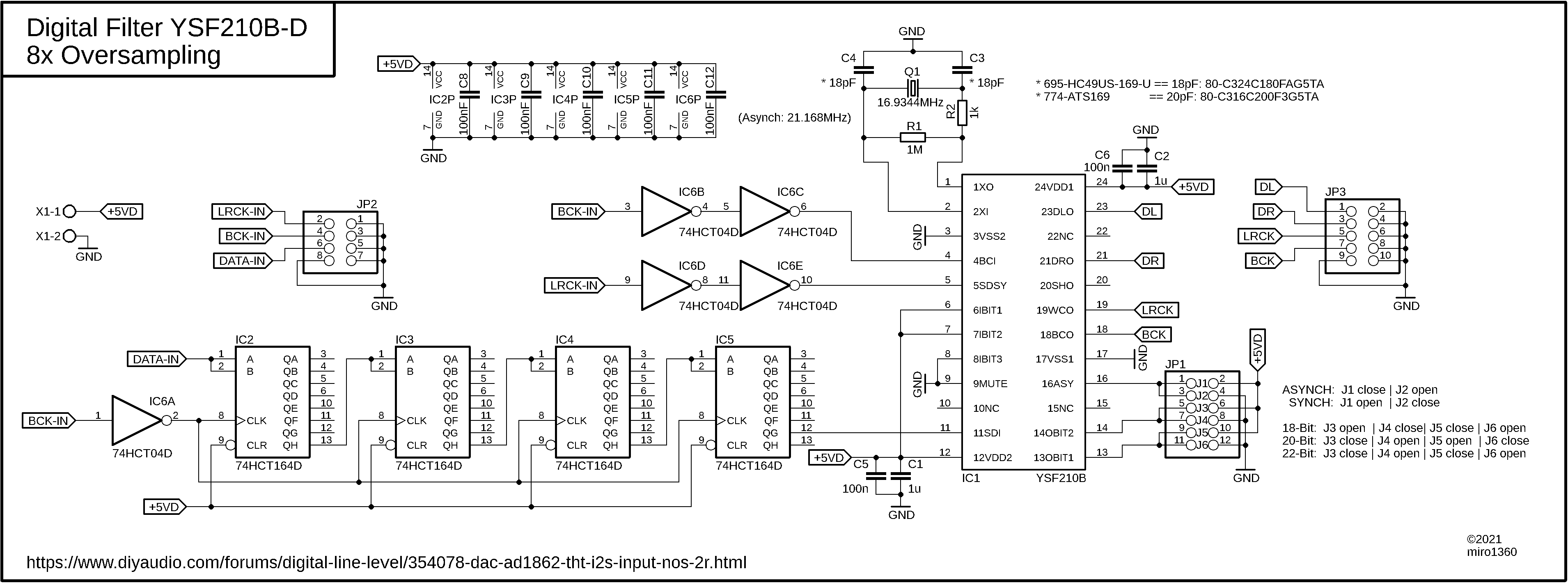

Digital Filter YSF210B-D (8x oversampling)
Here is a shot schematic for digital filter YSF210B-D.
I am almost sure it will gain zero interest, therefore no PCB.
I have ever read on the internet that it is close to the PMD-100 filter (maybe not so good, but better than the DF1704 waster :Ouch: ).
It supports the same sampling frequencies as the PMD-100 (only up to 48kHz).
I share the schematic - what if someone in the future will decide to test it on a breadboard for the good of the soul? 😀
(asynchronous mode should be selected with 21.168MHz clock :zombie:)

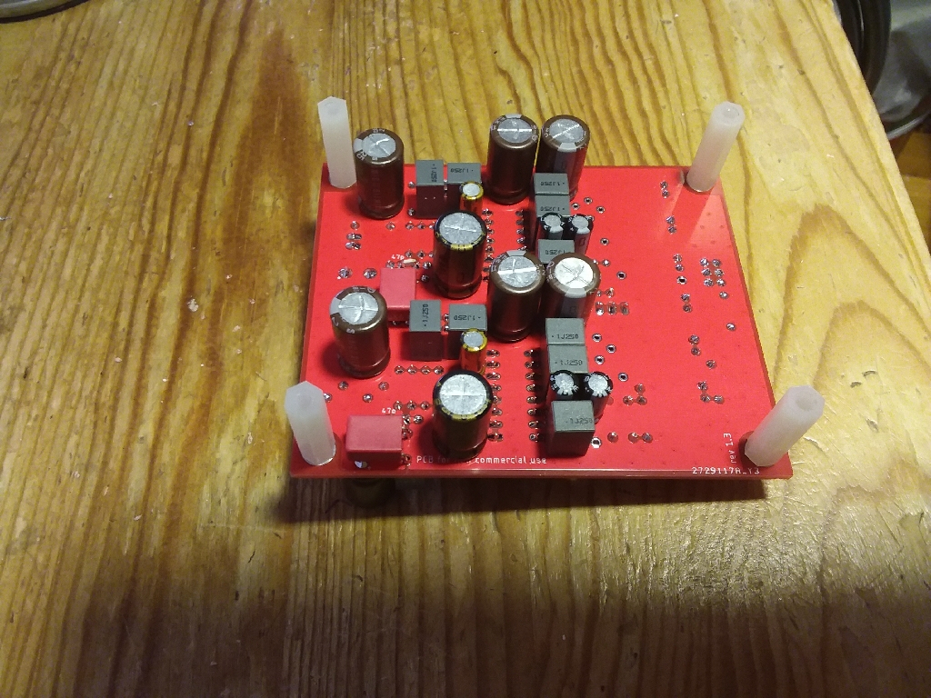

Hi all, I am pleased to report that my build has been finished. I'd like to thank Miro, Paddy Garcia, Markw4, BRN and all those that have helped me generously.😀
The Dac was built to Miro's specifications. It sounded nice but I felt the mid was a bit recessed, so I added some wima 1 uf capacitors in hope of providing more juices to the ICs, fully aware that this might cause the 0.1 uf caps to oscillate.
I also used 20 pf C0G caps instead of 47pf to accomodate AD797. But so far I like the sound of OPA1611A better than that of AD797. I have a pair of Sparkoslab ss3601 coming in. I wonder what would be the optimal capacitance value for ss3601? Would 20 pf do?

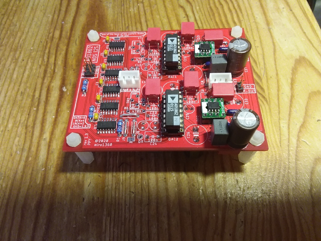

1. v1.3 is the most current tested version
... there is also the same alternative with uf.l connectors for I2S input data: #2180 (untested)
... or untested #2546 where the USB-I2S from jlsounds (I2SoverUSB) can be stacked (connected without wires) ... this version also contains uf.l connectors for PCM input data
2. this is the cheapest way how you can get any PCB: #2602
3. Paddy
Asilker; all is about your frontend choice, there are also pcbs for uf-l inputs or stacking some USB board : DAC AD1862: Almost THT, I2S input, NOS, R-2R

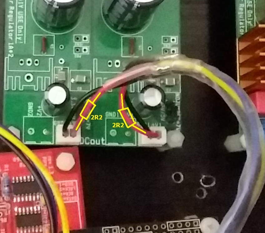

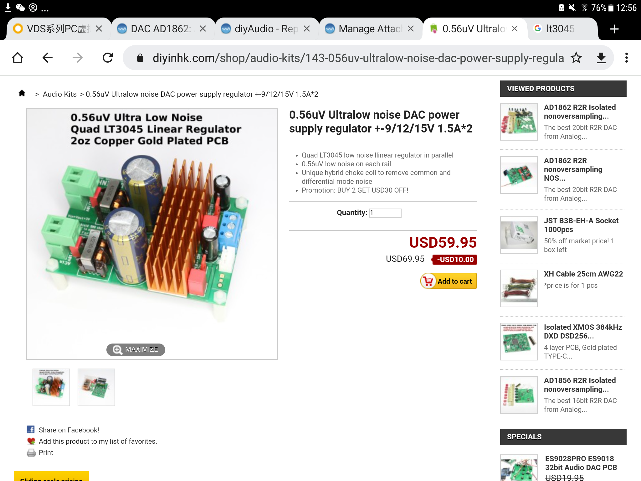

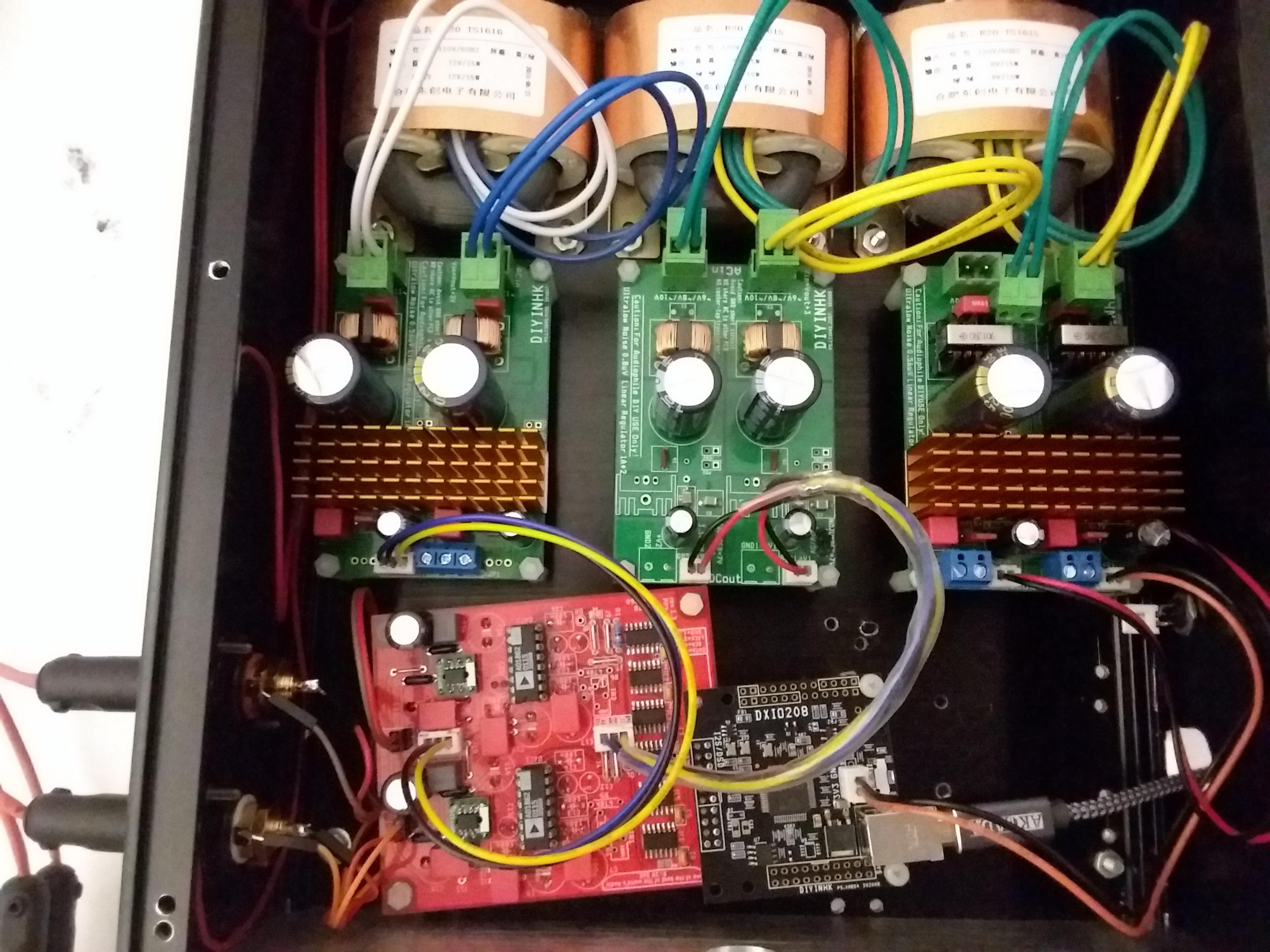

I am using diyinhk 0.56uv ultra low noise LT3045 linear regulators that can do at least 500 mA continuously.

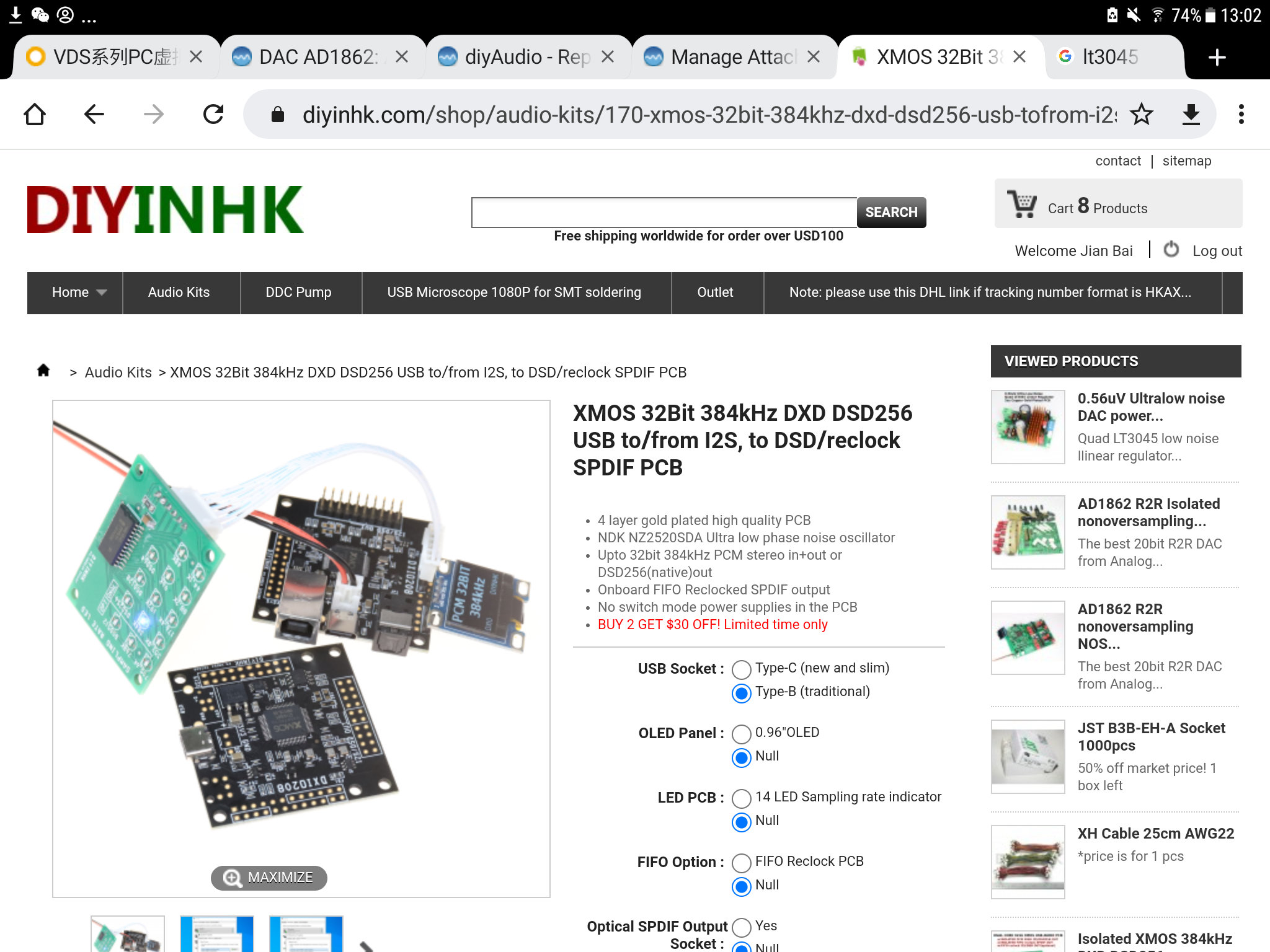

I am stacking a diyinhk XMOS 32Bit 384kHz DXD DSD256 USB to/from I2S board to the dac directly, since the pins are compatible.
Here is how it currently look in the case.
I have a pair of LM6171 soic. I will solder them onto adapters and hear how they sound.
Thank you🙂
You can try add 2R2 resistors on power rails :scratch2: It is very good prevention against PSU oscillation for these regulators. (The picture shows only +-5V, but do it also for +-12V PSU).
But first try the LM6171 in I/V 😉

Hi miro,
Thank you for suggesting LM6171!
I put in LM6171AIM and they sound beautiful! I was totally surprised. I tried LM6172 before with my diyinhk ad1862 dac and I wasn't much impressed. Now, theses LM6171s are certainly in the same league as the Sparkoslab ss3602 and the Muses01 that I have enjoyed so much with my other modded ad1862 dac.
