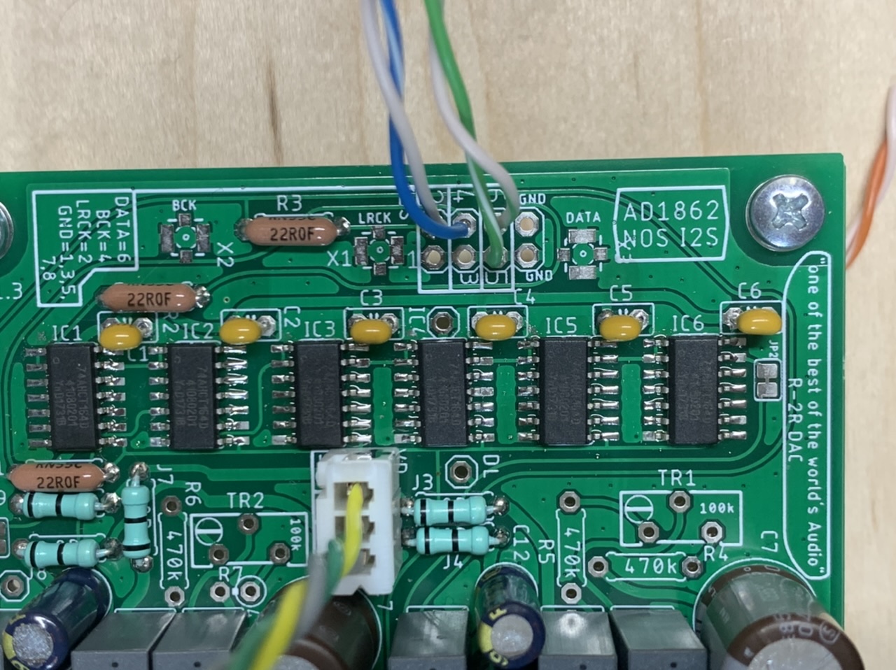

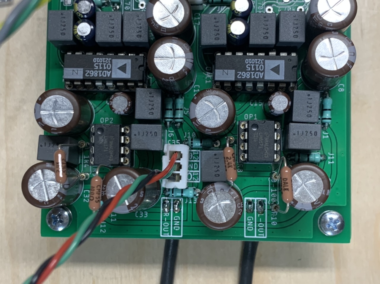

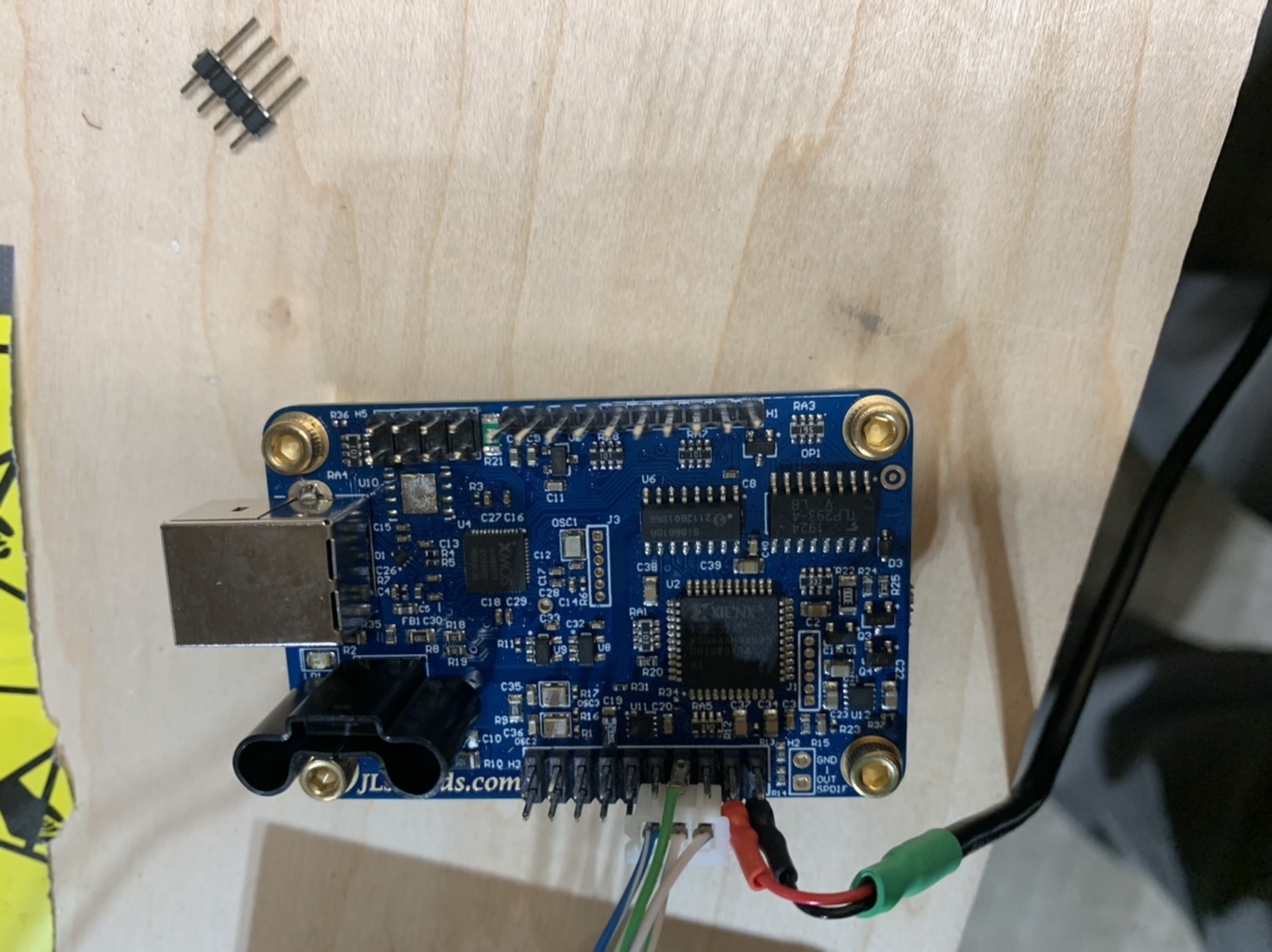

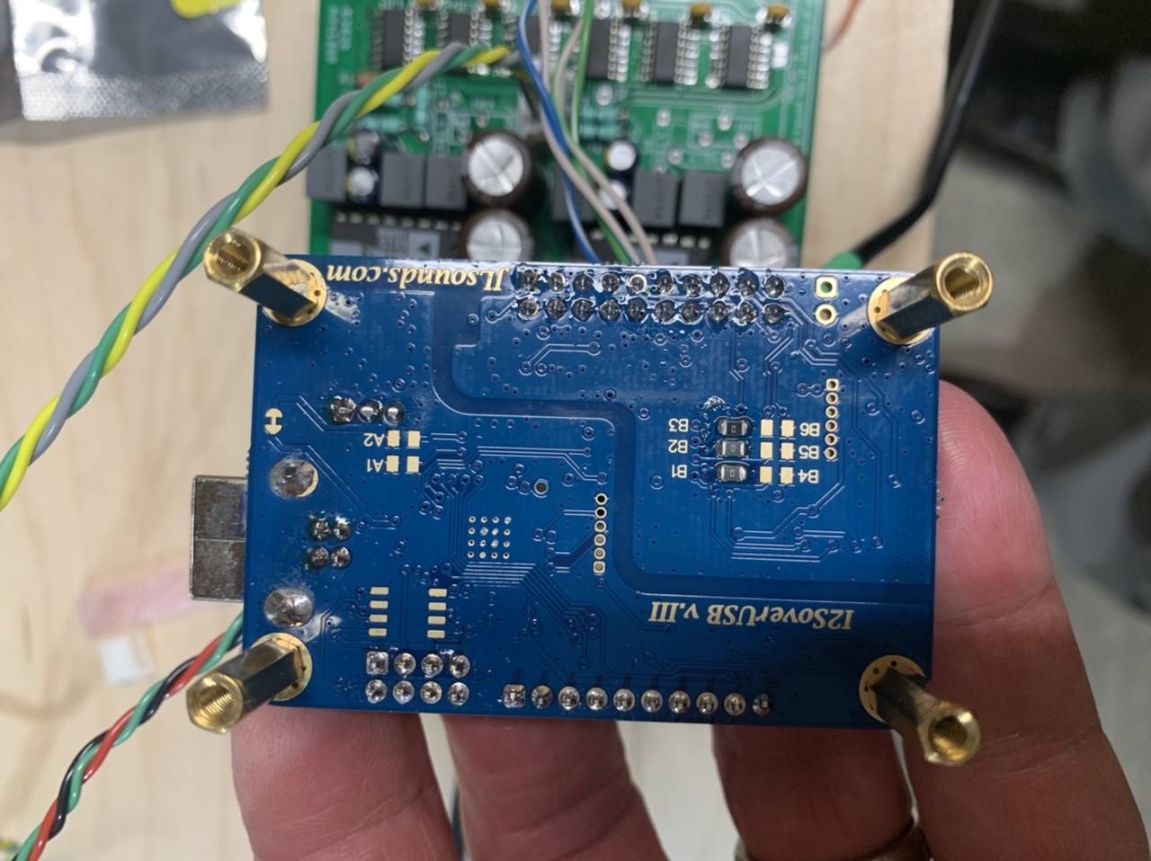

I finally got all the pieces and parts for my DAC, but I’m getting no sound. I’m using the I2SoverUSB v.III and have it configured like the description in post #617. I’m also powering the digital side with an external 5vdc source. I’m using the 1.3 if.l board with the 74AHCT164D shift registers. My source computer is a Raspberry PI 4B running Volumio, and the app sees the I2SoverUSB.
Any advice on troubleshooting would be very helpful.
Since I have extra boards, I’m thinking about building the DAC without the shift registers to see if I can get it working.

@BRN First make it working on your PC or laptop, then go with raspberry 🙂
The connection and jlsounds configuration seems be fine.
Bring it by and we can take a look on my scope. I've got some experience with errors on the shift registers...
Might try reflowing the solder on those chips, several pins look a little skimpy.

That could be the case. I have two options. One reflow the solder on the shift registers and build another board without them and reconfigure the I2SoverUSB to feed the AD1862 directly.
Thank you. Let me play with a little more and see if I can figure it out.
@BRN You can use the simplest probe for digital signals: LED diode with 1k resistor or a buzzer
Use this LED to see if BCK, LRCK, DR, DL are present on DAC pins while the music plays. DR or DL will shine only when the music is active, so be sure the music is on
You can trace pins and find the problem.
