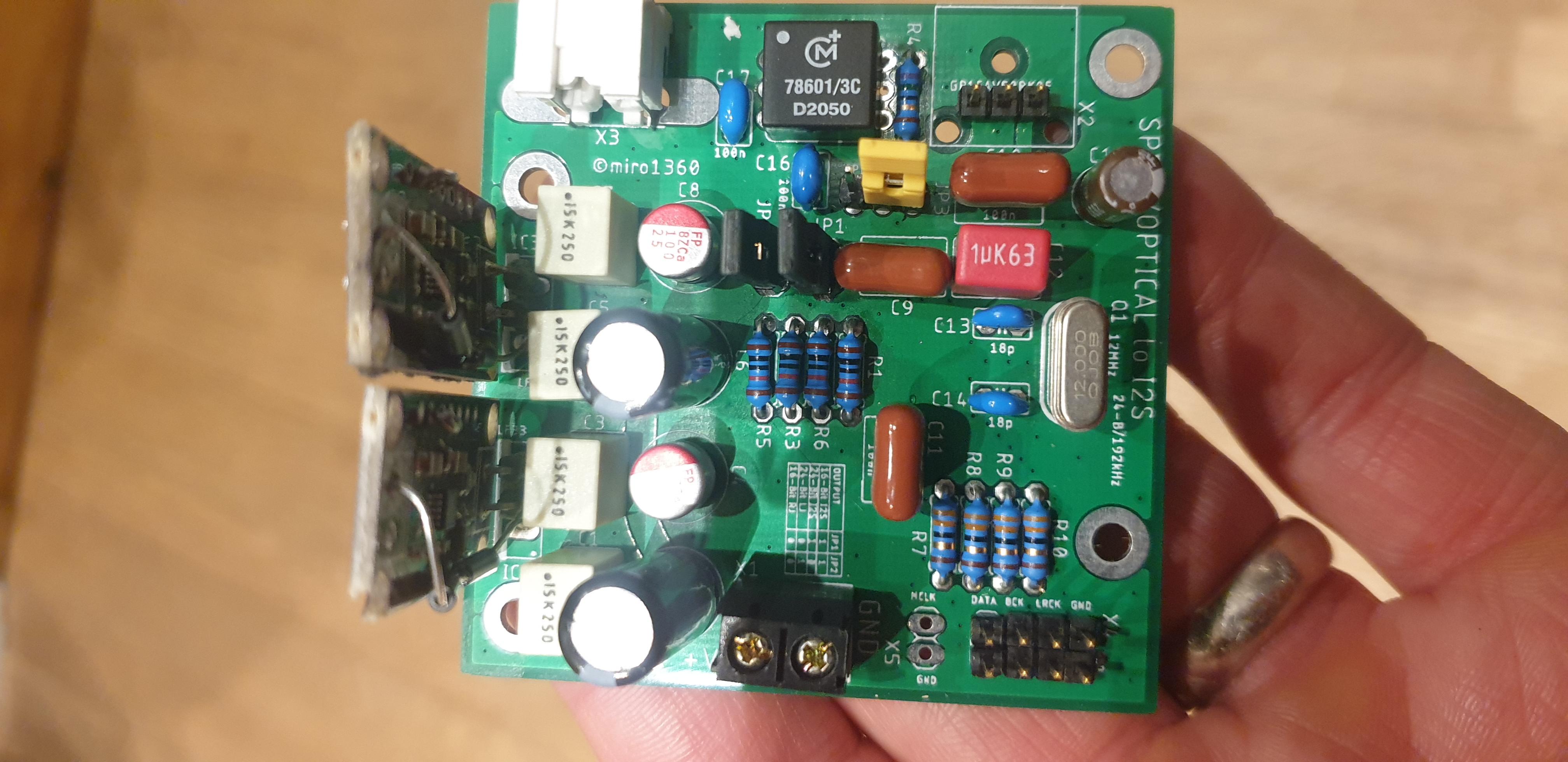

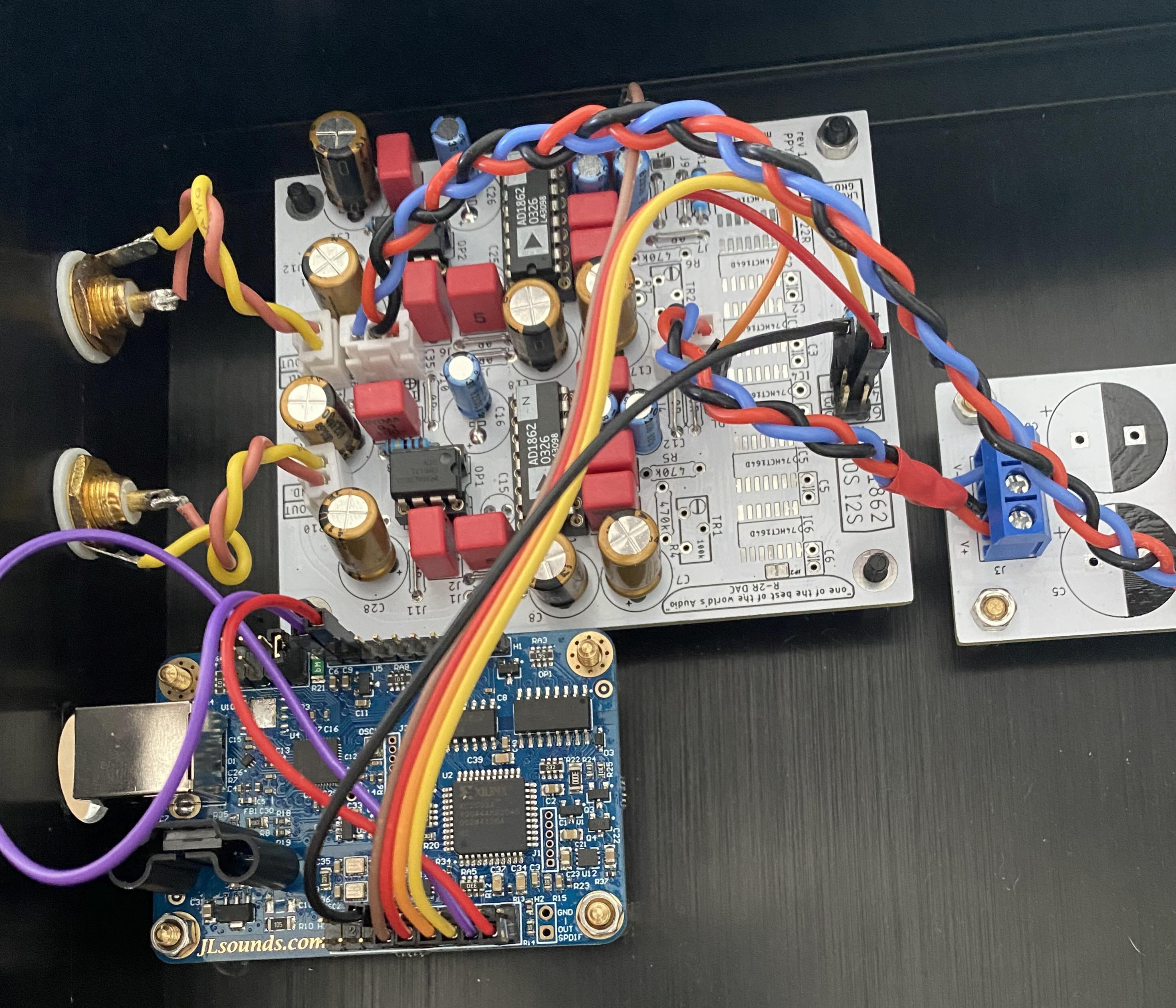

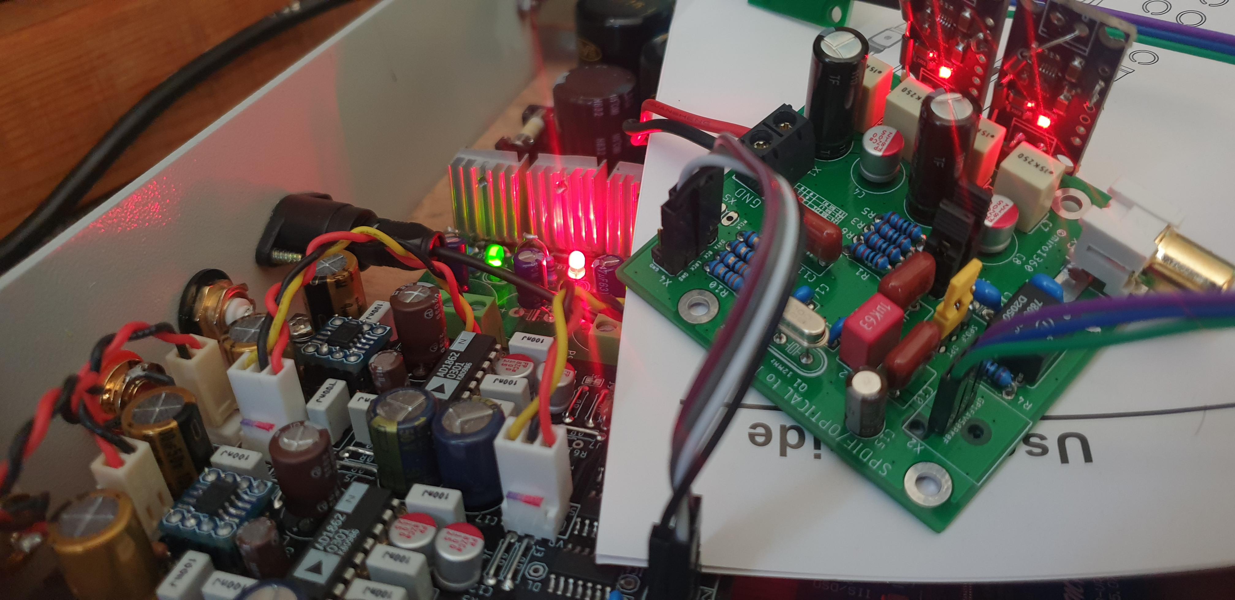

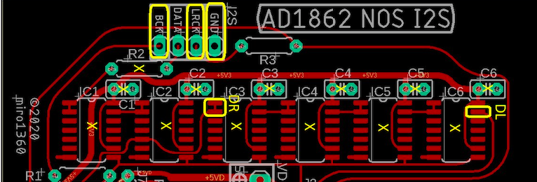

Just having a quick look at my populated boars and yes it is silkscreened wrong. DATA and LRCK need swapping .I hope to test the board in system tomorrow. I didn't have the optical receiver you specified at my time of testing and so used one from another build which is 3v3 so maybe that will work for me.
Picture added

@jimk04
Your post reminds me I was saying in my recent posr 1 week ago, that I would test a converter board using the DIR9001. I tested the board yesterday but 1st thing I noticed was, that indeed it's using the WM8804 so I cannot make a comment on possible difference in performance. Sorry.
Hey no worries!

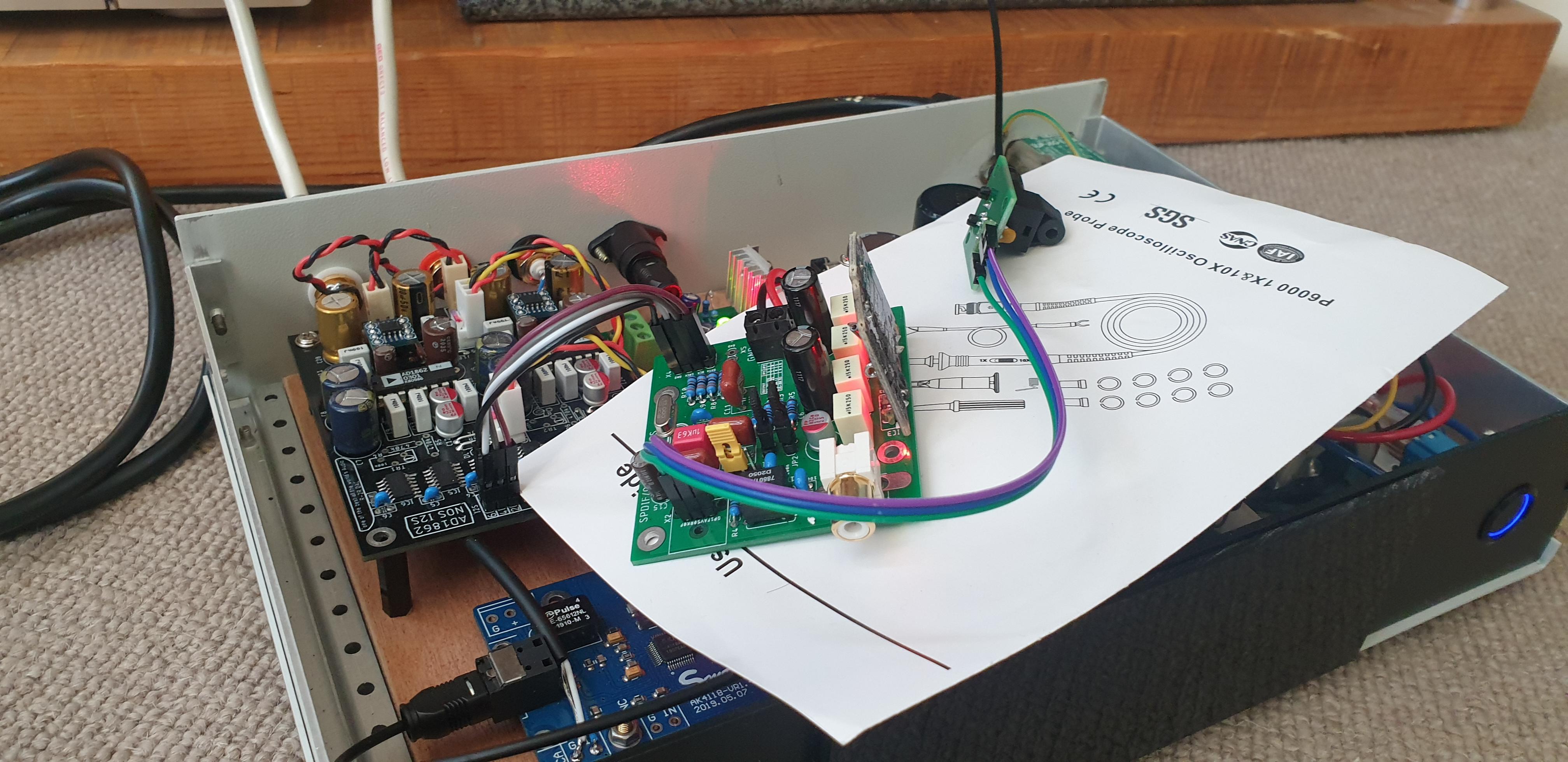

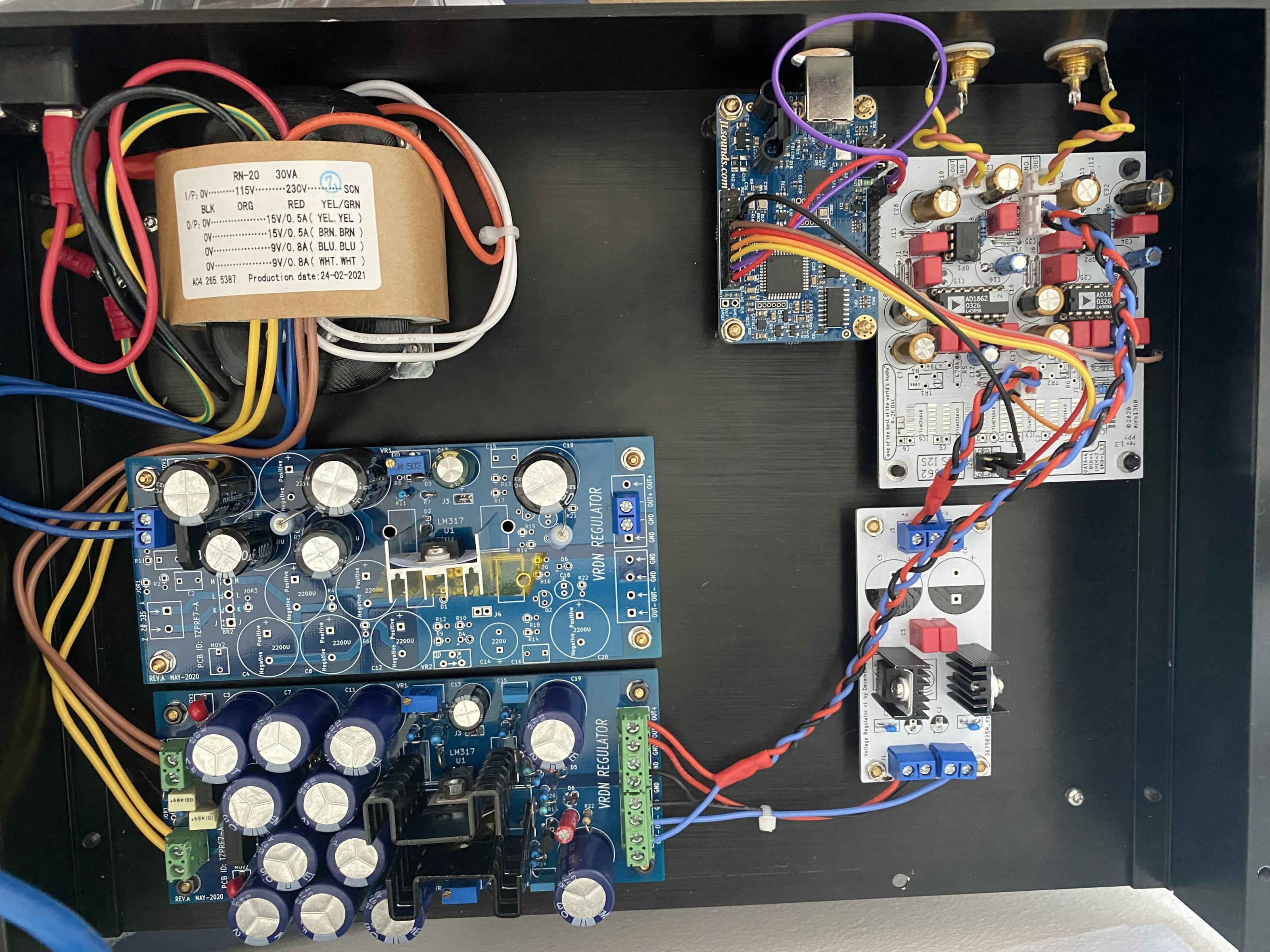

I swapped data and lrck.....woo hoo it works. 3v3 is fine for my DIYINHK optical receiver. Need to try coax at some point but this is sounding nice. Hopefully the polymer caps on the digital sections and the lt3042 were worth it! Shall think to use this spdif board now in another Miro build with the Euvl/Ripster output stage.
Shall try the opa1656 later
Thanks Miro for following up this design and fault finding

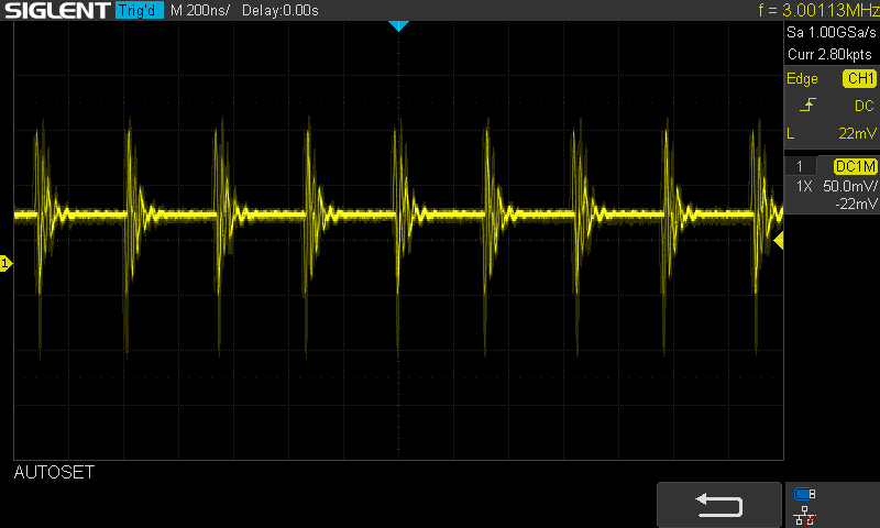

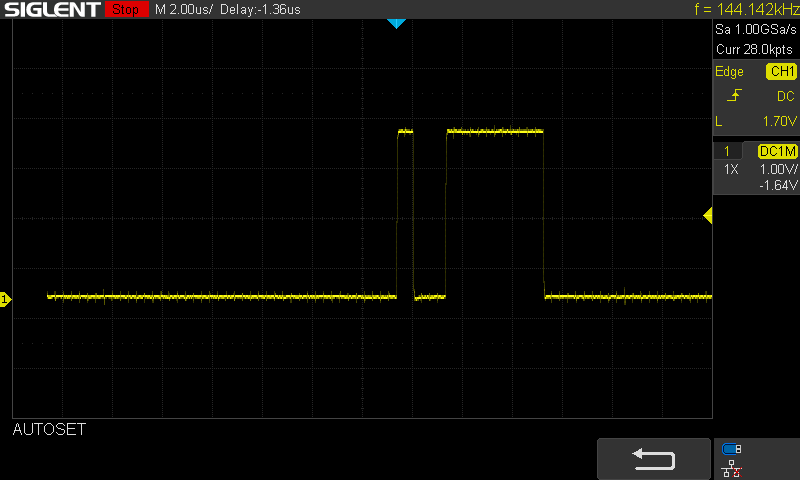

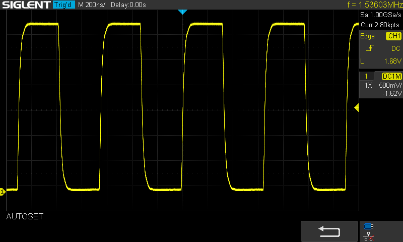

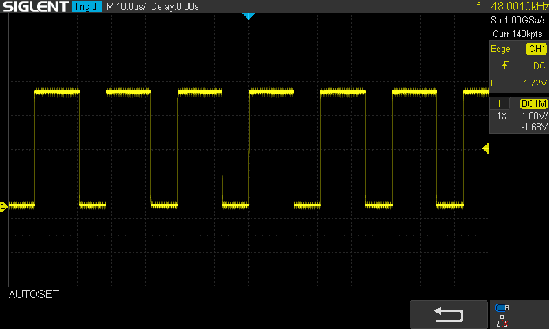

I have built two DAC boards. Unfortunately in both cases, I do not get any analog signal from AD1862 - just a small noise around 3Mhz frequency. I have got just 2 AD1862 chips from Paddy Garcia - I used the same chips in both boards. I connected directly (without shift registers) jlsounds board as per documentation and forum (4.7k resistor + J4 closed).
I attach oscilloscope outputs/inputs probed directly on the AD1862 legs with 1kHz test note being played.
Thanks for any suggestions.

Yes, the 4k7 resistor is there.
I just checked the application note for AD1862. It seems BCK should be 17MHz and LRCK 352.8 kHz. If this is correct, that would mean my jlsounds does not provide proper clock signals. Anyone can comment on those freqences please? Thanks.
