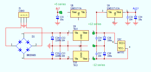

As others reported the most rewarding swap is for opamp rails and analog 5V (U8, U9 and U10)
But you still need U9 and U6 for the analog 3.3V (CS8416)
hi Dario,
could I have you advice once more. Do i really ned U9 if I have 3 separate salas regs attached to green points (att)?
So I built 80mA 5v version for analogue part to completely remove U8.
Another salas +-12v 200mA is built for two opamps - DAC's output and preamp (LM49720HA) that I'll put in the same box. I guess opams need no more than 50mA, salas requires some 30mA, so I still have about 50mA left to pass to U6 for A+3.3...😕
According CS8416 datasheet (Va3.3 is for it) it wouldn't need more than 10mA so it should be fine.

Interesting. On Dario's upgrade BOM, I see a heat sink for the positive 7812 regulator. It is mentioned as MANDATORY.
I ordered it (60 cents), but is it really necessary? If I need to install a heatsink the 7812 should be providing at least 250 mA.... My transformer can supply 500 mA, so that will not be the problem..... but why did Dario put a heatsink in the list?
I did'nt find heatsinking the 7812 necessary even with discrete opamps and their greater current draw but it does'nt hurt to use one.
It depends, the DAC works perfectly without it but the 7812 became really hot.
For long term reliability I suggest to use it.
To know how much heat is being dissipated on the regulator, measure the current that goes through it. Then multiply it by the in/out voltage difference.
That should give you a watt number, which should be less than that specified on the data sheet for no-heatsink operation.
But as Dario says, if the 7812 gets hot you will need a heatsink. Have you put your finger to it on several occasions to see how hot it is?
That will also depend on how many volts are going in on your specific place and on Dario's, which may vary from country to country or city to city.
