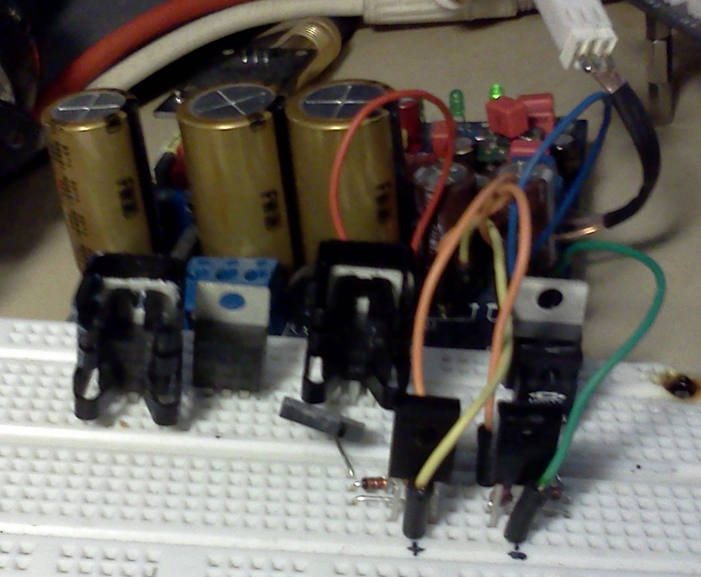

* On the PCB I see some very small holes, and no marking on them. Are that VIA's to the other plane (bottom / top)
Yes, they're vias.

If I power up the board (still a problem there maybe) without the SPDIF plugged in I get three lights, 96K, error, power, I plug in the SPDIF the 96K light goes out. I spool up the CD and the error light flickers while the disk is reading and goes out when a track starts to play. If I power up the board with the SPDIF plugged in I get two lights, error, power. I have never seen the no audio light lit up (a real wind-up... since I have no audio!).
This weekend I plan to hunt through my salvaged transformer box and find one or two I can try in place of the transformer supplied with my kit.
See if that makes any difference...
I haven't given up yet!
Bill

I did try two CD players (both home brewed shigaclones admittedly), both are working in the same set up if I just switch the DAC (all other factors equal).
Anyway I just measured 61 ohms resistance across the primary winding of the transformer. This seems way too high(?) so I will go ahead and try to find a different transformer(s)....
Just for reference sake has anyone measured the resistance of the primary and secondaries in a good example of the r-core transformer sometimes supplied with this kit? I see 1.1 ohms across the 9V secondaries and 3.1 across the 15V secondaries.
Thanks folks.
Bill
Hi Bill,
I do not have the r-core from China, but the amounts you tell should be real. The 61 ohms are way wrong.
The primary winding should be "high" (a couple of kOhms), when not loaded. The secondary are usually very low (thick wire, and few windings).
Take ANY transformer, either toroidal or normal block. Measure it there.... The higher the power of the transformer, the lower the secondary winding resistance. The lower the secondary voltage, the less resistance.

I ordered the kit including the transformer.
These are the values that I just measured;
Prim: 0--115V= 38,8 Ohm 0--230V=124,9 Ohm
Sec: 0--9V= 5,4 Ohm 0--15V= 8,4 Ohm
Haven't tested the transformer though.

Thanks for checking. Seems your secondaries have much higher resistance than mine.... I'm trying to do some study about transformers... seems pretty endless!
Bill
Bill have you tried using only the 12-0-12 inputs with the solder bridge?
It seems like there is a problem with your 9v windings, or try feeding it with a wall wart. The 9volt winding needs to be powered on first, else the AK will miss its reset point.
