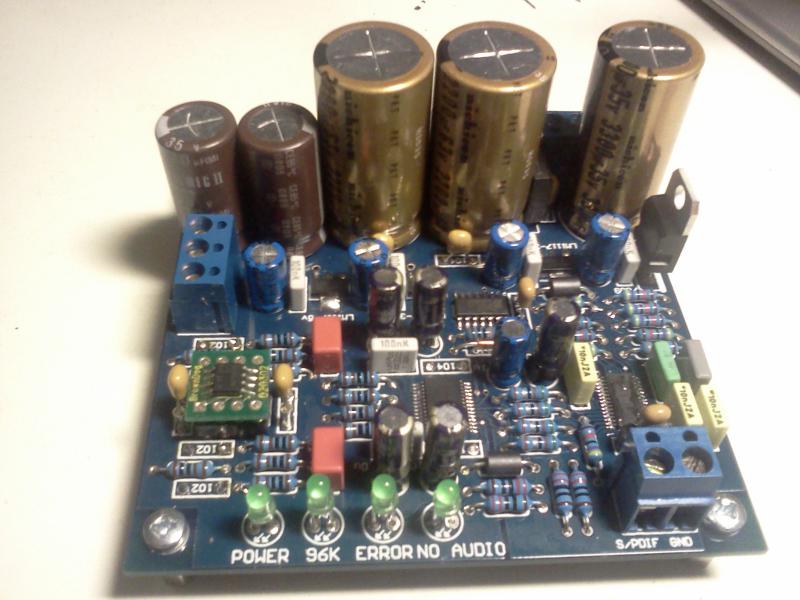

Today in the mailbox I've found a small packet with an R-Core transformer and an assembled nice blue AK4396 DAC...
I must wait this night to test it but I've managed to check my previous work and found some errors...
Attached are the updated PCB paths and possible BOM for updates
The BOM includes Erin suggestions (Erin can you check it?)

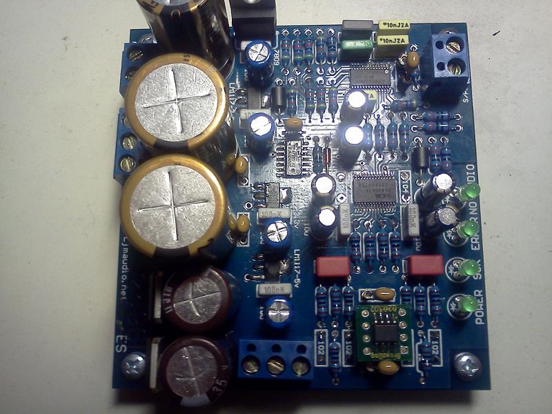

Clave- Call me thikko, but the picture with the coloured lines on it - what is it exactly you're proposing/implying with that ?
Hi Andy,
On the PCB there's no correlation to components numbering present on the schematic.
I've done some 'reverse-engineering' to put on the pic the same numbering system to identify the various components.
Since I trust that according to function some components are better than others this work was essential to me for planning mods.
Colors helps identifying different power and signal traces on the PCB.
Pwr supply advice (as per AKM design spec sheet)
Quote : "...Power lines of AVDD and DVDD should be distributed separately from the point with low impedance regulator etc.."
Hope this helps !

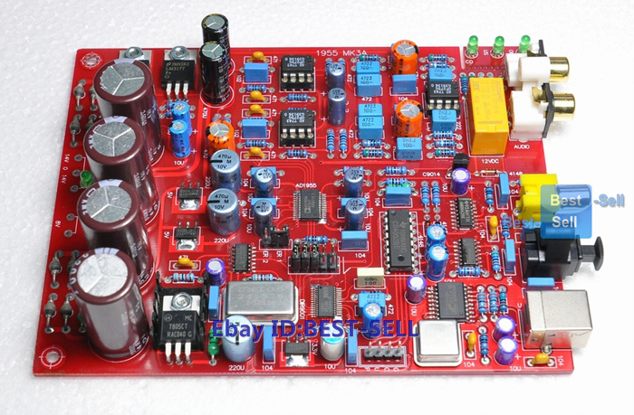

Is there a link to this ebay seller?
Link...
Here you go -
Full Assembled DIR9001 AD1955 (MK3A) DAC Decoder Board on eBay (end time 21-Jun-11 06:49:12 BST)
Have fun !

So far I've changed the following things:
Smothing caps
Nichicon FW 3300 uF 35V for digital PSU
Nichicon FW 2200 uF 63V for Analog PSU
Bypass unchanged (100nF X7R Ceramic)
Analog post regulators
Elna Silmic II 220uF 35V - Bypass Evox-Rifa SMR 100nF 50V (Post L7x012)
BC 038 47uF 63V - bypass Evox-Rifa SMR 100nF 50V (Post LM1117)
Digital regulator
BC 038 100uF 50V - bypass Evox-Rifa SMR 100nF 50V (Post L7809)
BC 038 47uf 63V - bypass Evox-Rifa SMR 100nF 50V (Post LM117)
LPF and I/V Conversion
Wima FKP2 1000pF
Wima FKP2 3300pF
I've also mounted sockets for all other electrolytics .
What has changed?
A lot, much more refined, wider and deeper soundstage, stronger and more controlled bass, dynamics.
The most valuable change is the use of Wima FKP2s around the opamp and the opamp itself (NE5532, OP275, OPA2132, OPA211, OPA627, OPA827 in order of good sound )
It makes a lot of difference, others changes I've made are audible but more subtle.
