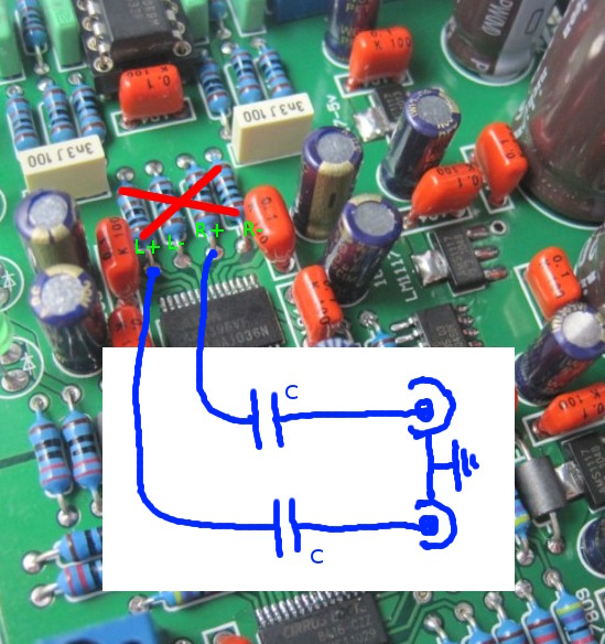

Since that AK4393/6 dacs are analog balanced signal out dacs, I suggest you to trial avoiding analog/opamp section with tapping analog L/R channels directly from pins. You have to add dc blocking cap if you will tap unbalanced signal from + pins and analog ground.
Blocking cap type and value can be determined during tests. I think 2.7 uF or greater would fit. You have to tap analog ground somewhere close to dac chip.

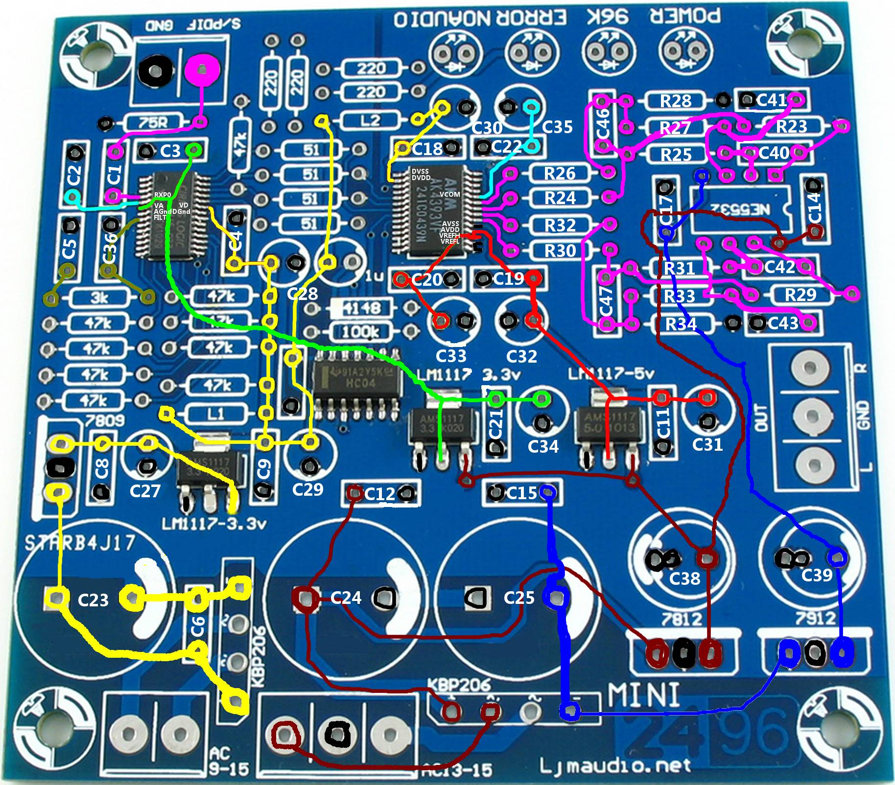

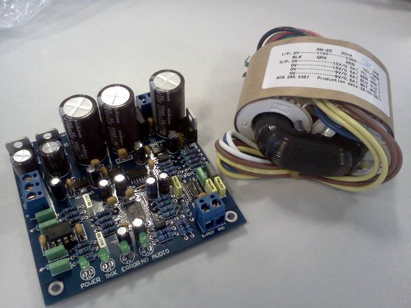

It finally arrived!
Today in the mailbox I've found a small packet with an R-Core transformer and an assembled nice blue AK4396 DAC...
I must wait this night to test it but I've managed to check my previous work and found some errors...
Attached are the updated PCB paths and possible BOM for updates
The BOM includes Erin suggestions (Erin can you check it?)

Clave, good work!
There are one or two variations. However I don't see any need to make corrections as its a rough guide. Hopefully others will experiment to get a sound they like.
It's highly likely building the kit using my suggested parts will yield a very smooth sound which may be too smooth for some peoples tastes.
Let me know what you think of the sound when you get around to it.
