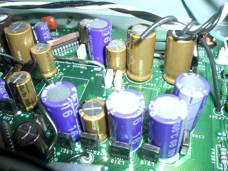

I then tried Oscon 47uf in C32 and C33, and it was too bright, not enough bass and a bit normal and boring sounding.
I then went back to 470uF oscon SEPC and found the very nice sound again.
Exactly what I've experienced with SCs/SAs, it could be that SEPC are better.
If they were still in production BlackGates woudl be perfect, probably; Cerafines are good substitutes.
C32 (Analog supply) and C33 (VRef) are different, probably C33 can be as low as 10uF-47uF but C32 should be bigger, i thought 47-100uF would be enough but probably 100-220uF is better.
Also for C33 noise performance is critical, C32 gives 'tone' so better audiograde.
I have not yet tried changing the Vref capacitor. Because, to be honest 470uF sounds very good.
I can try a 47uf or 33uf oscon here. I don't have any 10uf oscons.
Do you mean VCom?
Here I would try a Cerafine.
I might just add that I also bypass this 470uf Oscon with 220nf PPS capacitor.
Bypassing makes all the difference with much smoother HF and a more rich sounding midrange.
Too me this sounds as a audiograde cap is needed...
Btw for now all these could be speculations... I will report when dac arrives.

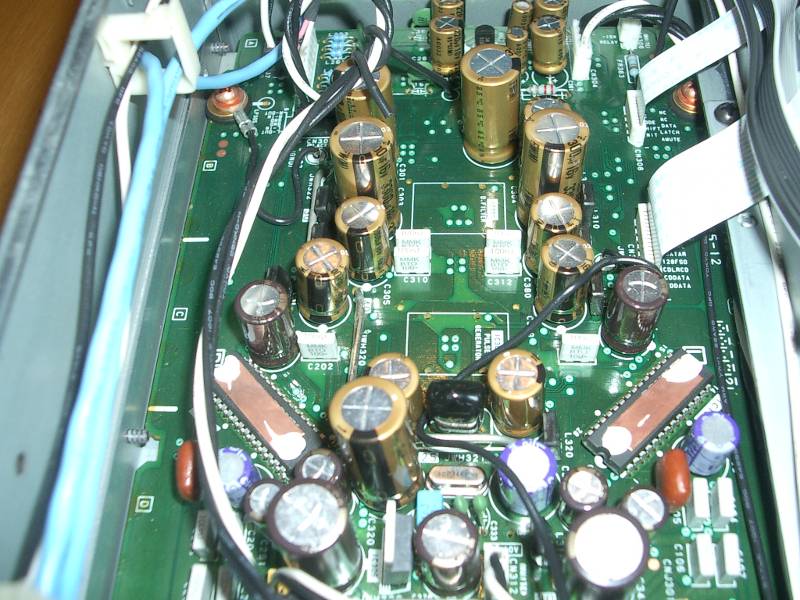

Attached are three shoots from my SACD player: before, tried Oscons, after (only Vref Oscons survived)
