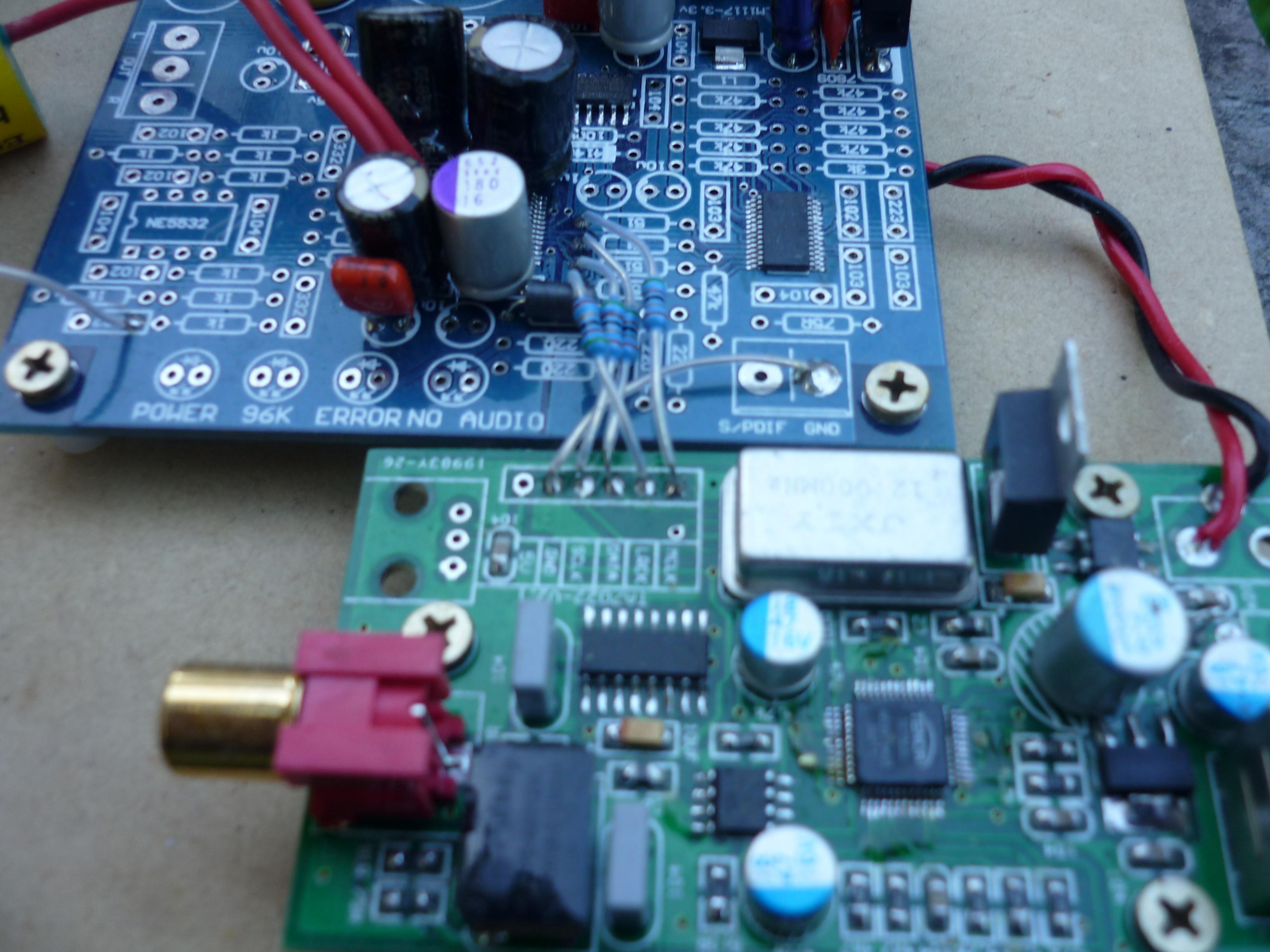

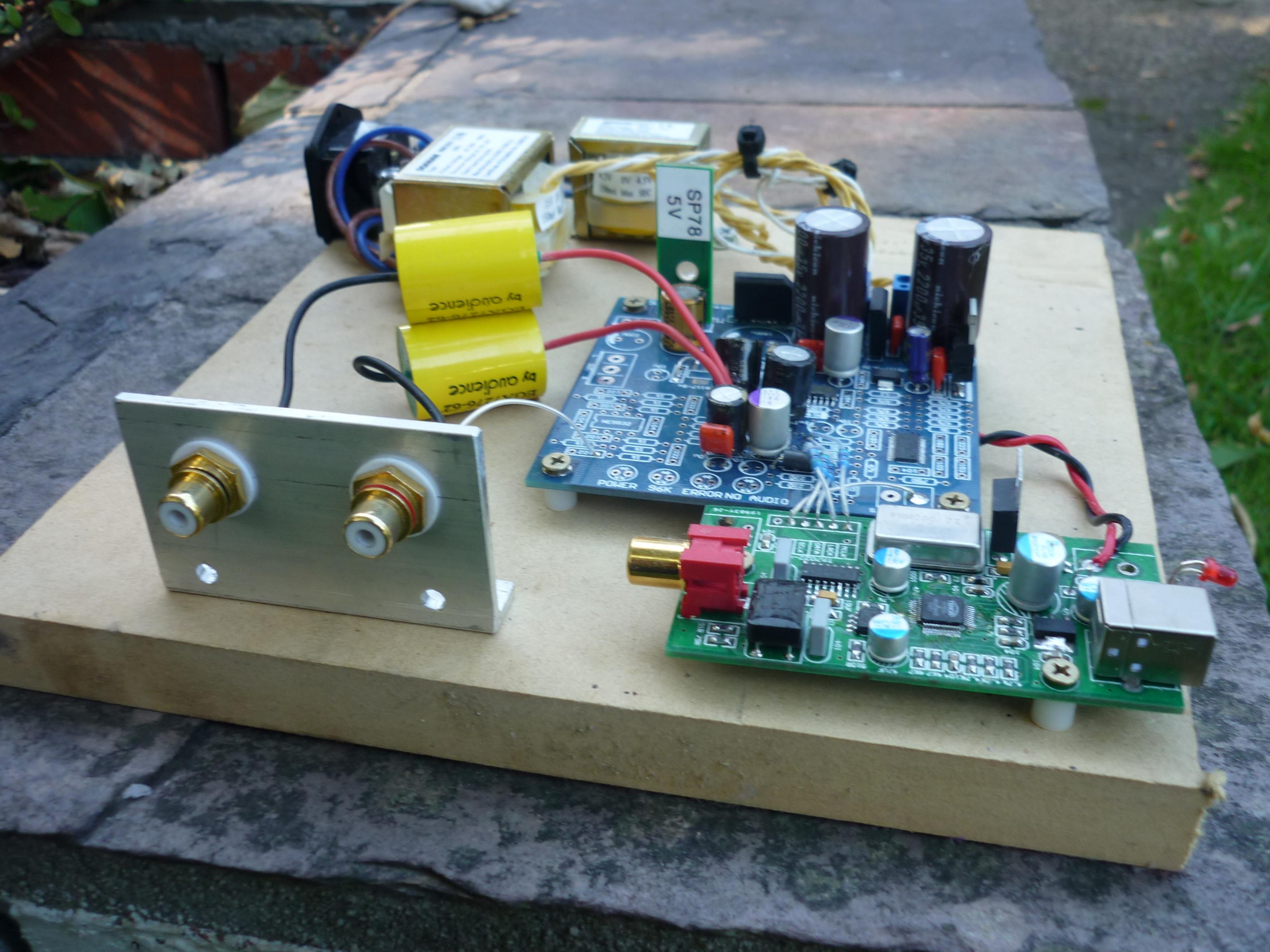

I2S

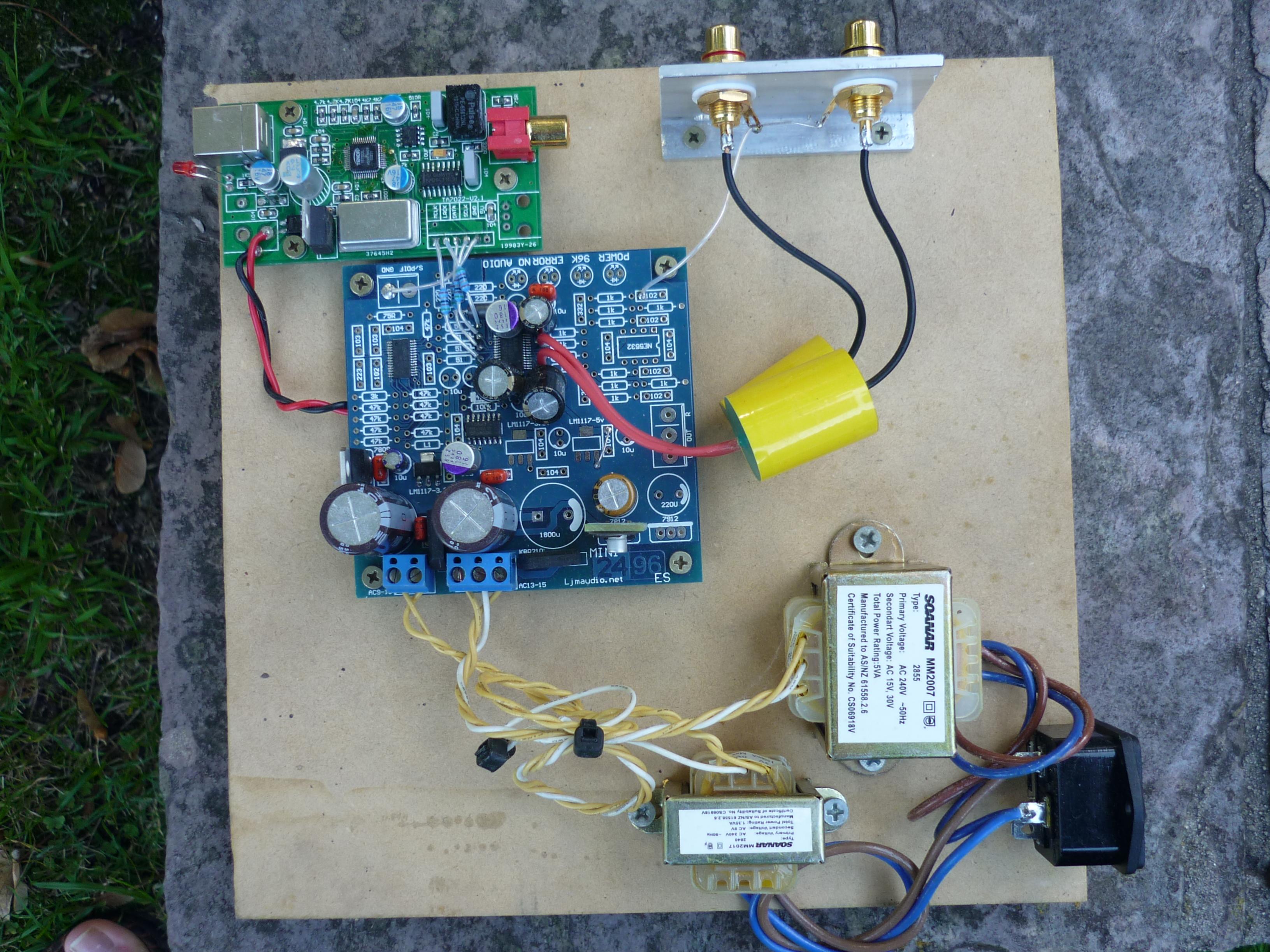

The Pictures show how the wiring has been done
This then feeds a DIY Aleph Preamp followed by PSE 6CA7(Triode Connected) monoblocks and Goodmans 201 Open Baffle Speakers
Using the DAC in this way and using a PC as a source has provided a source that leaves my Esoteric transport and Wadia DAC in storage.
A PC using USB DAC is a VERY effective source.
I don't know why CD material sounds better from the hard drive but it does.
Using programs like Foobar, upsampling can easily done.
This is the reason that the I2S can be kept short and still provide a great source to the rest of the system

Which specific converter USB/I2S (eBay?) are you using? Any photos available?
How is it wired at the output? Just cap or cap + resistor? Where does it go to from there: preamp, volume pot, power amp?
Very interesting approach, Mark. Both on input and output. And regulators, of course.

Very nice arrangement. Very well executed. Congratulations.
Some questions:
1) What regulator is that your using for 5v? Burson?
2) Shouldn't you load the output with a resistor too? If it's there I can't see it.
I'm considering the Teleporter option for I2S interface too.

I2S
The Regulator is a Belleson Super regulator
There is no resister but there probably should be
The DAC has been running for about 3 months without it.
I have some spare Kiwame 1200 ohm resisters so these might get a try.
