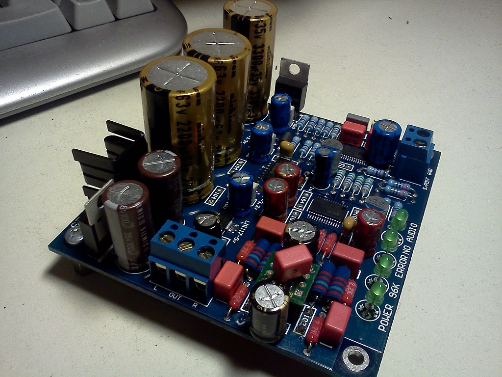

Dario, could you post a straight top down picture of your current populated board?
I'm not sure if the picture at your Google docs page represents your latest PCB population.
The pic in Google Docs (also attached to this post) represent exactly what is recommended on BOM.
The only tiny difference is that Cerafines around the AK4396 are NOS (red sleeve, they sound slightly fuller).
The actual DAC has two 47uF Black Gate PK instead of Cerafines on opamp decoupling.
Am I correct, C23 is 3300uF/35V and not 2200uF/63V as in the BOM.
You're right... I forgot it, sorry.
In fact the 3300uf 35V fits better but I've used that simply because I've had it at hand.
