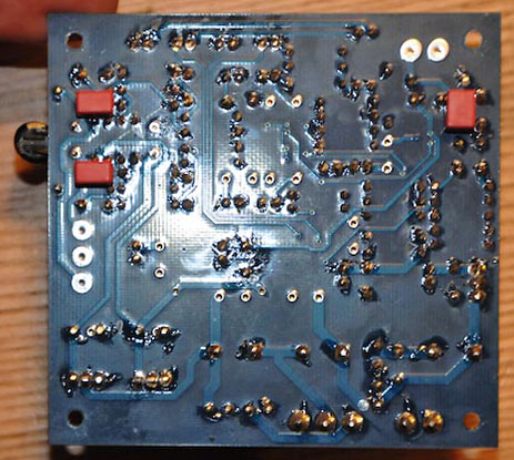

billo44, Could you post a picture of the other side of your build? I have not started the upgrades yet and that would be helpful.
Thanks.
Thanks.
You should populate that position with the original ceramic (100nF X7R)
Thanks Dario.
Here is the other side of the board.

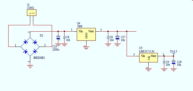

I am not sure I made the right choice for C27 either...
I used a BC 100uF 50v.
I haven't powered up this DAC yet so please don't anyone trust my build photo until it's proven... or approved as a guide by someone who knows what they are doing.
Maybe it's not optimal but it will not harm either... 😉
A reason might be, that the absolute maximum input voltage of the LM1117 is 20V DC. If you use a 9-12V AC transformer, when unloaded the voltage at the transformer can go 20% higher. And after rectifying it will be multiplied by 1.41. So it might very easy reach the 20V. The 7809 series can go up to 32V input.
