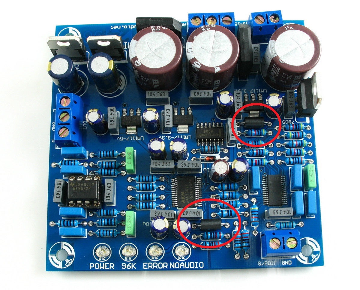

Hi! SaftLasso and I recently builton of these DACs (with the 4396 chip) each, but mine has a problem. It works completely fine at up to 48kHz (or 44.1, I'm not sure), but at anythin higher than that the "error" LED starts flashing like nothing else and all you can hear is a really loud sparkling sound. Also, though the audio works at 48kHz, the "audio" LED doesn't light up. When I put the DAC to more than 48kHz it starts flashing at the same rate as the "error" LED. What could it be and how can I fix this problem?

Hello, those are ferrite beads. They act as a small choke (of 1/2 turn) and are intended to decouple the S/PDIF receiver/interface and the AKM DAC from the 3.3V power supply rail. In other words, they isolate the high frequency disturbances on one IC to another.

Did wire the S/PDIF input with care ? I mean: did you pay attention to keep the connection wires close to 75 Ohms ? This includes cabling from the player to an RCA connector (I suppose) and also from this RCA connector to the contacts on the DAC board. At higher data rates, the importance of this increases. So use coax, and with 75 Ohm impedance whenever possible.
A note too: you may have misunderstood the "audio LED" - it should not turn on when audio is OK, because in fact this LED means "No Audio".
