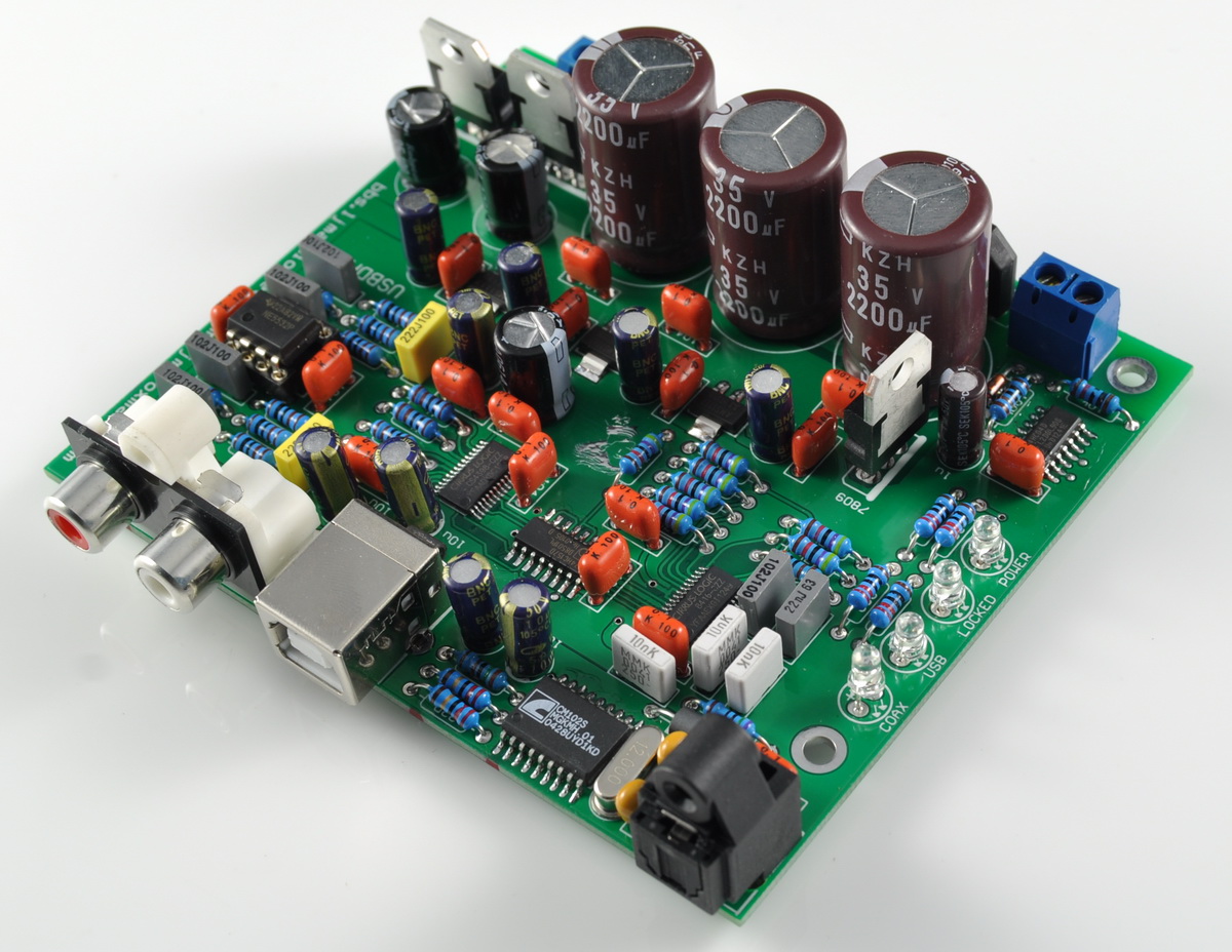

Hi all,
After trying for several months to get my DAC working, I finally decided to ask for help.
A while ago I bought the well known CS8416 + AK4396 + NE5532 2496 DAC Kit 24BIT 192K from Ebay. After soldering all parts it did not work. That is, there is a crackling sound from the speakers. I've tried several spdif cources (squeezebox, cd player, another squeezebox) but all with the same result. I also checked all DC voltages, they are fine.
After a while I figured I must have had bad luck (defective IC?) and decided to simply buy another one. To my big surprise, the second one (bought from another reseller) has the exact same issue.
In the mean time I had sent the first one back to china to have it checked, it was found OK by the manufacturer and returned to me after 2 months. However still not working..
All leds are lit, the audio LED is flickering. I tried different sample rates, all with the same result: some crackling from the speakers.
Any idea what might be wrong and how I can go on troubleshooting? I do have a scope. I find it very strange that both DACs have the exact same issue and I am hoping it might be something very simple I am overlooking.

You need to check the datasheet (or schematic) and check the signals present on the i2s data lines from the digital receiver whilst a source is playing. ( using your scope)
If all data is as expected then check analog signals from the output pins of the ak4396.
There are only a few possible faults. 1) receiver chip. 2) dac chip. 3) op amps. 4) bad solder joint somewhere.
What you need to do is what technicians call tracing the circuit. Meaning go through things in a logical manner. Check for correct voltages on the pins of each chip. Then check data signals. If you do this you will find and fix the fault.
Also check the incoming spdif signal on the pin of the receiver chip.
Are you using a normal coaxial 75 ohm spdif cable?

Thanks Erin,
Yes I do use coaxial 75 ohm spdif cable, swapped it with another one as well, both work on other dac's.
Ruled out the opamps already, using a sinus 44,1 kHz 16 bits as input, no sinus at opamp input pins.
Spdif looks normal on scope. Checked already for bad solder joints as well.
Main issue for me is that pins of dac chip and spdif receiver are too small to measure on without short circuiting.

hi tingtong5,
Find a cap or resistor on the track that a pin is on ,measure there.
Remember 4 things Power- Gnd- input(signal data,ect)- output(signal data,ect)

Thanks nosmoking!
I used a magnifier and I was suprised how well I was able to measure after all.
However, then I found out the tweeter of one of my speakers died, so now I have some other prioriteit.. :-(

Speaker has been repaired 🙂
Today I measured the DAC while playing 1 kHz sinus (16 bit 44.1 kHz):
CS8416
pin 24 MCLK : 24 MHz clock present
pin 26 SDOUT: data present
pin 27 OSCLK: 6 MHz clock present
pin 28 OLRCK: 21 kHz clock present , is this frequency (0.5 fs) correct?
AK4396:
pin 3 MCLK: 24 MHz clock present
pin 5 BICK: 6 MHz clock present
pin 6 SDATA: data present
pin 7: LRCK: 95 kHz clock present, is this normal??? Its 4-5 times higher then LRCK on CS8416
Then the really weird thing:
AK4396 pin 20,21,22,23 1 kHz sinus present!! However not all the time, when taking samples, sometimes I see a sinus, sometimes part of a sinus with either some rubbish or DC before or after it.
Any ideas what might be wrong?

The 95 kHz on pin 7 of of AK4396 must be 96 kHz of course. Also I remeasured pin 28 of 8416, its 96 kHz as well.
I forgot that my media player I am using is upsampling the red book files to 24 bits 96 kHz , so the measured 96 kHz is normal.
So, there is a analog sinus of 1kHz at the analog outputs of the AK4396, just not all the time..
I like to mention again that I have 2 of these dac's , they both behave exactly the same.

Therefore I had a look (should have started there 😛 ) at incoming spdif signal, it looks very bad. When disconnecting from DAC it looks neat and fine. So I will focus on this first now.
Both DACs are working fine now 🙂
After using a different RCA contra connector spdig signal looks fine and DAC is working. All these months the defective part was the RCA connector, the only thing I never swapped... 😱
