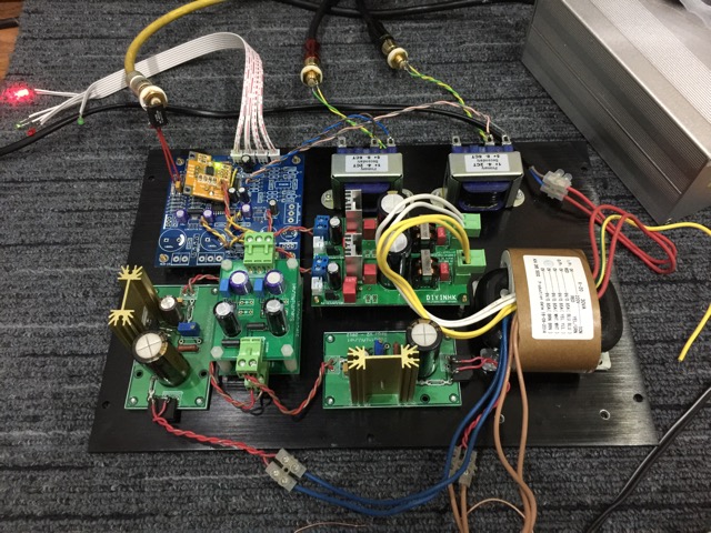

This is my DAC based on the core board as used by the other members here but the power supplies are totally different. I also use a transformer for digital input. digital signal is upsampling to 192 khz using CS8421. The output stage is a minimalist style which includes only a pair of 1:1 transformers.
The power supplies include:
a R core transformer with 4 separate secondary windings;
two LT3042 (ultra low noise 0.8uV) one opwering the upsampling board and the other powering the analog section of the ak4396 chip
two LT1962 for preregulator and three LT1762 after them.
Are these overkill? 😀

Hi , i have a r core transformer like that , how do you know wish of the yellow and brown wires are the start of the secondary windings ?
I think it doesn't matter because they are all independent windings. This matters only if you connect two or more windings together for parallel operation or to make a dual power supply.Hi , i have a r core transformer like that , how do you know wish of the yellow and brown wires are the start of the secondary windings ?
I need 15v-0v-15v
you may try this Identifying The Primary And Secondary Phasor Polarities Of Transformer ? Polarity Test | EEP
I need 15v-0v-15v
Join one of the yellow to one of the brown, then measure the ac voltage accross the ones you haven't joined - should equal 30v. if it doesn't, change one of the ones you have to joined to the other one and measure again.
