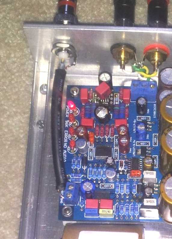

ok, so i've completed the board according to BOM (my first ever diy electronic project, so i'll be amazed if it works).

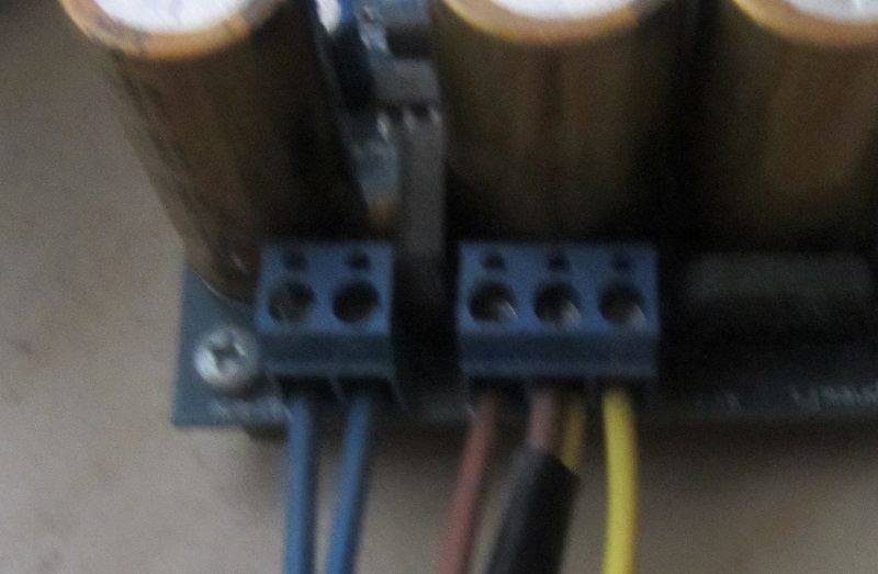

i have the R-type transformer but there's no ground - only on the mains side. i only have 0-9V black, black; 0-9Vwhite, white; 0-15V yellow, yellow and 0-15V green, green
1. does the ground on the board get left unpopulated or connected to the chassis or something else?
2. of the coax cable, which should be connected to the gnd, the interior piece of wire or the surrounding wire?

You have to create the ground from secondaries...
cool, thanks. it looks from bcmbob's pic that gnd on the coax is the interior single wire, but it's not too clear. is this right? sorry about all this.
would a phono/RCA socket be the same as a digital coax socket? i've been looking on ebay for a coax socket/connector, but nothings coming up. this is what i'm looking at...NEUTRIK BLUE COLOURED GOLD PLATED NYS367-6 PHONO CHASSI | eBay
if so, i just connect the signal wire to the main rear connector and the outer braid to the sticking out flange, is this right? (apologies for poor terminology, i don't know what things a called)
That would do the job nicely. Some people swear by BNC connectors for SPDIF but phono sockets work fine for me.
HOLY S**T, it only bloody works!!!
my first soldering project and it's singing away. just f***ing brilliant. massive thanks to clave (for all your efforts), erin (who pm'd me a link to this DAC in the first place), bcmbob for your assistance and to anyone else that helped so willingly.
