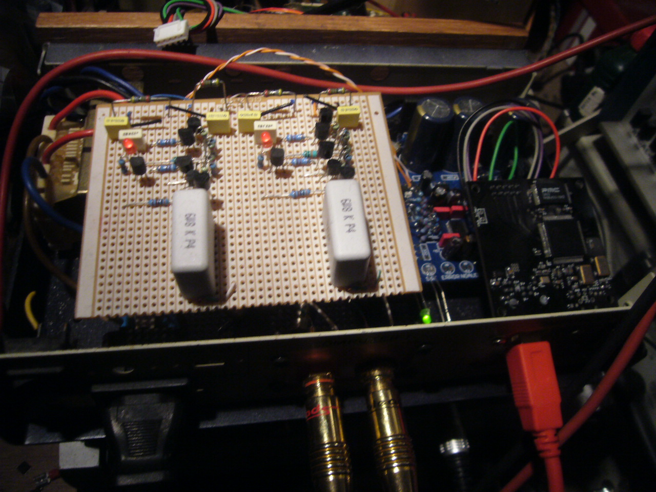

Hi, what is the circuit on perfboard for ? a discrete output stage ?The TENOR Chip works great but this is the dogs bollocks.
Need a bigger case now though!! 😀

@hotiron would love to see more of your design looks great everything in one box 🙂
What do you want to see? I'll take some pics later on.
The case is an old printer switch
I tend to use old set top boxes also.
Use a piece of wood for the new front panel.
Thanks, did you adapt the component values to match the low pass filter recommended by AKM (fc=125kHz, Q=0.692) ?
I didn't use the low pass filter section.
I have checked it with the scope and its totally clean.
