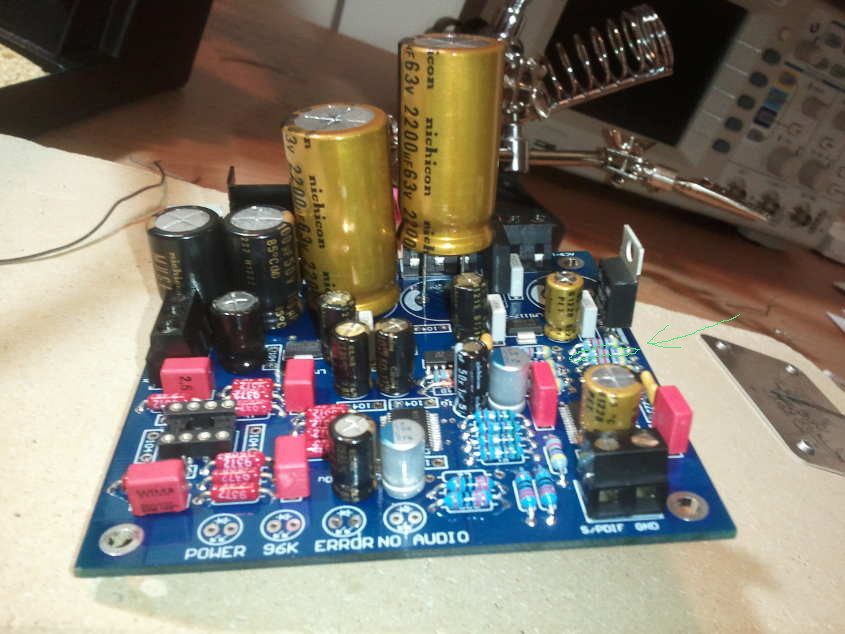

nearly done with this mini2496. i followed the BOM almost exactly, except i substituted some ceramics for the PLL, and some muse for the silmics. still waiting on some replacement 1.5uh inductors (1025-24K API Delevan [MIL] | 1134-1064-1-MIL | DigiKey) for L1 / L2 since the ones i bought were too big. they are rated at 560ma; should this be ok?
aside from being ocd about a few joints that i thought didnt flow properly, and unnecessarily desoldering and replacing, only to realize the groundplane was to blame and have it happen again😀, its gone well.
this pic shows how tight a fit the 2200uF turned out to be. i was able to wedge them in by installing the one near the 7809 first. however, the leads still come out pretty crooked. should this matter? also its very close to, but not quite touching the 7812 heatsink.
i see that the bypass caps for the 2200uF are omitted. would it be beneficial to use some spare 1000pF wima 100v for this role? or are they best left vacant?
also, i measured the 47k resistors before, and i thought they all measured OK. however i measured again after installing them and one of them is closer to 32k. i'm hoping this is due to it being paralleled with another resistance somewhere, but maybe it is bad? i've marked the area in the pic.
and one more question: the wima caps in the LPF are touching the solder joints of the resistors. i'm guessing its as good an insulator as the fiberglass PCB, but thought i'd ask if its ok anyhow.

well the capacitors do fit, i found that a bit of pressure is necessary to keep them vertical while soldering. it sounds good, better than my modded fiio d3. using an opa2107 for now, i will try some opa827 soon.
i initially used a standard 100ma fuse, but it blew instantly. swapped it out for a 100ma time lag and its been working fine since.
now, to find a chassis. been eyeing the lmg heeger OH series, since its cheap and vented, but open to other suggestions. even the largest option would be a tight fit.

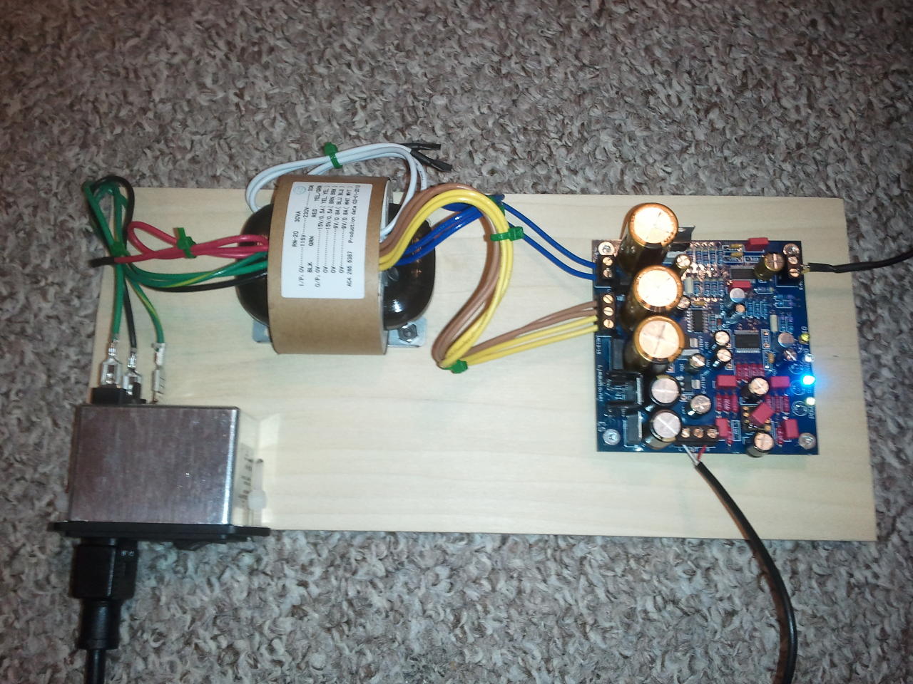

Blowing fuses
Hi all, finished assembling mine this morning using Dario's BOM - thanks so much for putting it together Dario!
Only problem so far is it's blowing the IEC socket's fuse at power-on about 50% of the time, and I'm already up to a 250mA (fast blow) which is quite a bit higher than the 100mA or so I've found mentioned in a few posts in this thread. What's everyone else using?
I have a 230V RN-20 R-core transformer btw - pretty standard there.
Thanks!
Thanks!
I have also had several fuses blow and it seems it is related to on/off surge. I'm up to 3 amp slo-blo on the U.S 120 volt format.
How do you like the sound? (assuming it has stayed on long enough)
Bob, I am using 1 amp slow blow fuses. The problem is the transformer initially pulls a high current to form the magnetic field and charge the capacitors. Then it settles down to a lower current draw.
P.s. my transformer is 120VA with 4 sets of 15v-0-15v 30w secondary's, so 250ma fuse should work in slow blow form...
