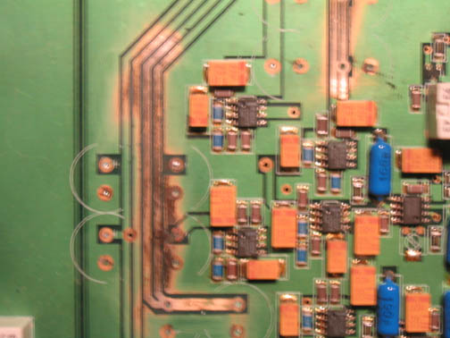

Loris.P,
Wow!!! thats the worst PCB damaged I've yet seen!!!
There should be no reason why it could not be repaired - just will not be tidy - but if done well, will not effect audio quality.
I've never seen an ordinal without jumpers - I dont believe PT redesigned the product after I left... but who knows...
The jumpers (x3) should be located just below the CS8412.
Its not auto config...
Bad news about the philips caps - Philips "badged" Nippon Chemicon Caps - they are the same - just with light blue outer sleeve.
Peter, you will need an new laser head - little point trying to adjust the pots, I can Email a service manual for a Cambridge Audio CD6 that uses the same circuit (different PCB design) for its servo board if it would help - you could also buy the new Laser from Cambridge - was used in there CD4 (standard version, NOT CD4SE) CDT & CD6,

John W. Thanks for the comment: I will swap them over - and useful to know of the laser replacement.
I recognised the capacitor damage image as soon as I saw it.
I thought of replacing all my electrostatic capacitors (and a I count
44 at 2200uF 25 V and 12 at 2200uF 35 V) with Rubicon.
Has anybody got a comment or better suggestion? I could not find Black Gate of the appropriate rating.

well, at last I managed to repair the tracks and change all the caps of the
"worst PCB damaged I've yet seen!!!"....🙂
( acually a very kind french friend of mine did the job.
I don't mention him because I don't wanna give him too much job....🙂 )
but my dacapo still has no output.
I tryed to swap the input module with another one but it's the same.
The "signal" light is sadly off.
I tried to change input module to input2... but nothing.
I tried to put the jumpers wrong, just to hear is some sort of
noise comes out but nothing...🙁
I can raise the amp to the maximum but not a hiss.
Now I'm trying tho leave the dacapo on for one night,
just to see if something happens.
Any suggestion on what to check?
Loris
