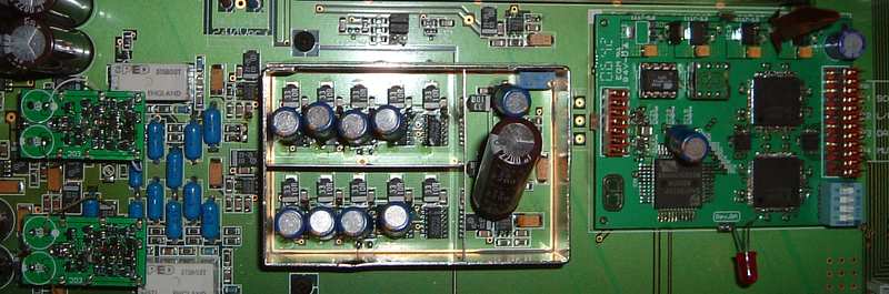

I am about to get someone (may have a go myself) to change the 12 capacitors on the DC PSU card (the card that sits inside the Da-Capo in place of the AC PSU and has the two extrnal connectors to allow connection of the DC unit). As these are the only caps starting to show small signs of damage I need to get them done asap. Obviously they will all be PSU lines running through these caps and wondered if you could recommend the best caps (make/model) to use in place of these 12

I have a PT Too that is playing up too so I am feeling a bit besieged. Both analogue and digital have left me in the lurch.
I thought I would send the da Capo to China and change the filter when it is there.

The ordinal shares the same NIPPON CHEMI-CON caps leacking ecc....
so I'm very curious about the risult of the repairs at Trichord.

well i opened my ordinal, I removed the pcb, but I can't see signs of leaking electrolyte.... maybe I'm lucky🙂
1 question:
when you talk about dip switches of the filter module do you mean the switches that are inside the module?
I have the 1308 filter and it has 4 switches, not 3....

It's the little dip switches (can't remember where they were located as it's been a while since I was inside my da-capo). I'll check next time I have 20min to open it.
The caps tend to leak directly underneath and as they are very close to the circuit board it would be almost impossible to see the damage until you take them off.... All of them do leak eventually so I would rather recommend you have them replaced before the unit dies (as the more the circuit damage the more it will cost to repair).

IIRC all the caps are faulty....

well I contacted Trichord and they answered:
Yes, I have recently carried out this job on an Ordinal.
Many of the caps that I took out were leaking.
I have replaced them with Rubycon ZLH 2200uF @ 25V.
These are a much better cap and suitable for audiophile equipment.
I can supply these to you for £3.50 each plus carriage.
Please let me know if you wish to proceed.
I will buy the caps and then I'll do the job or I will let some
expert friend to do the job for me.
Loris
