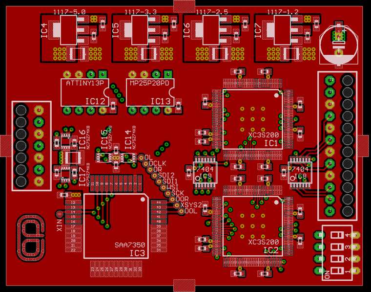

Hi Mr. MAC,
Sorry for the late reply.
PCB design is completed for the new digital filter; the new filter will also come with a new input board (2 slots wide) to support DSD and up to 192 KHz PCM input - compatible with both the Ordinal and Dacapo.
The filter board will support native DSD - compatible with 3rd party’s DVD player upgrade boards, that allows access to the RAW DSD data stream.
The SAA7350 modulator is only fitted for development to allow comparisons with our new modulator designs; it will not be fitted on production modules.
Guess we will start sending out filter + input boards in 2 months, these will be available at "cost", I'm not interested in making money on this project, just to breath new life into my old designs.
John

PCB's for the Filter sections are back from the vendor - will need to build them at some stage - still need to design input board, however filter will work in 44.1KHz with standard input cards.
What filters do you have? interested in loaning a HDCD filter to evaluate the new filter design...
