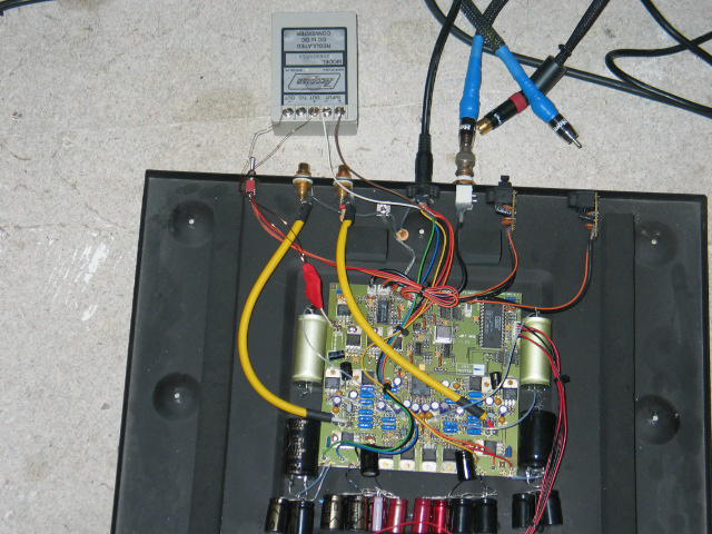

Hi all.
I was too anxious about experimenting further on the Da Capo, so I have started to mod the isomagic s700 which can be had for lot less money.
I started by upgrading the on board electrolytic caps.Most are used as storage reservoirs for the analogue stage. Again the usual suspects black gates and cerafines were used. I have not altered the original dc power supply to the dac. (as yet). Surprisingly, i heard minimal or almost no improvement in the sound despite burn in time!. So i turned my attention to the digital domain which almost certainly would be more sensitive to electrical interference. However, a lot of the components here ere surface mount and i did not want to start messing with these. Instead, as suggested to Ian in an earlier post, within a matter of minutes I had set up the dc/dc converter to 'purify' the electric feed to the digital board. See photo small rectangular block behind the dac. The power input wires were cut and the unit placed in its path.
Well this did work. Immediate improvement. Clarity, refinement, rock solid image stability were the most obvious findings. There was no alteration to the musicality and after burn in the bright edge i initially heard had gone. The degree of improvement was similar to the Da capo capacity conversion but this time the effect seemed to hit the entire picture in many different parameters.
This is such a simple mod, it involves nothing more than cutting a pair of wires and joining them up to the converter. The converters i use are from the USA- make Acopian. This one was a unity gain version. I have as previously mentioned obtained similar if less dramatic results from placing these in the electrical path of valve heaters and solid state preamps.
In comparison to the limited battery conversions that i have made, these dc/dc converters seem to capture a lot of the refinement found from battery supply but with perhaps an increase in snap and dynamics. I think the battery supply conversions may have also had a slightly more smoother and more relaxed presentation. Nonetheless both lower the noise floor and allow a better view of the picture.
I will replace the digital power input of the isomagic with a battery supply next just to see if mains power/dc dc converter is superior to lead acid battery power supply.

Not tried the battery yet, but i do not think that is going to be necessary. This tweak now makes a difference in sound quality that I believe you would not even have imagined was possible with the DAcmagic s700.
I bypassed I believe 2 out of the three op amps in the analogue stage. Not sure why I could not by pass the first op amp except that the sa7350 must be used with a current output therefore needing an i/v converter. John no doubt will correct me on that. Nonetheless even removing two of the op amps makes a huge difference to the sound. Voltage was a little on the low side so being lazy and not wanting to build a valve output stage i just used one of my cheap diy valve preamplifiers (6SN7 with valve rectification). I had to use the entire voltage output of the preamp to get sufficient gain then fed this into the integrated amplifier.
What you notice immediately is excellent transparency like a multitude of veils had been lifted off the sound. Dynamics grow , and bass notes take on real meaning with tremendous power depth and detail to them. Bill Evans Piano now had excellent presence to it, it was palpable how much weight each note was struck with. Air and sound stage seemed to spring into life. I could go on. But then this is not new news as this has been done before to numerous DACs with similar results on various DIY sites, the details of which I have mentioned before. More importantly, the simple valve amplifier stage does not appear to add its own signature to the sound. The sound remains very neutral true to the original but with a lot lot more of the same thing.
I have the DA capo in my main system, but i have a strong feeling the S700 may well be better than it at this stage of development!!
What next?? battery supply, discrete i/v converter
For those of you who believe the difference in sound was probably due to the pre- preamplifier, I ran the dac straight into the main amplifier. The sound was almost exactly the same but this time before i could get a good volume out of it my amplifier went into clipping!
The SAA7350 gives a voltage output.
The bit stream is converted through two internal op-amps per channel that give a dual differential output.
These two, I guess out of phase, feeds are then joined by another op-amp, which is IIRC according to the Philips data sheet, called a subtracter which also causes the signal voltage to be doubled.
On my 7350 DAC the subtracter is the first op-amp.
But it rather looks like the S700 keeps the dual differential all the way through the AD712 dual op-amp to the 2nd op-amp, the AD711, a single.
I guess they do their digital noise filtering in balanced mode.
