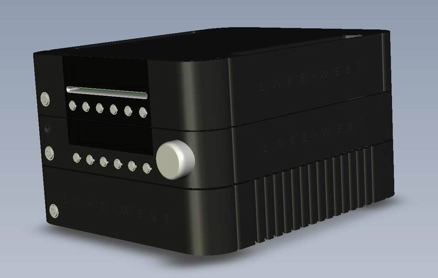

Moog, I recently emailed John with the same question. I hope he won't mind me posting his reply here until he has an opportunity to reply to the thread himself :
"Thank you for your interest in our forthcoming DAC - We are expecting first units around October - electronics are developed - however we are waiting for first samples of the Metal and plastic toolings - which should be completed within 45days.
The Mephisto range consists of CD transport, DAC / Digital Pre and Current dumping Class A amplifier."
I also got this jpeg image:
