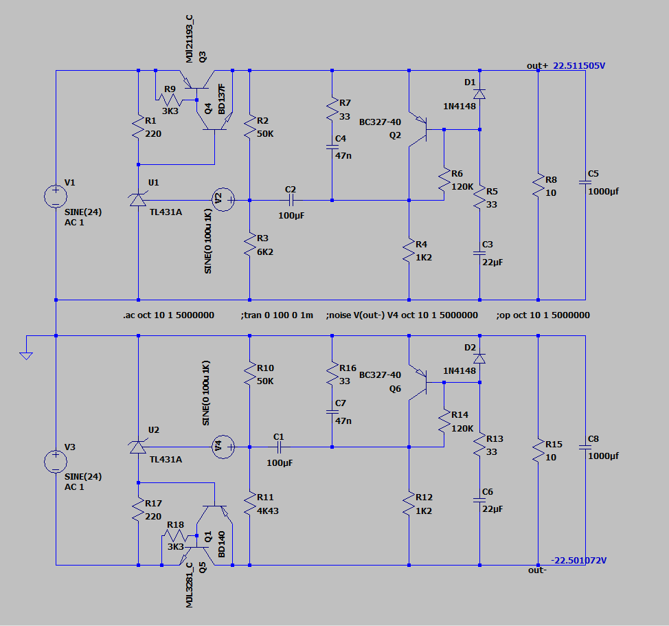

Later today (I’m still on work), I will add negative regulator solution with TL431, so we will have true electrically symmetrical solution.
Negative regulator with TL431.
There is a catch. It cannot be done with the topology of the positive regulator, because the TL431 Vref = 2.5V is referred to the Anode.
An exact mirror would ask for a complementary TL431 that has the Vref referenced to the Cathode.
Complementary TL431 doesn't exist. It is not needed when used as a Zener, but here in the positive regulator, the TL431 is not set up as a Zener, the upper resistor doesn't go at the Cathode, but goes to the output port.
All this, is why, if I need a dual rail PSU, I will make it with two identical positive voltage units.
It simply needs a slightly different transformer and diode bridge.

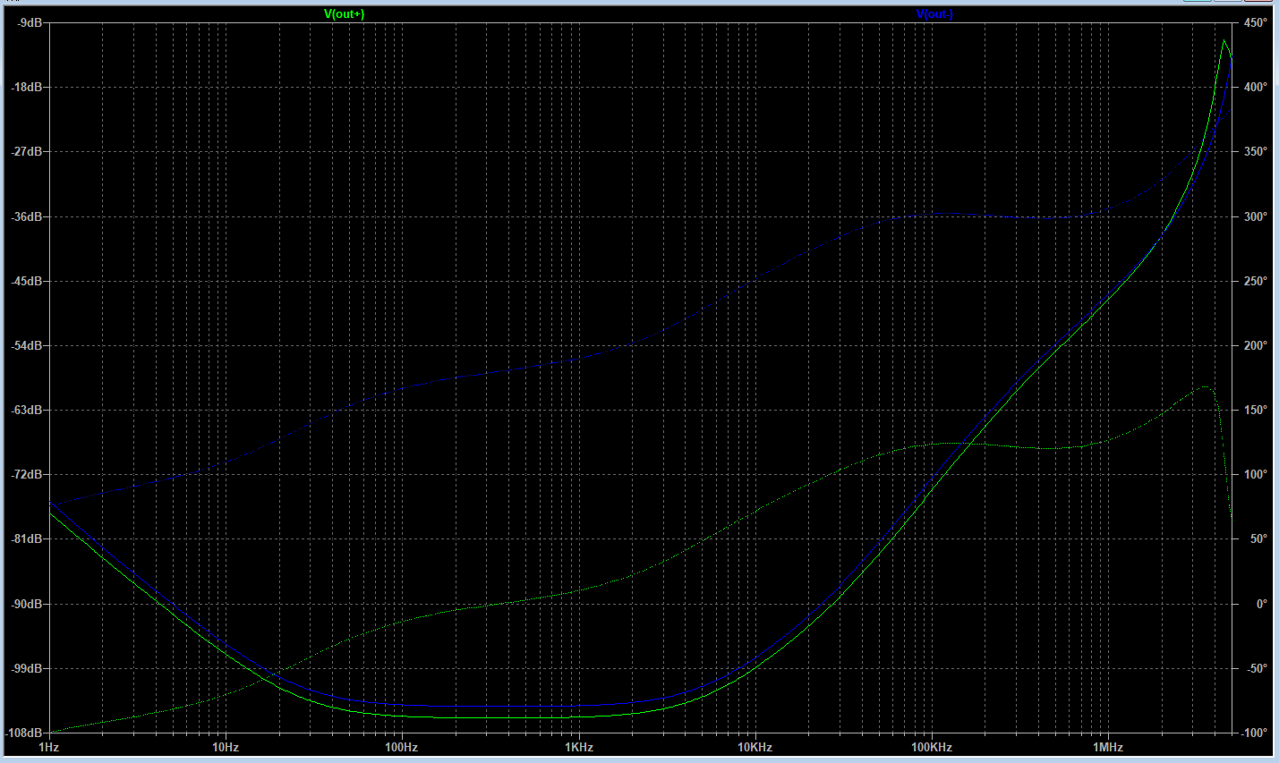

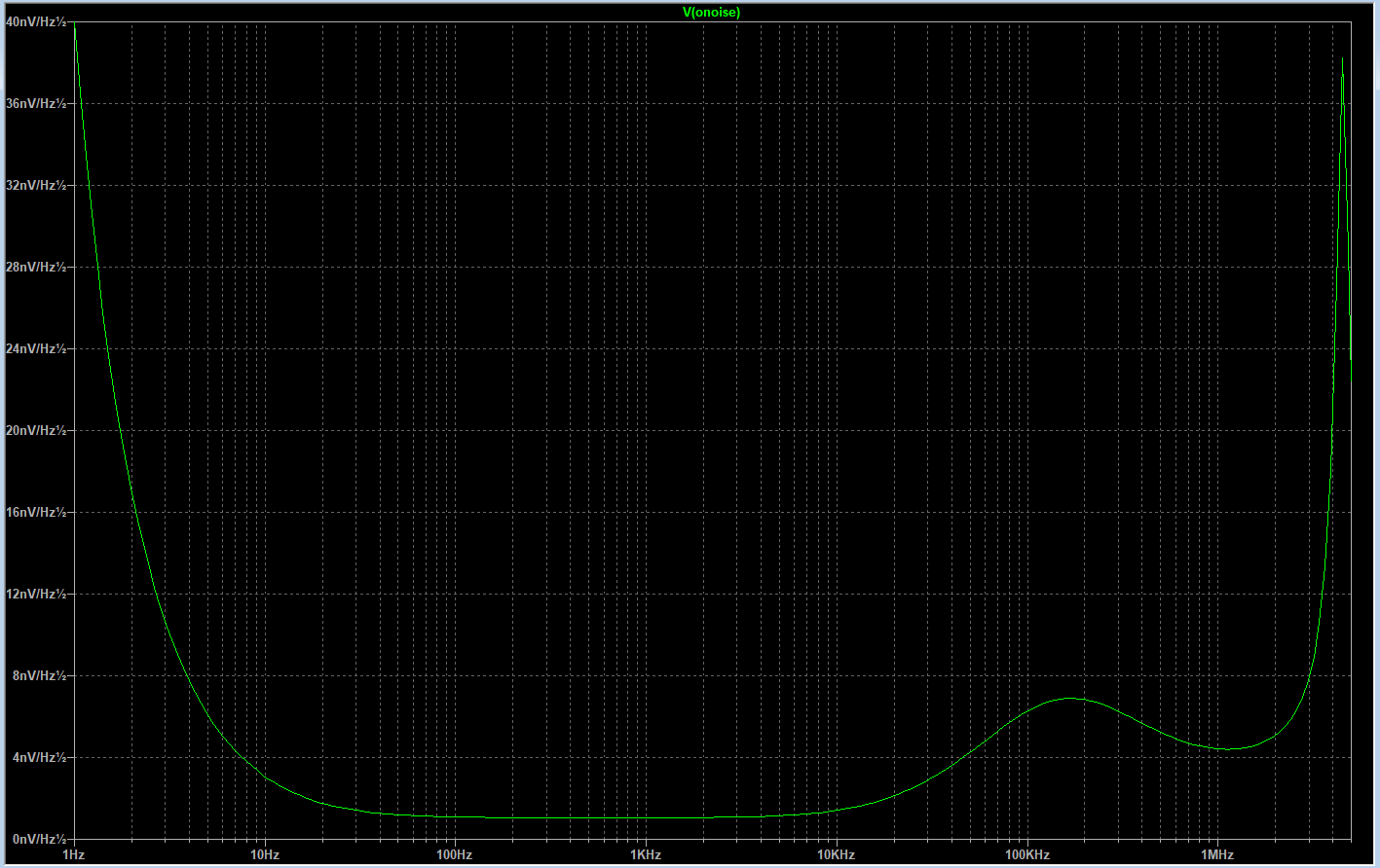

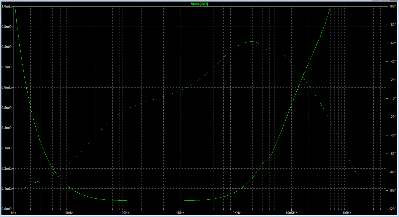

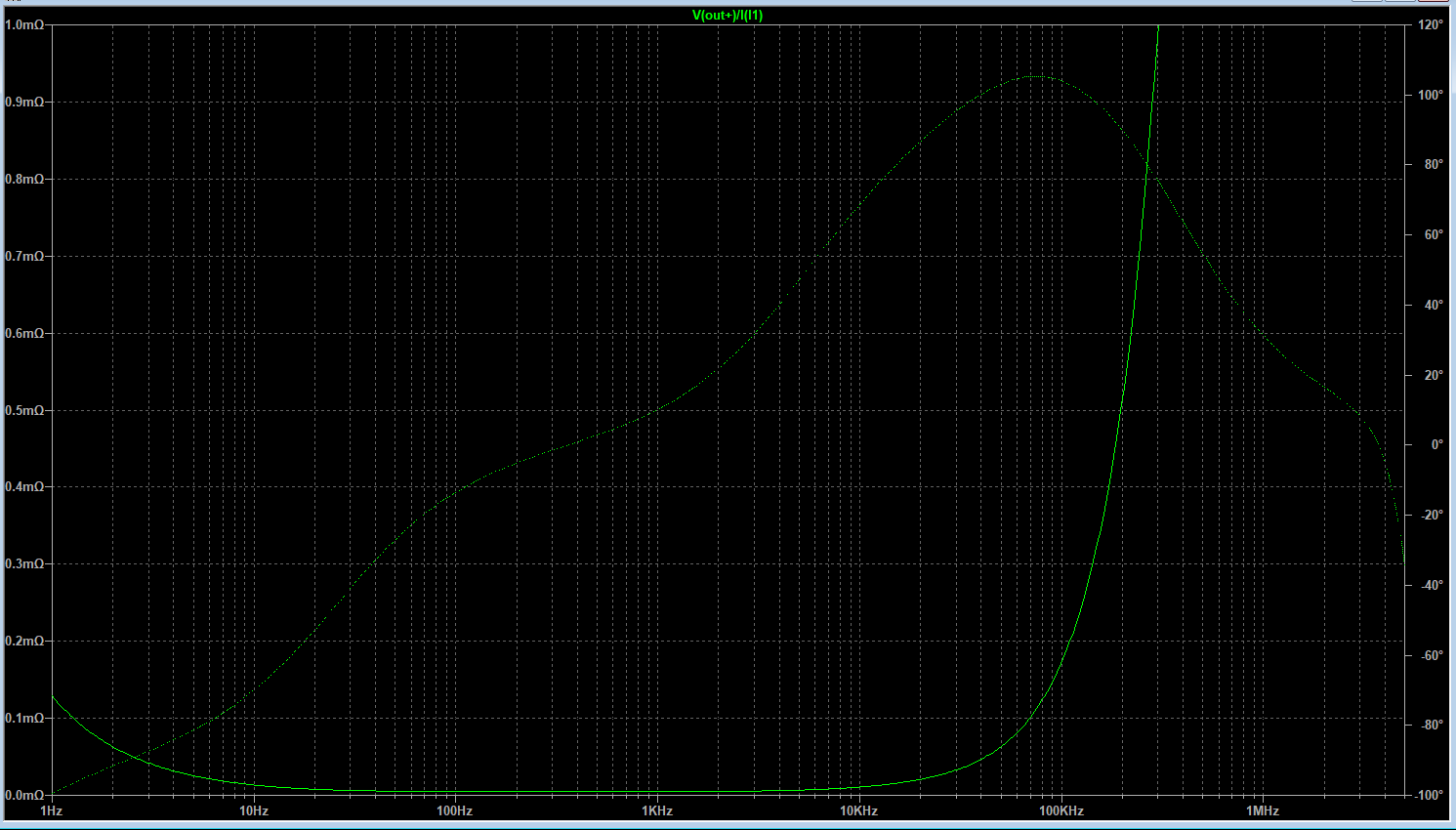

Positive regulator based on the TL431 voltage reference is supplemented with true symmetrical negative. Circuit shown is targeted at voltage regulator for amplifiers or high current at minimal voltage drop. It’s working at only 1,5 V drop across the regulator and still maintaining over 100 dB PSRR. That provides ripple in the range of microvolts. Noise level is ridiculously low at 0,1 uV and output impedance is less than 1 mΩ in the whole audio band and up to 1 MHz.
With more input to output voltage difference, it’s easy to get 20 dB more, and with CCS instead R1/R17 another 20 to 30 dB.
Circuit is stable up to unrealistically low 2 mΩ ESR of output capacitor.
I will go in the direction of building small add on modules that can be used instead of resistor in the any CRC power supply, thus greatly enhancing their characteristics. This is in line with original idea of denoiser circuit and it is the most useful one I can picture.

The negative regulator doesn't work correctly.
The load regulation is not correct because the Vbe of Q1 comes in the regulation loop.
With this schematic we have.
Vout- = - ( 2.5V - Vbe )*( 1 + R10/ R11 )
Load regulation is lost because it is modulated by the load current.
The positive regulator works fine.
Vout+ = 2.5V *( 1 + R2/R3 )
A better way about the negative regulator is to have R11 at the anode of TL431 instead of out-.
Vbe comes in the Vout- equation but not as bad.
This is using the TL431 as a zener diode programmed by R10/R11. The load regulation stays poor, not as good as the positive regulator.
This gives:
Vout- = -2.5V * ( 1 + R10/ R11' ) + Vbe

Yes, there is no easy way to make negative regulator with TL431 that works as intended in every aspect. Load regulation on the negative regulator is deteriorated but dynamic advantages of denoiser circuit are there: PSRR, noise, dynamic impedance. If load current of negative regulator is changed by couple of A, output voltage changes in tenths of volt range.
If R11 is moved to the TL431 anode, voltage reference of TL431 is moved outside regulation loop and all benefits of the denoiser circuit are lost.
I see this good enough for the class A amplifier PS, where there is no regulation at all or capacitance multiplier is used at best. Cap MX has no load regulation and worse PSRR and noise figures.
I’m not finished with this jet and will try to find acceptable solution for negative regulator that maintains load regulation.
