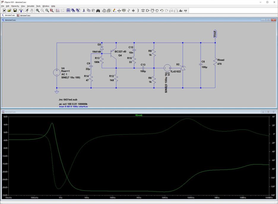

Tombo56,
I simulated your schematics from post 1040.
I need the 100uF at the output for stability with a small series resistor ( as a real cap ).
I get a great improvement, replacing R1, 1K by a 4mA constant current.
-162 dB rejection at 100 Hz
-143 dB at 1 KHz
-117 dB at 20 KHz.
C1 10nF is important about stability
Lower gives better rejection, but not safe.
I have played with other component values, they seem optimum.
R7 33 ohm, seems useless, I removed it.

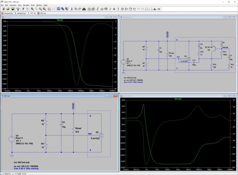

Here on the left is a standard 5V TL431 shunt regulator/reference from the datasheet. On the right is the denoised version. The dashed rectangle contains the module to replace TL431.
Not every simulation containing same components is the same. It depends on models used and additional component parameters. LTSpice simulation is very useful but only real test circuit gives definitive answers. Just add small inductance between all components connection points, representing pcb traces and small cross capacitances and there will be different situation.
I checked stability (not very extensively) at the beginning and it was OK. Checking again, I have different outcomes, some with big output oscillation.
If I leave C1 in place and no output capacitor, output oscillates after 30 mS and on. With no C1 and no output capacitor, output is stable in 2 minutes long transient analysis.
With C1 in the position and output capacitor, output oscillates after 60 mS if capacitor ESR is high (500 mΩ), but is stable with 220 and 50 mΩ.
Without C1, output is stable with whatever output capacitor ESR.
So, seems that C1 is better to be omitted and it ruins PSRR at high frequency, especially if you add Darlington or Sziklai instead of Q1. Anyway, I don’t find this capacitor in the actual implementations.
R7 changes phase response at high frequency. Check 22 nF and 33Ω and then with 10Ω and see how phase response “bends” and stays below 180°.
Without C4 regulator oscillates.
Regarding CCS instead R1, it’s great that there is a big improvement.
Again, this circuit can be insanely good adjustable voltage reference, packed at small PCB with SMD components that is retrofittable to existing circuits or a complete standalone regulator.

Note that the TL431 shunt regulator/reference needs some additional power supply series resistance (or typically a separate series resistor) to work properly. The 1 ohm shown in these simulations is too low.
Indeed, your module is not a 3 pins replacement for a TL431.
Furthermore, there is no need to replace the TL431 of the modified hardware by the one inside your module.
The thing that might be worthwhile for a mod at a TL431 is what's on your module without it's TL431.

Like I said my module is a low-noise replacement of TL431 in low-current shunt regulators/references. Not universal replacement.

What do you mean by this? Why is it not worthwhile to replace TL431 with something having lower noise?
I mean, the Elvee' s denoiser module is fine for an add on to a TL431, with no need to change it.
Elvee's denoiser has 3 terminals:
1 Ground
2 In supply voltage
3 out to the device under denoizing.
Simulations, in previous posts, show clearly how an Elvee denoiser is added at the TL431 used in a PSU.
"Replacement" of TL431 is ambiguous and an inappropriate word here. May be a language misunderstanding.
1 Ground
2 In supply voltage
You seem to be missing the point. Even if TL431 is included in the TL431-denoiser add-on PCB, you can always leave it unstuffed and use your TL431-denoiser without it. Adding TL431 to the module makes it more universal since it can be used as a direct low-noise TL431 replacement in shunt regulators/references.
