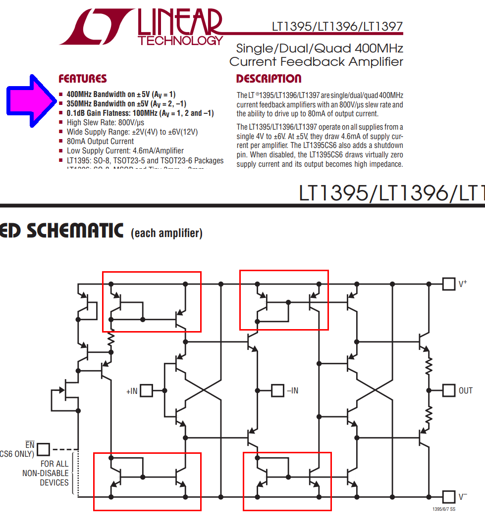

"Current feedback opamps" with bandwidths of >100 MHz certainly do exist, and have been commercially available starting in 1999. Since these amplifiers depend upon current mirrors for their successful implementation, it seems to me that's conclusive evidence: High bandwidth current mirrors, with low phase shift at 0.25 MHz, do exist.
_
_
Indeed ICs highly use current mirrors, an ideal situation because on the same die.
