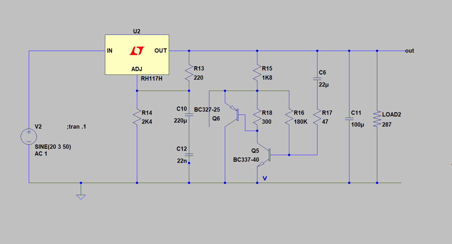

But first let me address the following: I don't think the LTSpice sims work like everybody thinks. Try this:View attachment 806094
The connection between Q6 and C10/12 has been cut. However, it sims just like the version with the connection made. Wierd. The only thing I can come up with is that the network can also work as a shunt between the two power lines, and that this is what the sims show.
However, in my test fixture, cutting this connection has a huge effect.
So, my question to y'all is: did I do something wrong here, and if not, what is going on?

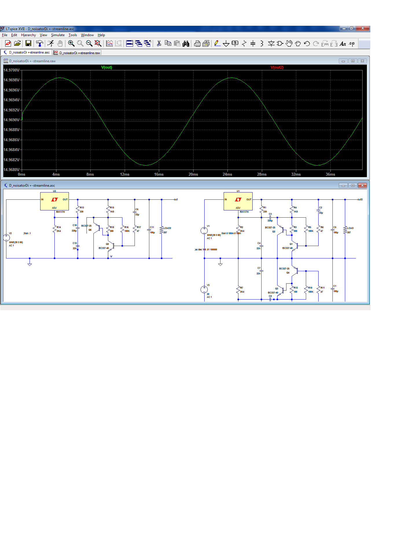

In the asc you posted, the outputs of the regulators with and without the denoiser are labelled with the same name: out.
For LTspice, this means that they constitute a single node, ie. they are shorted.
When you unshort them by using different names, things become normal:

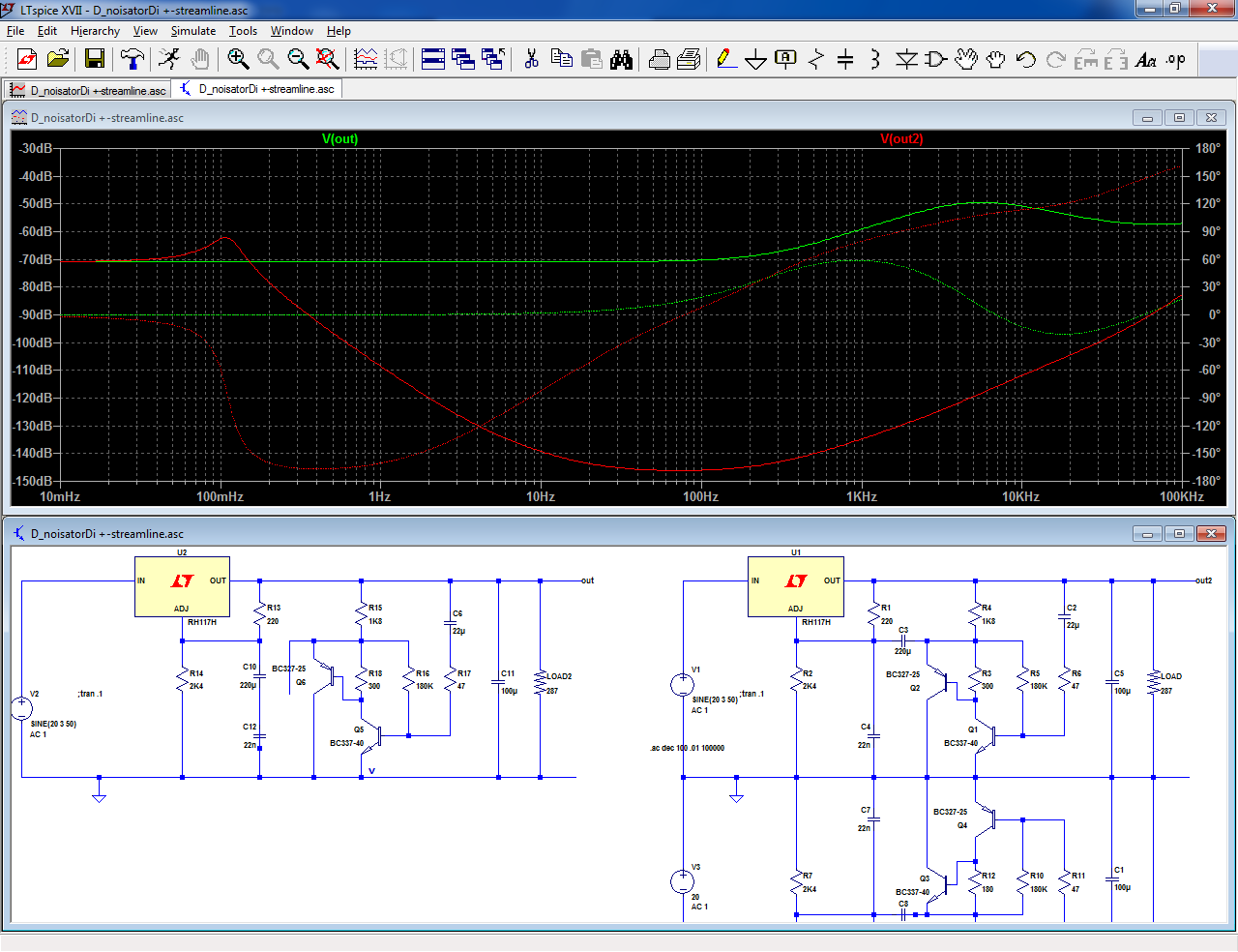

attachment.php
With a 100ns resolution, everything looks normal: there is a visible residue for the regular 317, which is normal, and nothing is visible for the Dienoiser, which is normal too: in transient mode, the tolerance, digit number and resolution should probably need to be increased to see something.
There is no sign of instability, but the sim is not fully reliable for that: one needs to make a physical test to confirm it, which I did

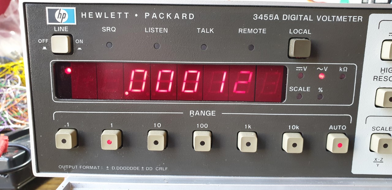

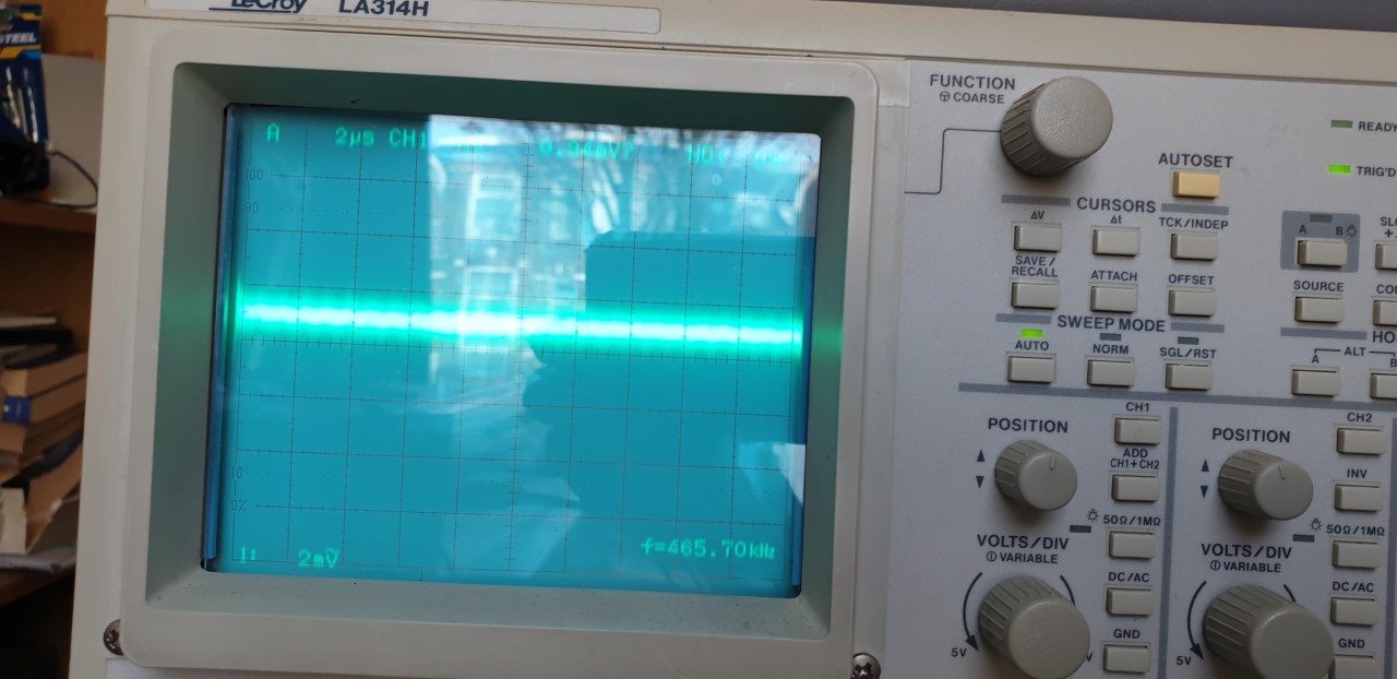

I use them for a power amp frontend within a cramped case and selfmade adapter boards. Used other LM317 implementations for this before (standard and with tracking pre-reg) and would like to test this one. The amp is a NCC220 from avondale.
With the denoizer on, the noise climbs to .12 uV, but it must be even lower in a well shielded setup. I can see the sort of variations in the noise voltages, .12 was the maximum. And it reacts to presence of a hand or finger like a Theramin, it is very sensitive to EMI. In short, shielding will be important to get the best results.
Very interesting!!!
A difference of more than 55 dB compared to the regulator alone (without bypass capacitor)!!!.
Could you repeat the measurement by short-circuiting the resistor between base and emitter of the BC560C?
That measurement could help to see the typical differences between the denoiser and the dienoiser.
