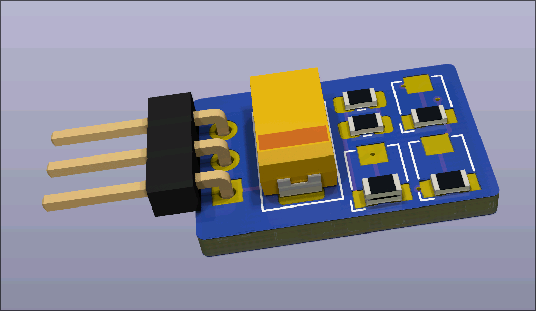

Using 3 trimpots is very practical if you want flexibility. But I specifically chose the Bourns TC33X pot footprint because it very conveniently accommodates a 0805 resistor. You could even sandwich two of them. But the Vout one does have two 0805 footprints in parallel that are in series with the pot, so you could tweak Vout from resistors but it can become a pain if you have to do it for various Vouts.
This addon already has the CCS diode and its 2.2uF cap footprint. But don't think it's required (the 2.2uF cap). Also has the original protection resistor footprint, on the base of denoiser BJT, 10-47R. And I highly recommend installing it since this sets Vout of your circuit. You don't want that BJT to go bad.
CCS LED resistor has standard value, CCS current resistor doesn't have to be precise, standard values are fine.
Even the compensation pot could potentially be replaced with a standard value resistor. MPSAx6/BC3x7 on my discrete design needed some 4-5K to get within 50mV 35C-75C, so I'd just use a 4.7K.

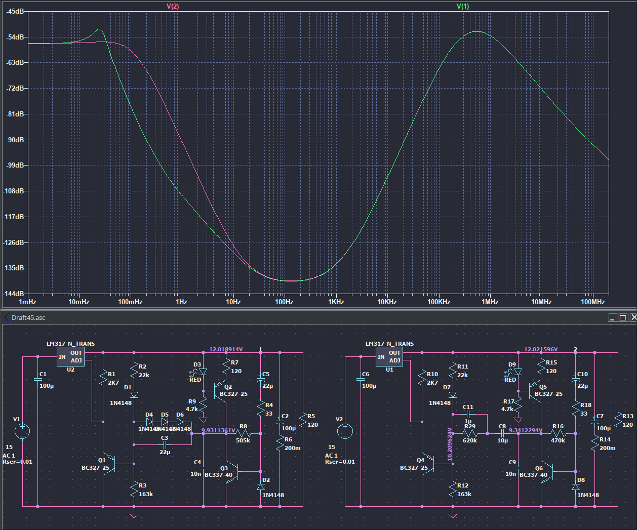

Come on. There is NO voltage regulation. Regulation is lost, removing Adj R19 R20 from the usual way to use LM317
Change the load to see what is the voltage regulation. Change R26 to see what happens to the output voltage.
I am talking about the two circuits at post 3068.
Do not confuse the left circuit that is OK, with the right circuit ( the one with CCS ) that is IMO wrong.
Yes you were right, pretty bad when changing load.
But at least I can now use a red LED for the CCS in Denoisator. And maybe temperature compensate the denoiser but that shouldn't matter much.
Still, this version of the circuit worked fine for a long time, in my headphone amp.

I attached the CCS NoNoiser version but I used LT1117 regulator model, I recommend you get LM317-N spice model from TI.
The whole issue with CCS NoNoiser is the denoiser BJT Vce, which has to be tweaked because of the 3x1N4148 (at 12Vout) output voltage swing limiting diodes. If I can find another arrangement then that resistor can be some standard value and no need for a pot.

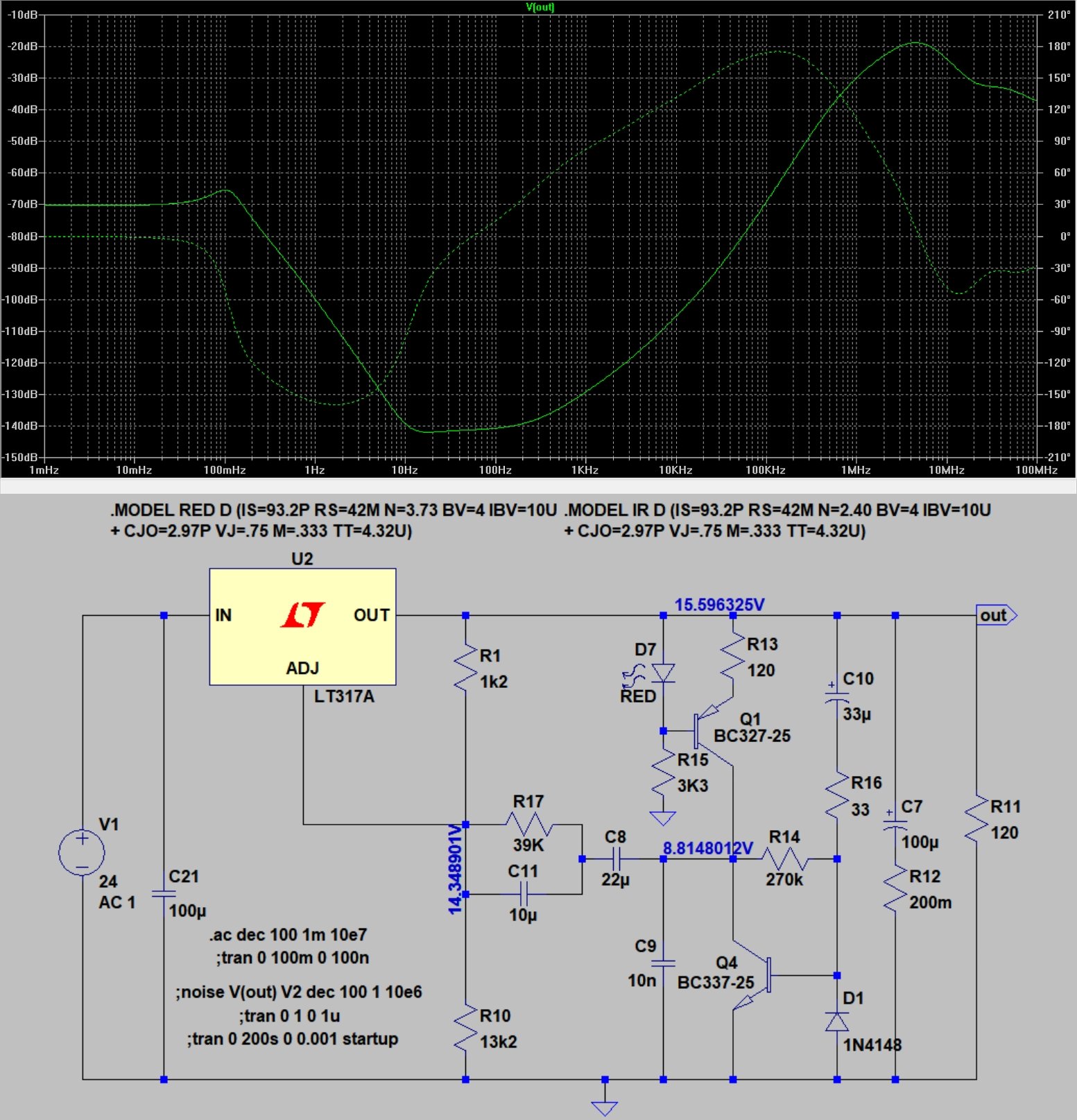

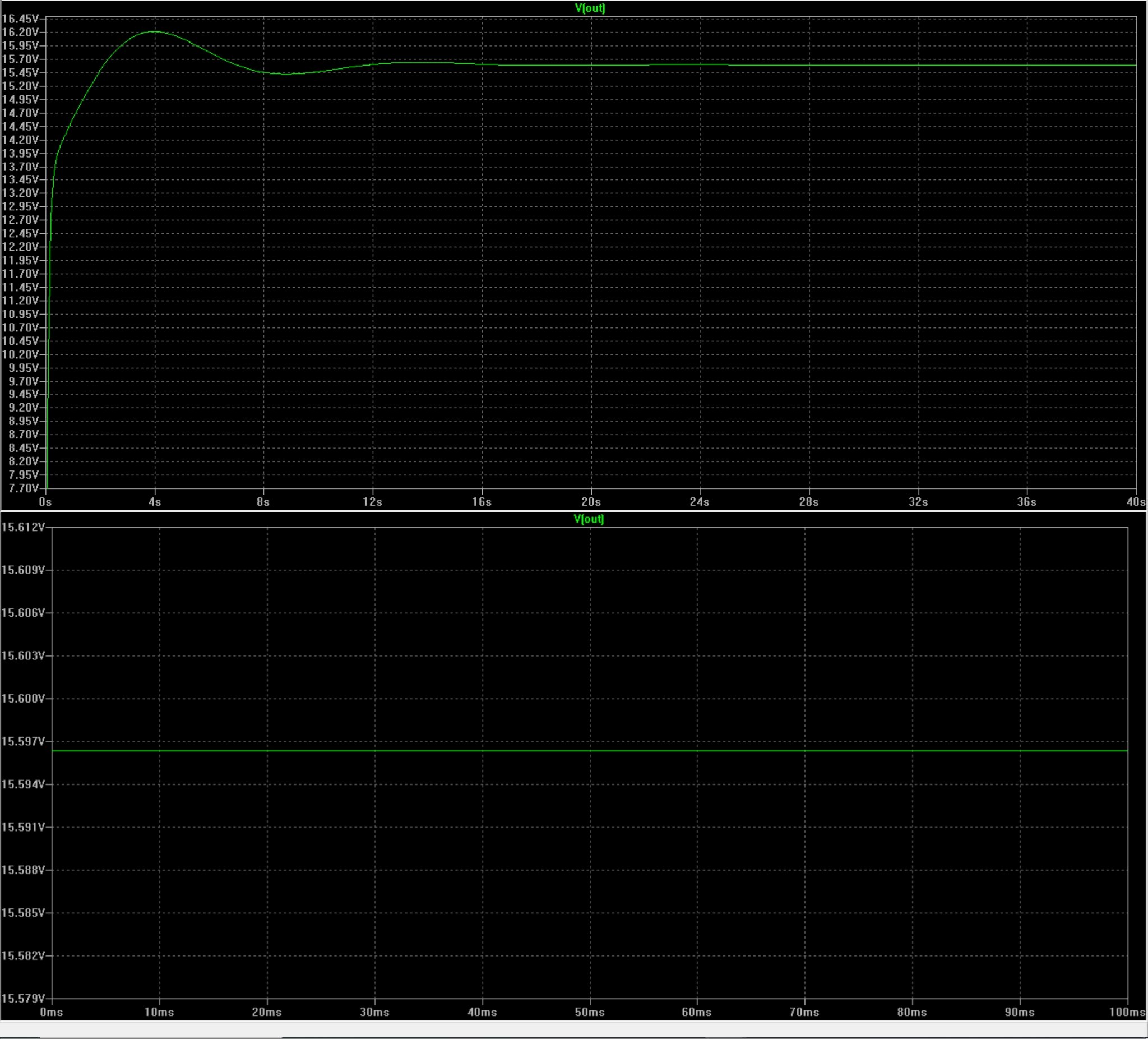

I'm playing with this version in LTSpice, seems like startup swing is limited but there's a slight AC hit. Replace the three (at 12Vout) diodes with a resistor and small cap.
Another benefit seems to be faster startup. Couldn't find any other performance hits in simulation. Would this work?

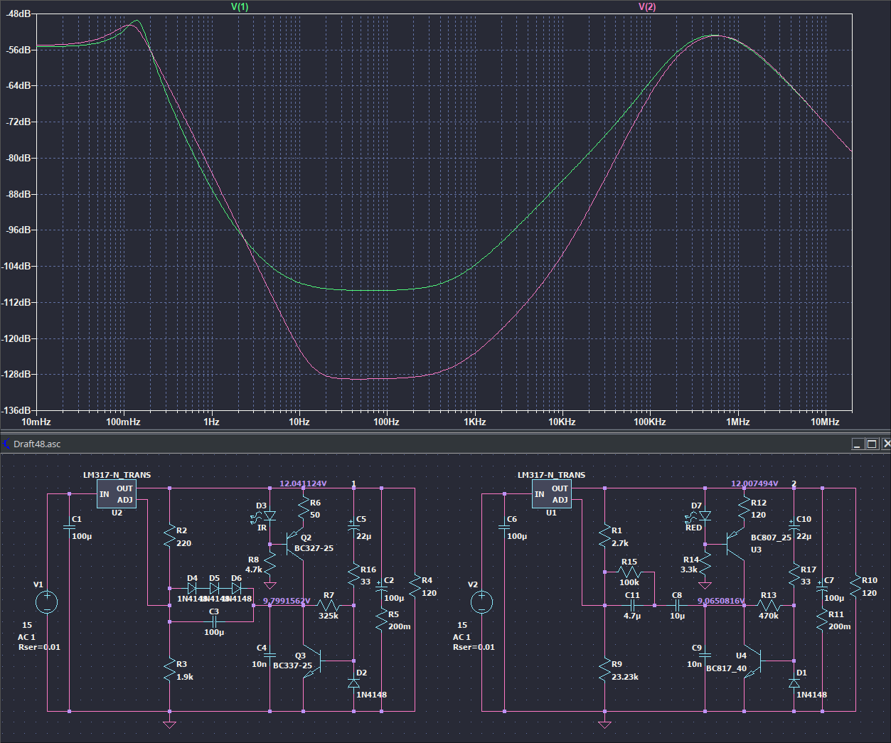

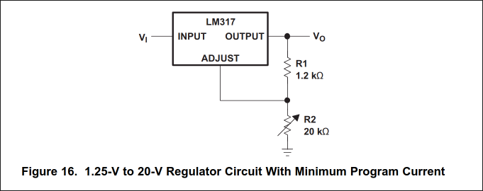

Or maybe a better compromise. After reading TI's datasheet for regular LM317 (non -N) I noticed they do have a low programming current application:

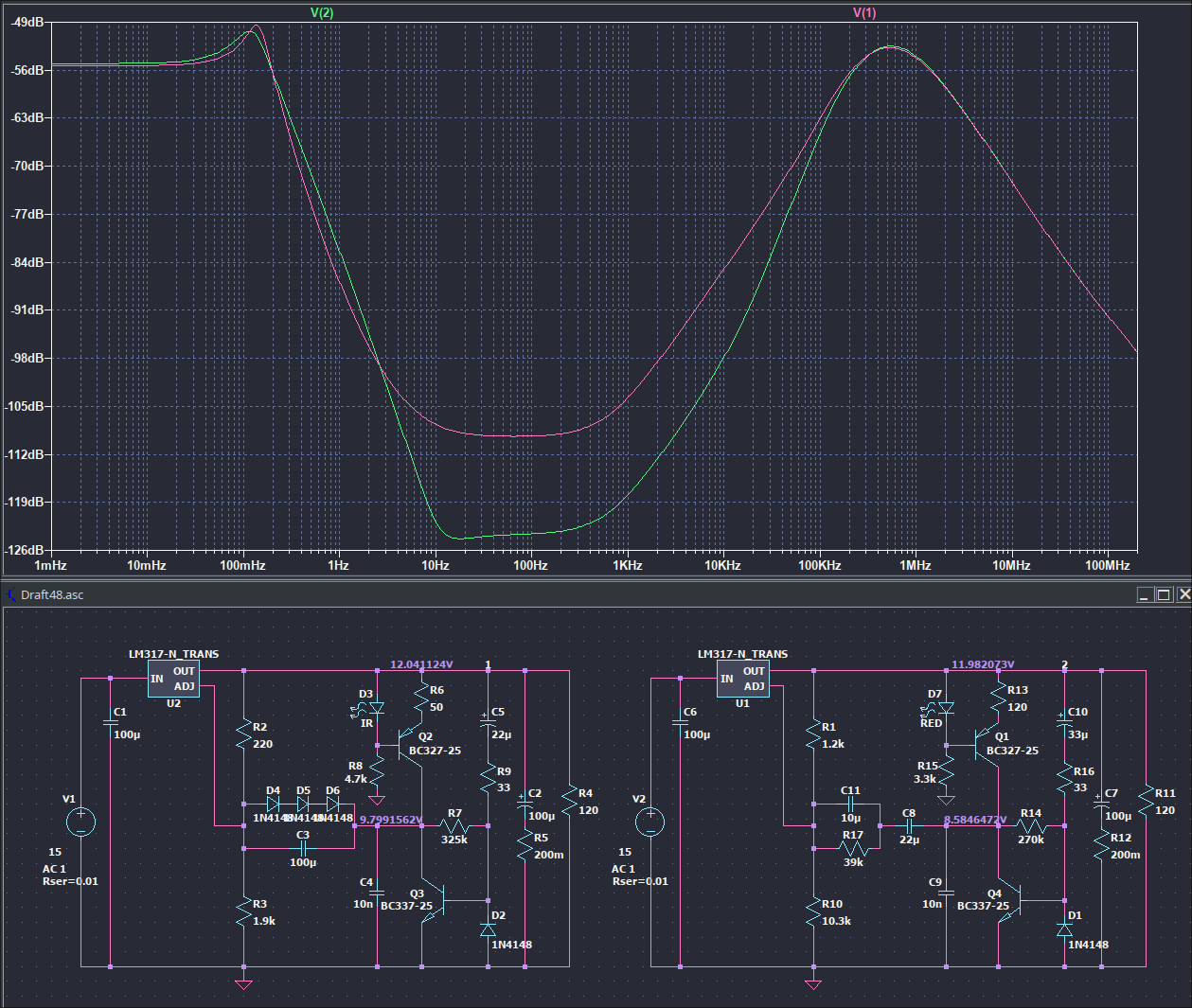

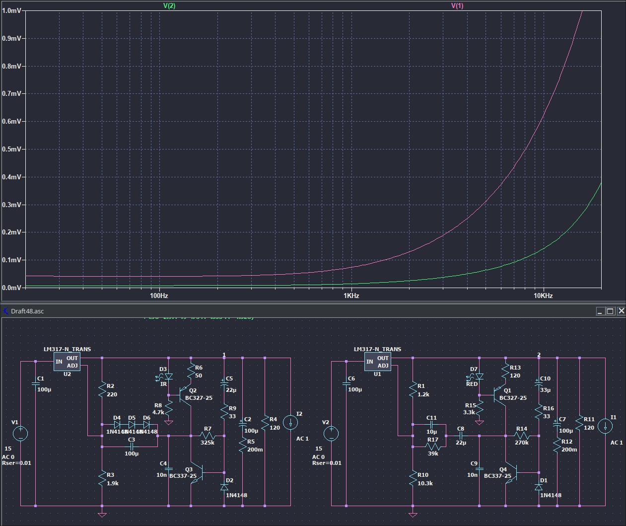

With R1 at 1.2K we get more performance out of the CCS. Adding the latest arrangement to remove those startup swing limiting diodes, there's some 0.5V overshoot (which could maybe be lowered even more) and it should reach some 120dB of PSRR.
This is with a regular red LED, no extra diode in CCS, denoiser resistor can be some standard value, and Vout is set like regular LM317, two resistors in parallel should offer good enough precision. No trimpots, and stock LM317 tempco. And Vce of denoiser BJT is still high.
edit: Output impedance also gets a nice boost in performance:
That's still Elvee's Denoisator with CCS but I modified the startup swing limiter. CCS v2 or something I don't know.
For me it seems like a good compromise. If it reaches 120dB of PSRR then it's pretty nice, since it has the original LM3x7 tempco rating. And no pots required.

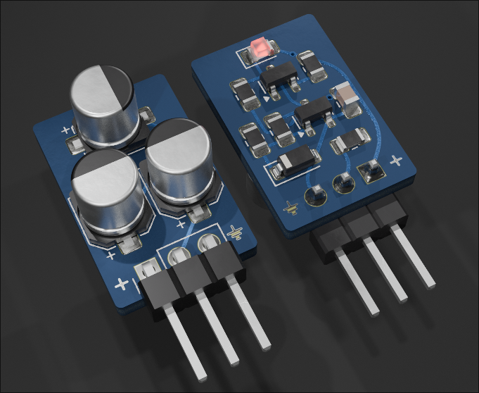

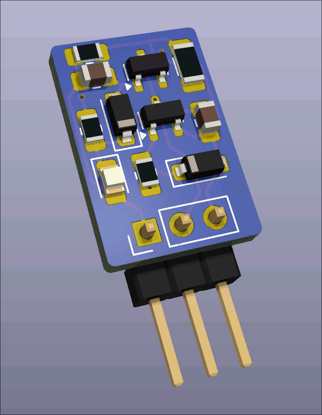

An addon board would look like attached photo, has everything required and would need standard values. You'd still need to replace the two original resistors with 1.2K and whatever is required for your desired Vout.
Here's my sim in LTPspice, with gain of -70dB in pssr, and a similar response for .tran startup.
The filter for the startup spike needs different values for other Vouts and LT317 model is quite optimistic.

At 2.7K there's about 10x current in the divider compared to ADJ current. But 1.2K is a datasheet value so I suppose that should be a safe max value?
