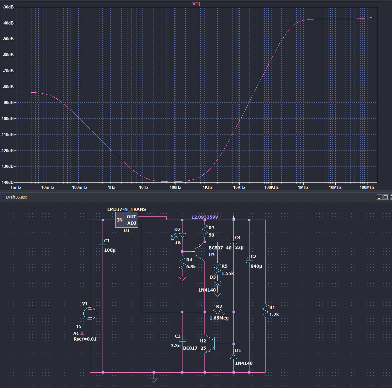

D-Noizator: a magic active noise canceller to retrofit & upgrade any 317-based VReg

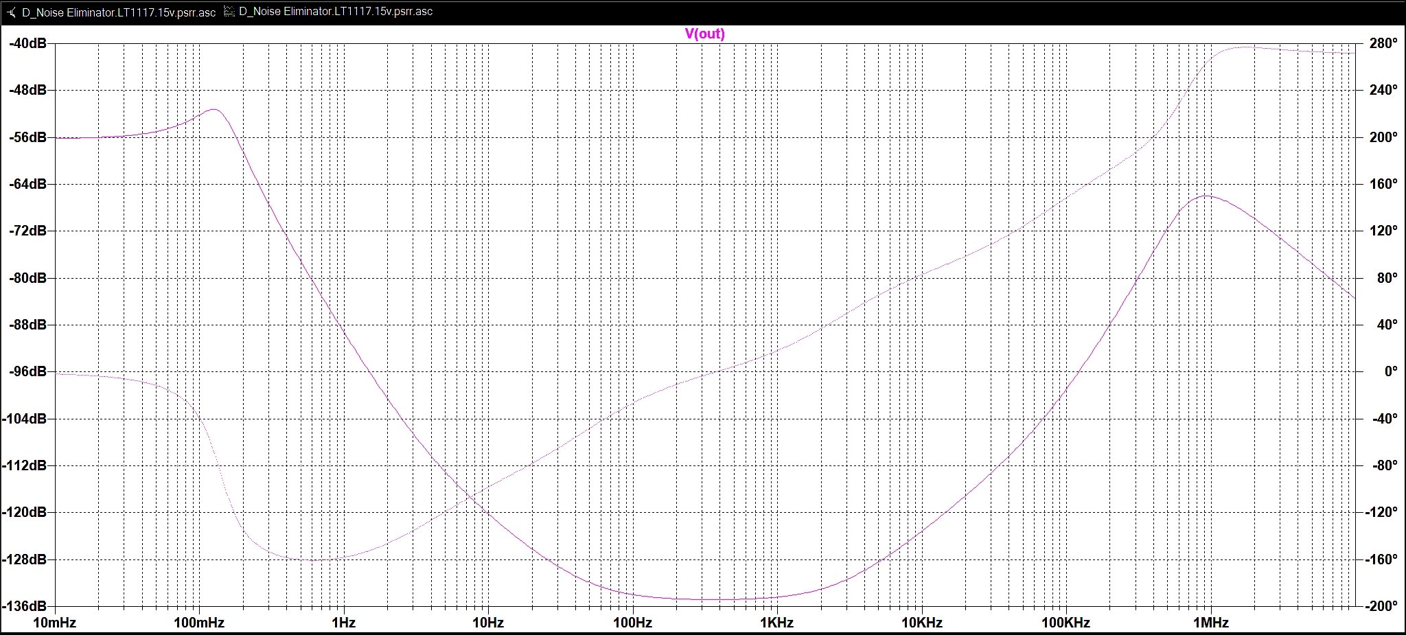

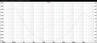

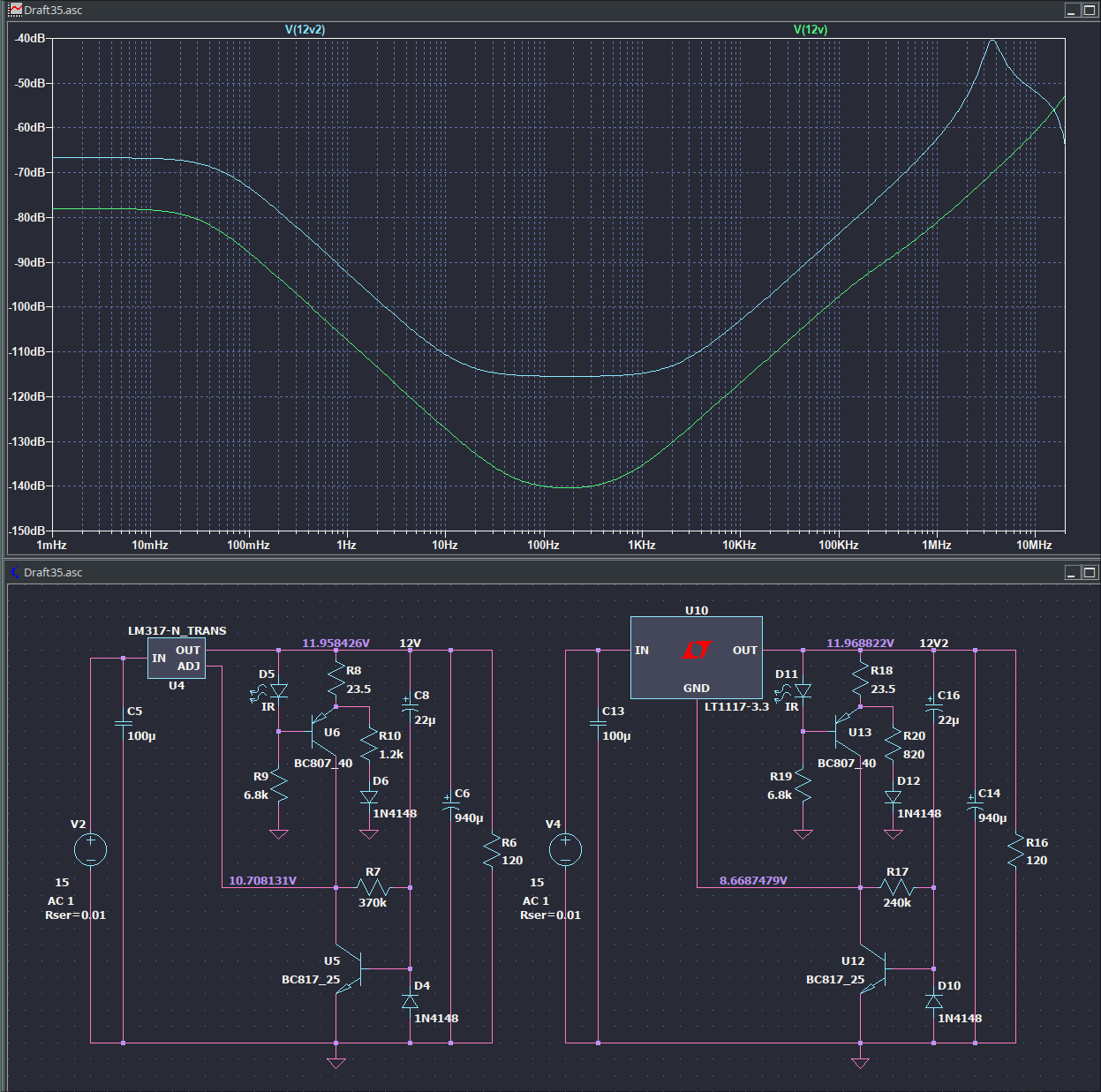

Here's the sim I did with LTSpice, using the LT1117 version. The problem of increasing the C4 value is the increase in size, which would demand going SMD if you want to make an add-on with the noise eliminator parts. Actual measurements of completed circuit would solve the puzzle on why using LT317 model the PSSR improves so much, going down to -148dB between 80HZ and 300Hz. That curve improves with a small RC filter before the regulator. Certainly recommended.

Actually it seems to also work with the LM317-N model, tried it with LT317A one and it also works, but with the Nexperia BC8x7 models. Doesn't seem to work with stock BC3x7 ones, at least for denoiser position.
Not sure if this is an artifact of the spice models or would work out in practice.

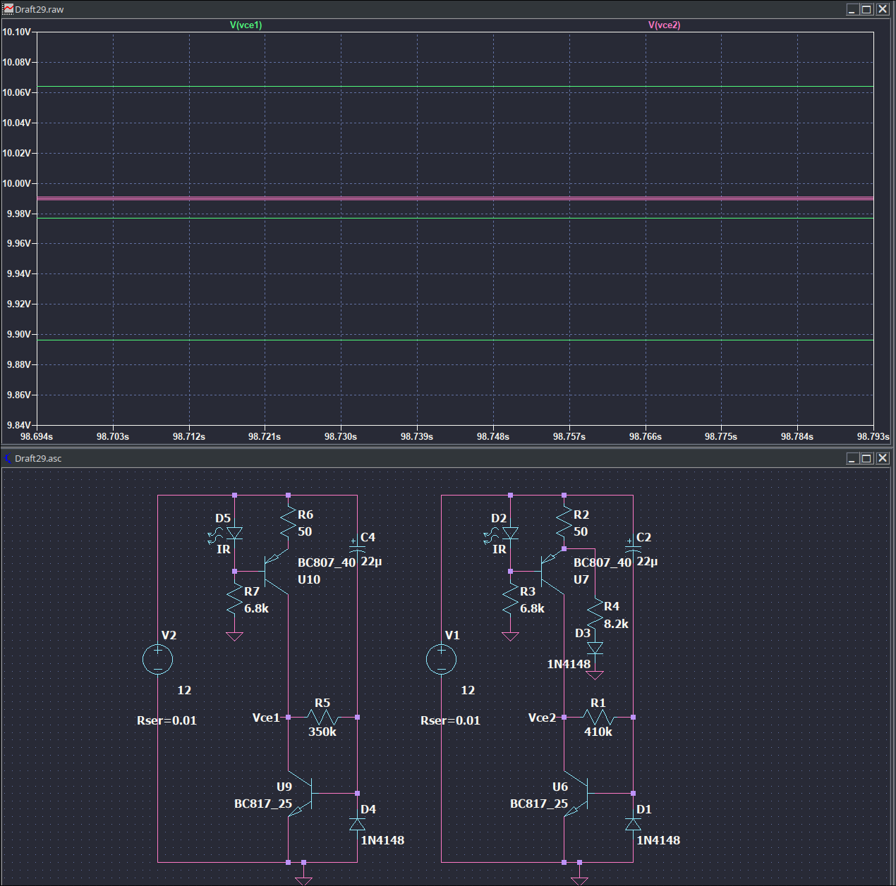

So this actually works, to some degree. Without it Vout varies by around 1V between 30C and 75C. With it I managed to get it within about 280mV between 30C-75C. For BC817-25 the diode resistor value seems to be somewhere around 2K. So far.
Curious if I can get it even tighter, I need to add a large value potentiometer to adjust Vout more easily. Adjusting the diode resistor changes Vout.
2K translates to about an even split of current between denoiser BJT and diode at about 11Vout or so.
edit: at 1.75K it's around 210mV 30C-75C
Managed to get it more or less spot on. Some under 10mV variation, with 1.55K resistor value, but this makes for a new issue, which is not so bad. There isn't much current going through the denoiser BJT. About 2.4mA measured. And 7mA going in the diode. For a total of 9.4mA through the CCS resistor.
AC still looks good in simulation, I don't think it changed much in reality. I might measure it at some point.
These are the exact values I used:
R2 was not so high, but over 1meg in my case. I think C4 should be lowered to 10uF for such a high value.
So at this point I'll clearly increase the CCS current, some 15-18mA total, I want to still have some 6-8mA through the denoiser BJT. Not sure if this will change R5 value, or Vout variation over temperature. I guess I'll find out.
This is pretty good, solves last issue with this circuit, and for only two more parts (and some extra current, maybe), although in practice it might be a resistor in series with a pot + the diode.

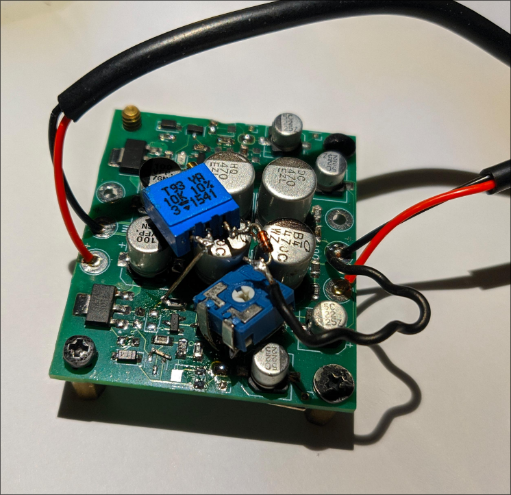

I tested on the latest CCS NoNoiser PCB I made, removed some parts, shorted others, worked fine. But this circuit deserves its own board.
Another important aspect is that this direct coupled circuit was always stable for me, everytime I tried it on any PCB.

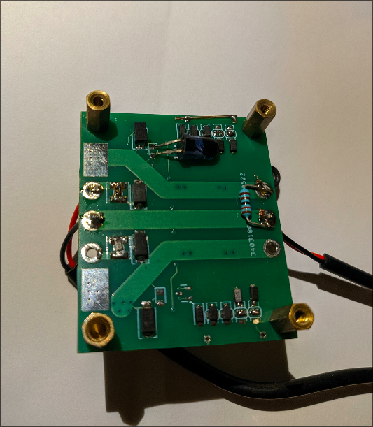

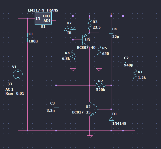

Tested at higher current, 19mA total through the CCS, worked out at similar ratio, 6mA through the denoiser BJT and 13mA through the new resistor. It works, some 20-30mV drift across 30C-75C.

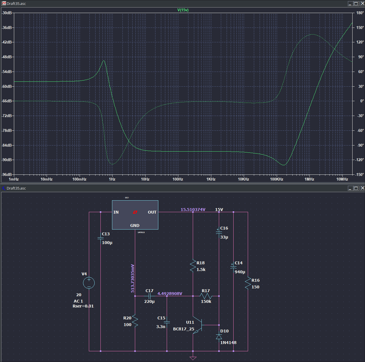

Worked the same for the discrete regulator, had to use IR +red combo. Red + blue was way worse. With IR in CCS and red as Vref worked at 6.5mA through denoiser and 12.5mA through resistor with same 20-30mV variation.
There is this extra current cost but it works. I can get 6-7mA through the denoiser with small temperature drift.
edit: the series diode did help me measure the pot value in circuit, with DMM.

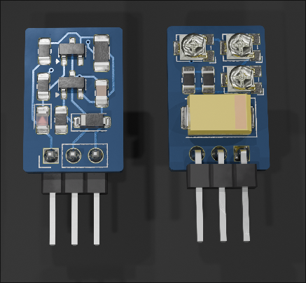

This addon should work in place of the original LM317 resistors (and Cadj where the case). If tantalum caps are not microphonic. And output capacitor might have to change in some cases.
It should work from 5Vout to 30Vout, that tantalum package is common for 10-22uF with 35V rating.
Pots are for adjusting LED current, Vout and temperature compensation. There's a 1206 resistor in series with compensation pot, at 30Vout that adds up to some 0.4W, and those pots are 0.1W max rated. There would be a total of 0.6W dissipated power by this module, at 30Vout. Some thermal goop could be used to thermally couple the LED and BJTs.
This is just a concept atm, I might make and test it at some point.

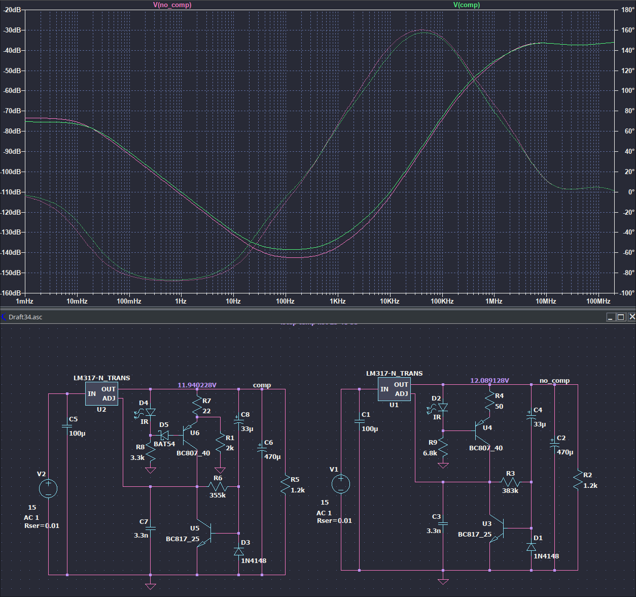

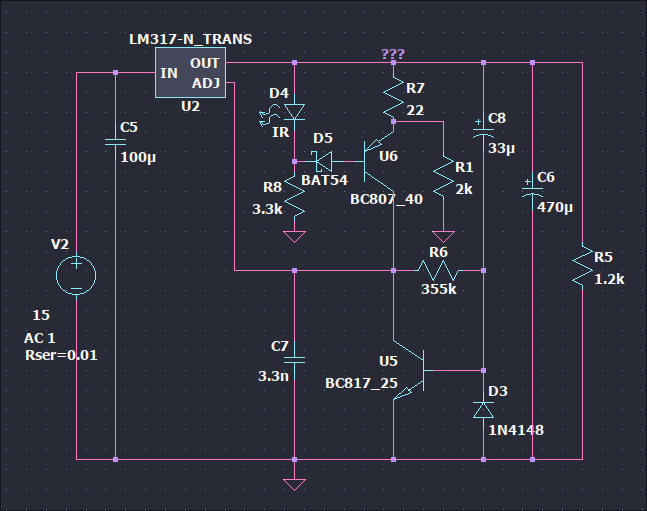

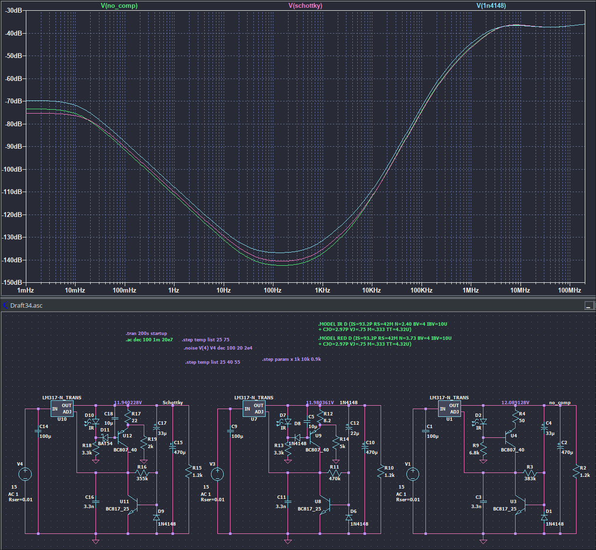

I may be able to reduce the wasted compensation current by adding an extra diode in the base of CCS BJT, like this:
D5 seems like it could fit in the 1.25V across the CCS. A Schottky has some 100mVdrop in those conditions. My IR LEDs have some 1.07Vdrop and simulation indicates it should work out without AC being affected much.
Some 3-4dB loss is acceptable. Applying D5 makes for about an even split of current between R1 and denoiser BJT (I tested this on my discrete test board I made). Which would be a good improvement.
This worked for my discrete supply but used a regular diode since I had the room. With a regular diode the compensation current drops to 2-3mA through the resistor but LM317 seems to take AC performance hit with a regular diode. Way too high Vf.
edit:
We could be able to recover some of the lost AC performance with an extra 10uF cap but I'm not sure it's worth it. Does seem to help the 1N4148 diode version, but I'm not sure I'll test with 1N4148. It would allow for least compensation current, 2-3mA.

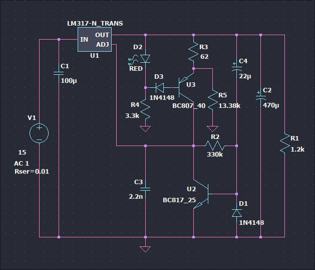

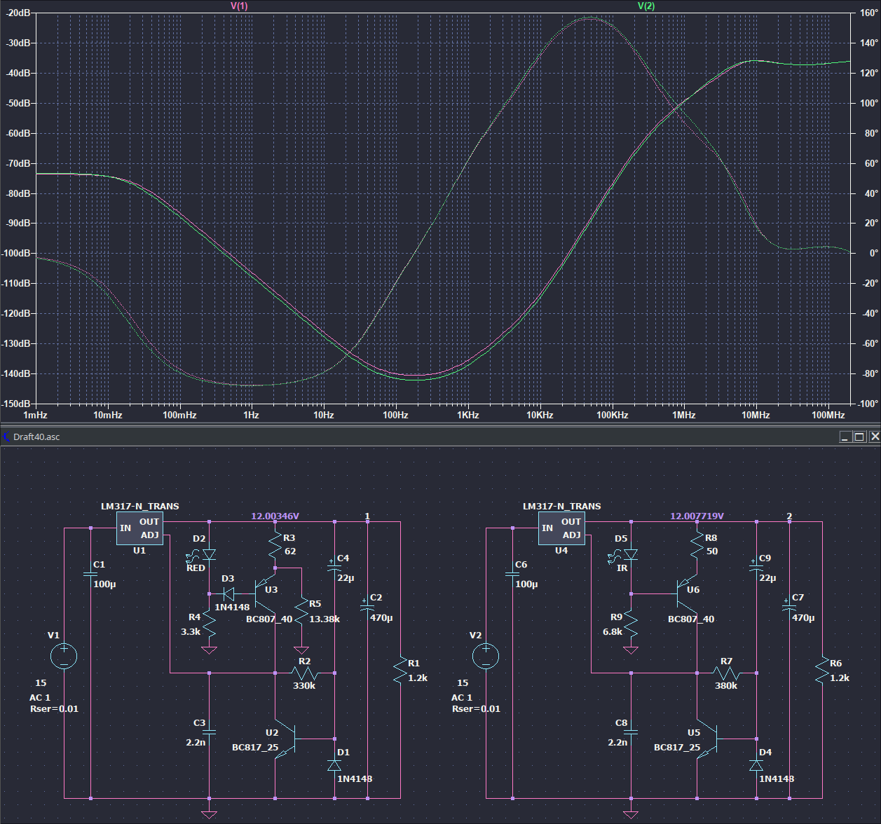

Actually D5 subtracts from D4, which means I can use a red LED with a 1N4148 to base of BJT, which is the same stage from my discrete supply, which means it should be able to be compensated with low current. This gets rid of the IR LED and replaces it with a red one. I must test this.
Ok this works so so good! I got it in the 20-30mV range 30C-75C. The resistor value came out at 13.38Kohm which means 0.85mA going through it and 9.4mA going in denoiser BJT.
Red LED works fine, DC checks out. I guess red LED can be installed in previous CCS versions, the AC coupled ones, with the same 1N4148 diode trick. It drops some of the LED Vf raising CCS BJT base so it makes a sort of virtual IR LED as Vf. But also cancels out a good bit of overall negative tempco of the circuit, so the compensation trimming is very light.
It all came together quite nice, pretty sure this is the final version of my take on Elvee's Denoisator circuit:
AC performance doesn't seem affected, much.
But could bring it back to original levels with a 2.2uF between Vout and base of CCS BJT.
