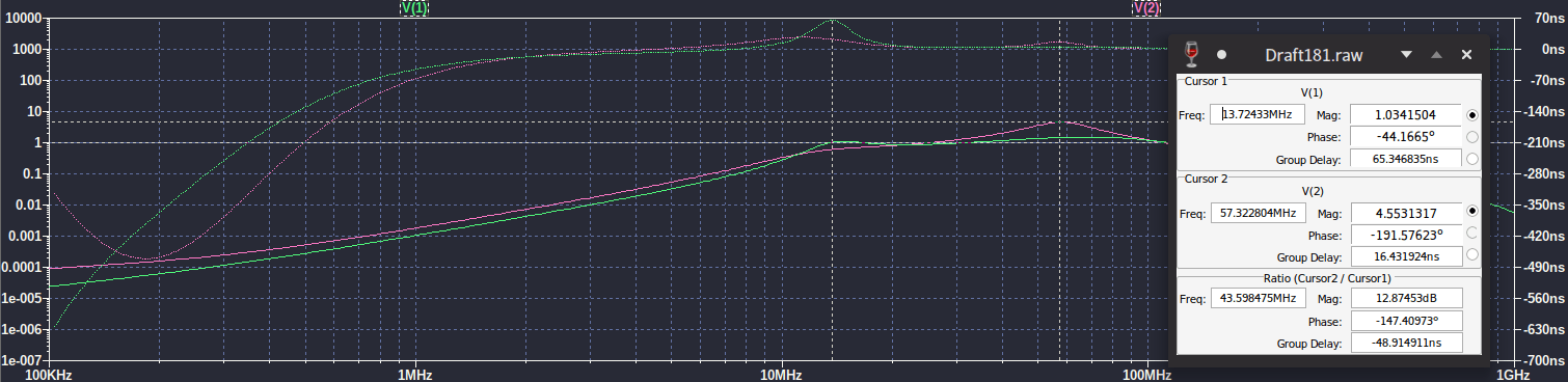

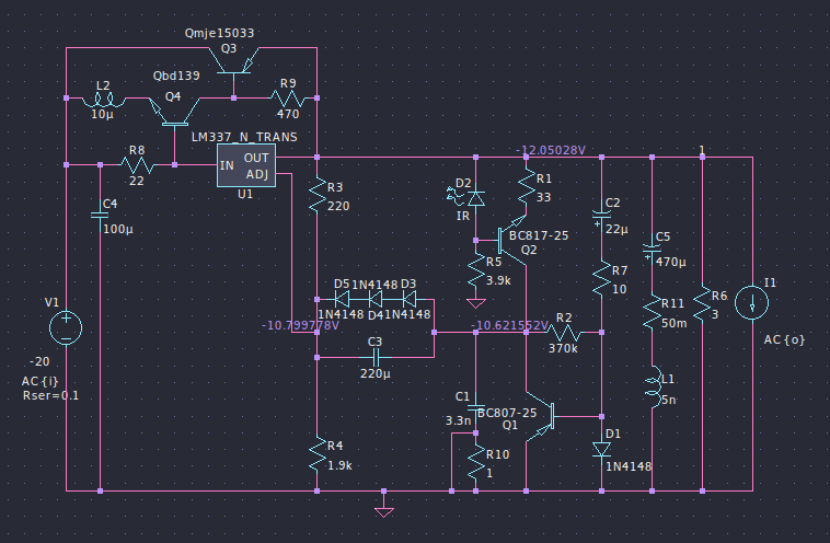

And I tried adding 10uH on the emitter of Q4.
Seems to be working somewhat. I used MJE15033 as pass transistor, figured it's a 8A part and would allow more than the stock 1.5A of LM337. BD139/MJE15033 spice models are from Onsemi's website.
I might try to build and measure it since I have MJE15033. Circuit named 1 is for 4A load and 2 is for 25mA.
edit: also L2 has ~40mA going through it at 4Aout.

In reality, it could work -or not- : I can tell you that I tried tried all the tricks of the book to make it work, because opting for a different solution would have been difficult.
In the end, I made it to work -just- .
If a Xnoiser is added, it will further complicate matters, and it will probably be impossible to stabilize.
There is no certitude of course, and only a real-world test can bring a definitive answer, but I am rather pessimistic

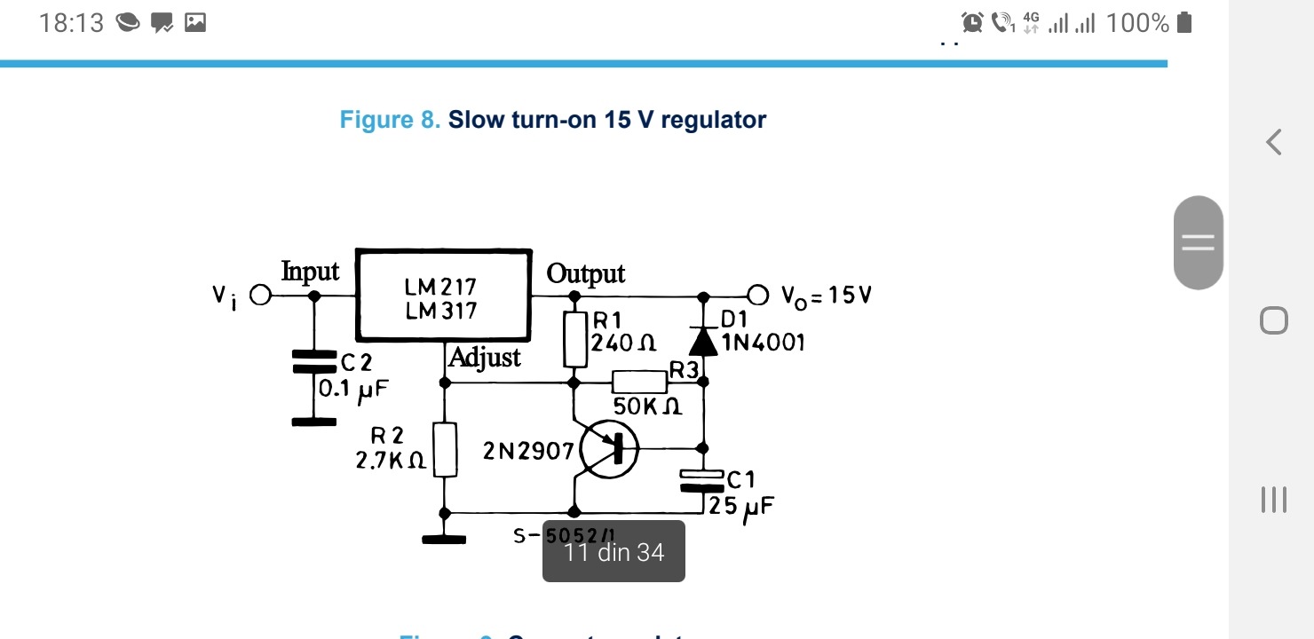

Yet the bias of q17 prevents any current being drawn through q17 when the output voltage is too low.At 1.2v output , about 6.4uA is available for biasing the q17 base, but the circuit needs to get at 1.2v output in the first place in a stable manner...Maybe it does with no fast sagging load...I see the circuit stable once it reaches at least 5v output with a fast sagging load. Then lm317 needs to release enough current for boosting trz base..maybe the transistor's leakage help 🙂If you remove the 2K7 completely and use a reference voltage, a battery or similar to GND, it will work perfectly.
In fact, the 2K7 could be removed completely, but the variations of the Adj current would slightly influence the Vbe of the transistor; the current through the 2K7 swamps the variations completely, because the dynamic resistance of the BE junction is much lower than the recommended 240ohm of the DS with the set current
It works in closed-loop: Q17 is just an element in the loop, and as long as the parameters are workable, Q17 will be biased properly.
If there is an incident, like an output short, the conditions will not be met but there is no way to sustain a normal output voltage in those conditions anyway
Ok...so the short by itself will prevent lm317 delivering any current...so it works by accident 🙂 The way I see it is that apart from your own d'noiser, no other circuit is really using the lm317 chip...so I'd replace it with something cheaper...like tlv431...

For 6.3Vout and with the current boost circuit it would look something like the attached photo. It's at ~4Aout. But the current boost + denoiser circuit is completely untested.

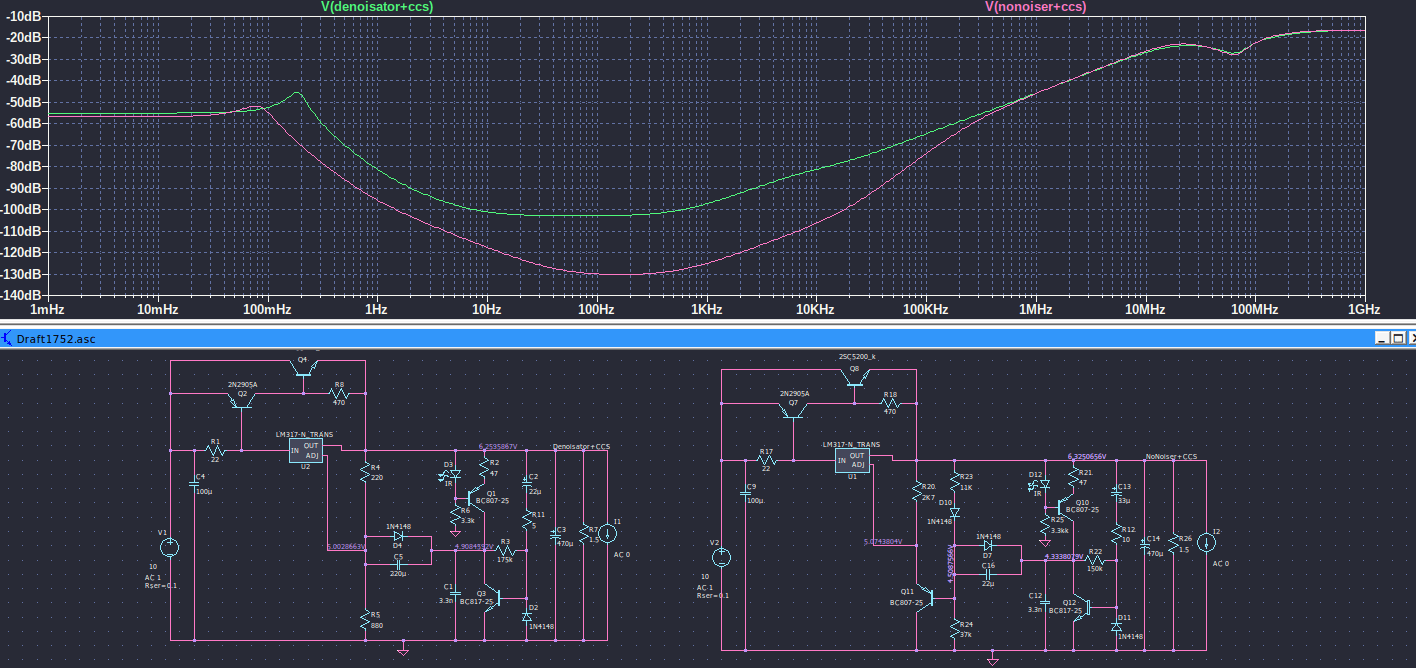

Depending on the current you could use a LM338+CCS Denoisator/NoNoiser. It worked fine in my tests. It is a 5A rated part after all.
