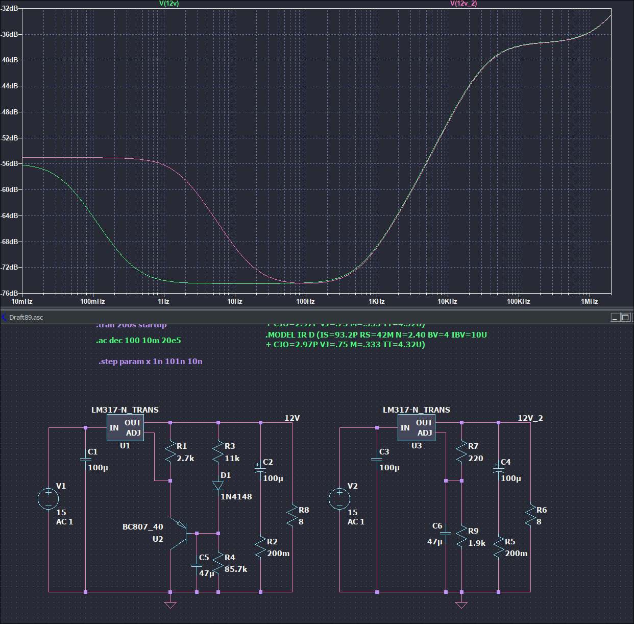

It doesn't bring anything compared to stock application with R1/R2. It does seem to offer more LF PSRR with a bypass cap though. But that is also valid with higher value R1 (2.7K-3.3K).
Then I will use it with no denoisator.
There might be a middle term: you can blunt the denoisator by reducing the gain of the correction. The simplest way to do it would be the addition of an emitter resistor to the transistor.
If the correction is reduced from 30dB to 15~20dB, it will still make useful job, but it should be more stable.
I didn't test it, but it should be done in the real world, because sims are useless for this kind of tweak.
Start with 150 ohm, and see what happens

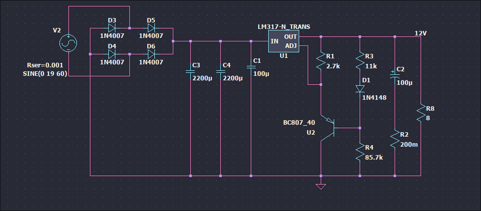

L1 most likely won't be required, but footprint might be useful to correct C4 ESR in case you have only low ESR caps. C4 should be around 0.2R ESR. You can also use 100uF-470uF depending on what you can find with that ESR, but have at least 100uF.
You could also add a 22uF-47uF cap between your TP1 and GND for some extra PSRR.
If you want the full 1.5Aout of LM317 you need around 13.5-14VAC transformer secondary voltage, and at least 2200uF for each C1 and C2 in your schematic. Bridge should also be up to par. Bellow schematic is for 12Vout.
I'm going to substitute in BC327 to keep it THT.
The same trick can be used with dantwomey's regulator?
Pity it can't be seen on LTspice sim. How will this modified circuit, with the emitter resistor, show it's stable?
