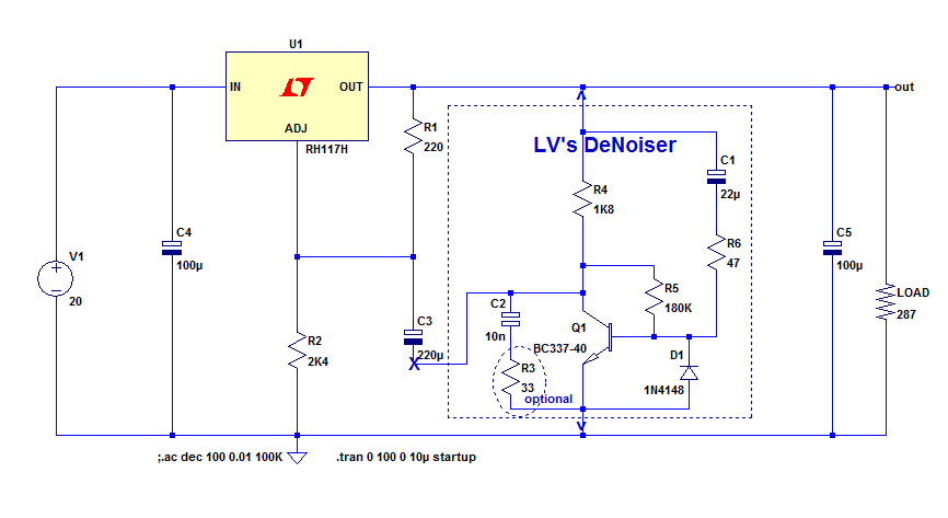

I think I have seen something similar in the past but can't remember exactly where.

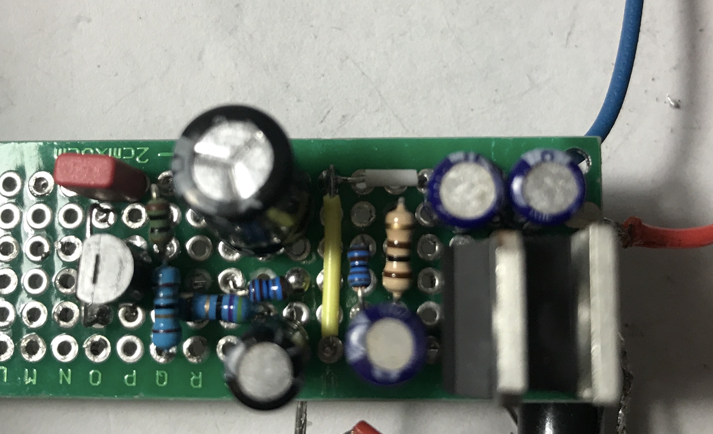

Anyway, I just put together the 1 transistor circuit and got good results - 30dB lower noise (5Hz - 20kHz) but the transition response is not impressive, which means a constant very slow oscillation in the real world, approximately 0.5uV per 1mA output current.
Has anyone encountered a similar behavior or it's just my layout.
Do you mean a real VLF oscillation, or simply noise?
VLF oscillation can occur if the ratio of the coupling capacitors (220µ & 22µ) is significantly smaller than ~10.
The HF limit of the correction is determined by the compensation cap: the larger, the lower
Thanks for the prompt and helpful reply!!!
In attempt to improve he transient response and overshooting I reduced the capacitance of the input capacitor. Maybe that was the reason for the very low frequency oscillation (1-2Hz).
I did't read the whole tread and I used the circuit in the opening post. Is that the final design?
Thanks again
The first diagram is OK, but the final, recommended version is this one:
778618d1567280403-noizator-magic-active-noise-canceller-retrofit-upgrade-317-based-reg-denoiserd5-png
For a regular 317, R3 should be zero.
In principle, reducing C1 should increase the stability and reduce the overshoot, but I didn't test extreme values.
I recommend you start with the nominal values, and once everything works as expected, you can begin to tweak, to improve your preferred aspects.

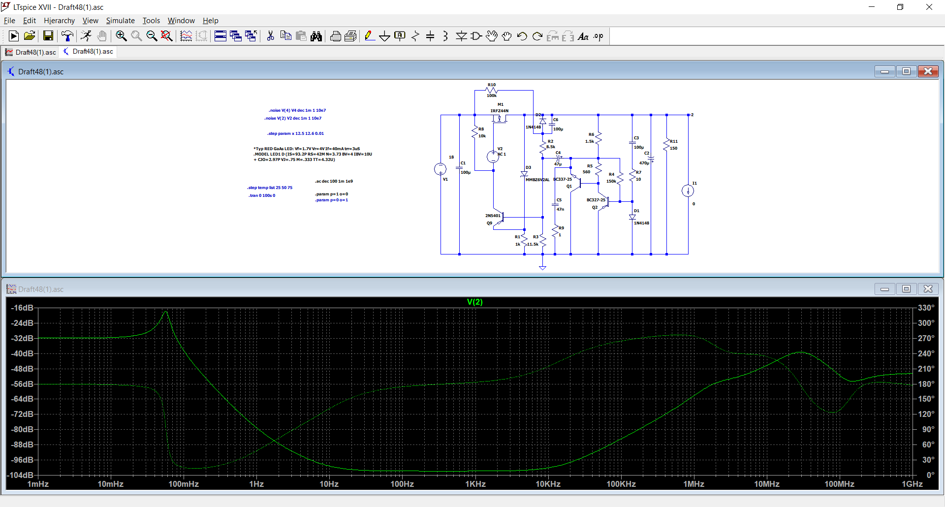

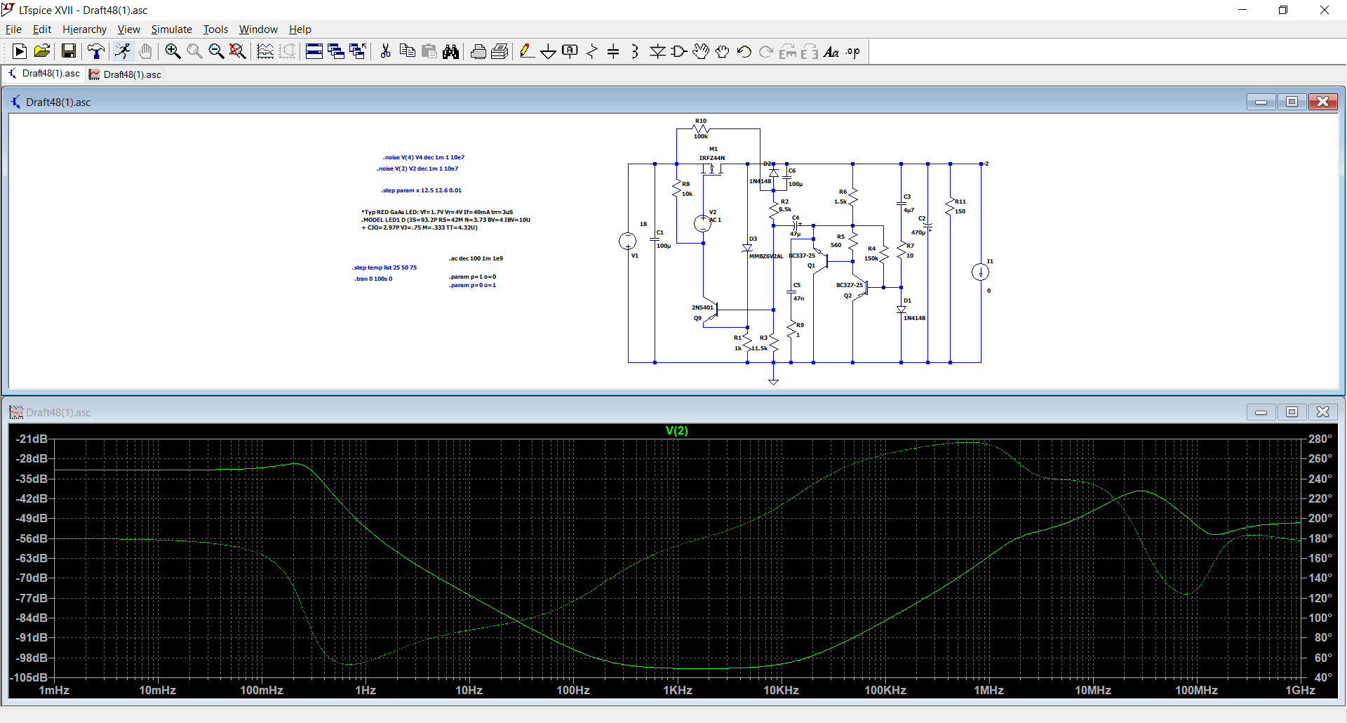

The simplest way to evaluate possible issues is to test several configurations in LTspice, with the stimulus somewhere inside the loop.
If you see a strong peak appear in the FR, you know that you have to dig a little deeper.
For the denoiser, I have adopted a tradeoff: I wanted a cutoff frequency below the audio range, but I didn't want the second capacitor to be larger than 220µF, as it would be too bulky. This resulted in a VLF bump and a bit of overshoot, but it remains acceptable
This is the behaviour of an example, unmodified:
attachment.php
There is a strong (almost 16dB) peak in the VLF range.
attachment.php
With the value of the first cap reduced, the peak is almost gone:

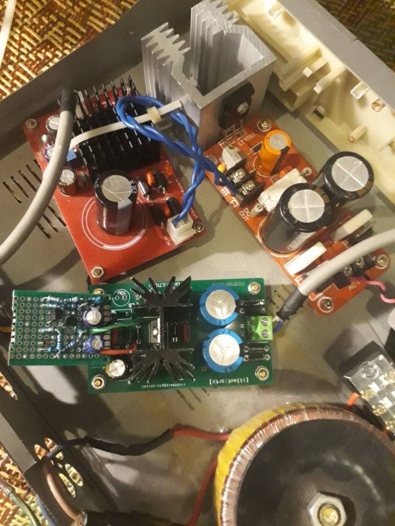

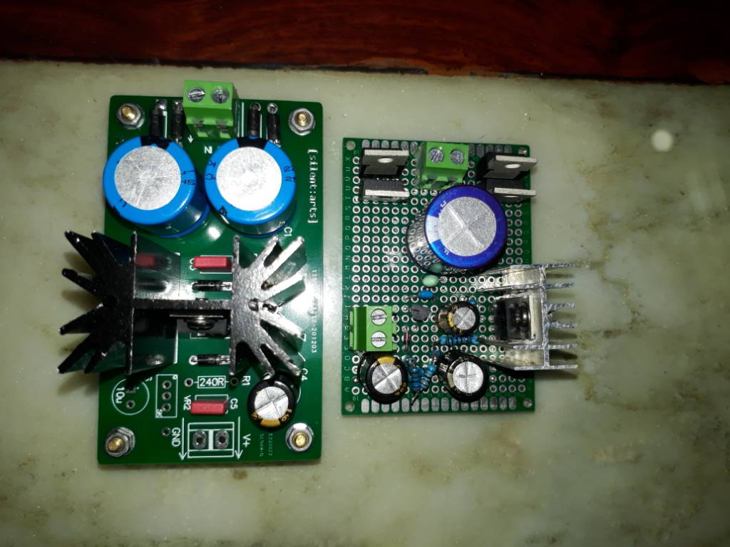

Hi guys,
As I said in my first post I like very much the idea behind the d-noizator and the implementation as well.
For the purpose of the design - retrofitting power supplies based on LM317, it is maybe the best solution (when carefully implemented).
I put together the circuit and found out some minor details that would not fit my goals - very low frequency partial instability, transient response, overshooting, little bit insufficient PSRR. At the end of the day all these results in a fluctuation of Vin-Vout voltage.
SO lets limit that fluctuation. I gave a try to a very old trick - Tracking Preregulator. In that particular circuit the first regulator limits Vin-Vout voltage of the second regulator in very tight boundaries. As a result of that all mentioned before small issues could be partially or fully overcome.
After some quick measurements I liked the result very much - noise bellow 0.5uV (5Hz-20kHz, Iout 0-200mA), PSSR went down with another 25dB, no low frequency instability, better transient response.
Hopefully somebody will put together that simple circuit (it took me 30 minutes) and confirm my findings.

Good it solved your problems, but here the prereg can only improve one thing: the PSRR.
It is not going to improve noise, output impedance or transient response, as only the denoiser affects them, and it is certainly not capable of eliminating instabilites (if they are actually present)

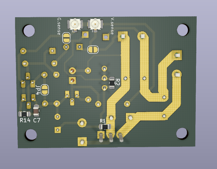

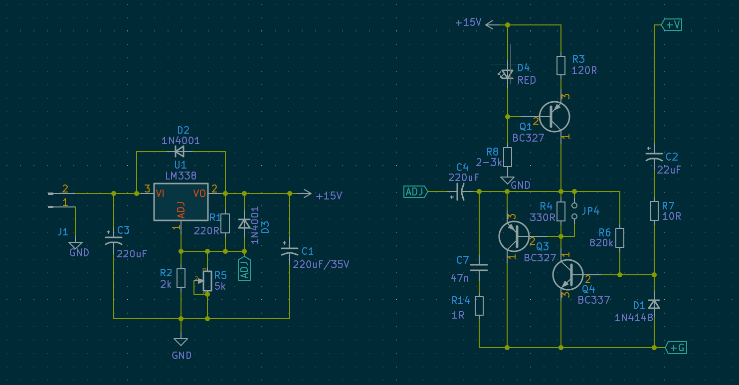

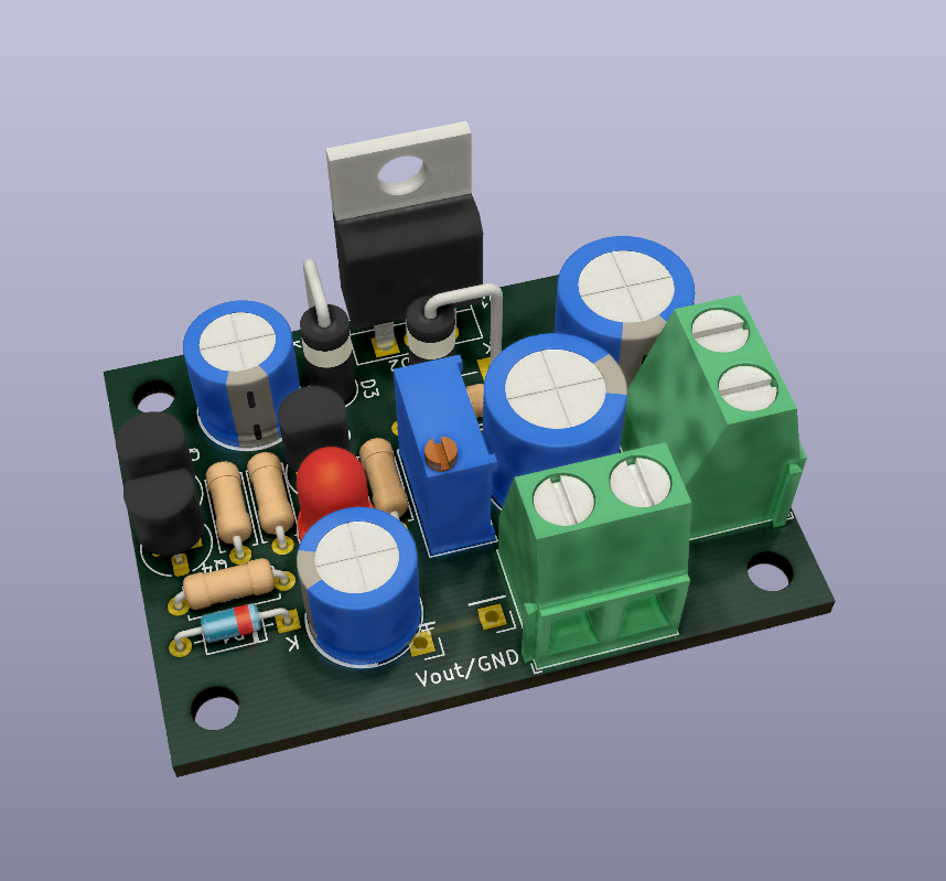

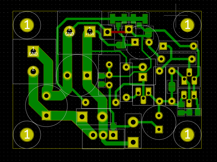

I built a LM338 board that also has the ccs option. I only tested it at 100mA out but I plan on testing it at around 4.5A.
At 100mA the PSRR at 100Hz is at around -138dB. Noise level seems to be around 645pV/√Hz (without LNA's noise). I used ZTX851/BC327 for the dienoiser and BC327 for the CCS. Needs a regular 5mm red led. The dienoiser current was set at around 9mA, with around 3-4mA through the LED. Increasing the dienoiser current makes for worse results, the LM338 doesn't seem to like more. 120R seems like a good value.
Compensation was 47n/1R. Output cap I used Elna RJH 120uF/35V, just because I had it and measured around 0.2R for impedance.
The board is to be used with DC input only. This way, especially for higher output current, you can have a separate rectification/filtering board. Board size is about 48mm x 35mm. Can be diyed.
I'll post measurements after I get to test it at 4.5Aout.
edit: voltage setting resistors are 0805 footprint, compensation network as well.
