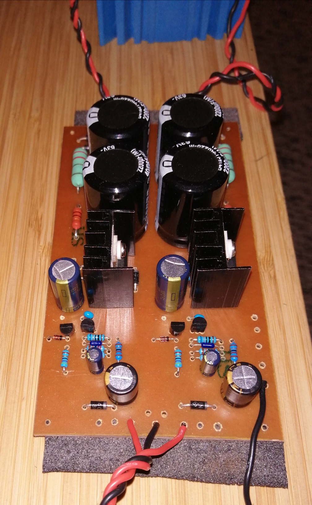

I made a fresh dual 317 15v supply board with dienoiser. bc3X7 40, and 22nf ceramic comp cap with no extra R. It is stable (not so with 337 on previous test riser boards, various comp configs).
The Denoiser is a huge benefit and more flexible.
Dienoiser is sonically slightly 'cleaner' sounding, different, needs to be on same pcb as regs.
I would be happy with either on a wet sunday.
I had voltage overshoot +3->6% with both circuits on riser boards and practically none with nice layouts on same pcb with similar components. Will try 10uf on riser boards, thanks!
What output cap did you use for LM337?

Tried Panasonic fc, fr, Nichicon pw, TK jovial for output caps. Fc caps were 47, 100, 220uf. The others were 100uf.
Tried x7r, then poly comp capacitor. All resistors 1% metal film.
The dual LM317 board above has some Nichicon kz 47uf.

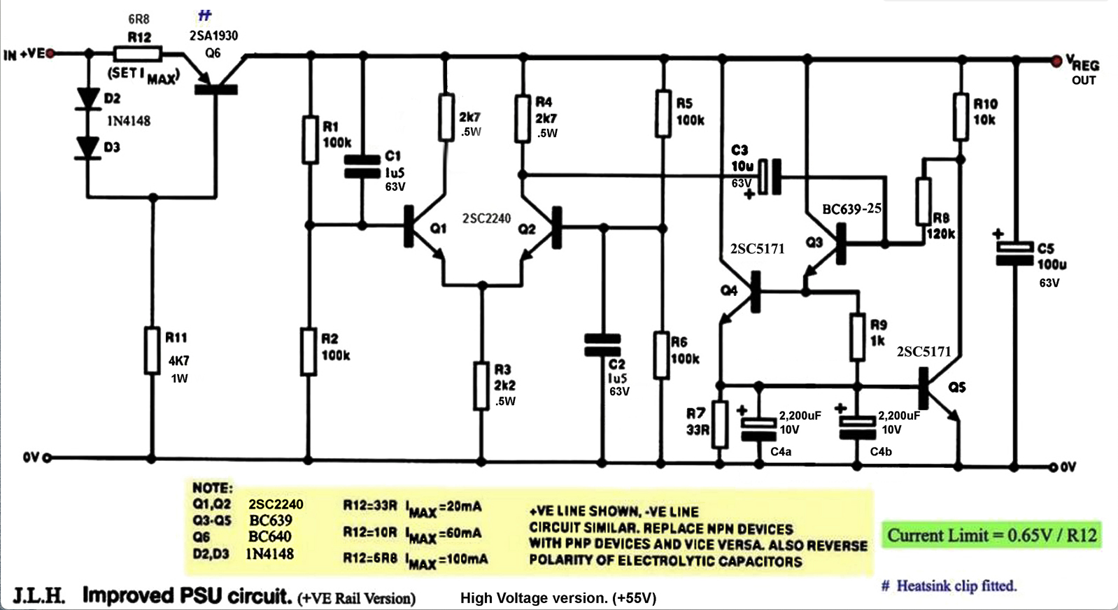

Amusing schematic found here. Click on the image to see it full size and undistorted.
Many JLH Ripple Eater users report audible improvements when using this circuit in their power supply chain.
How does it work?
The circuit consists of two parts: a ‘ripple detector’ arrangement based on a long-tailed pair, and a constant current source. Any ripple voltage present across the supply line can modulate this current. The aim being that if the output voltage were to momentarily increase or decrease, the current drawn would automatically increase or decrease to oppose these output voltage fluctuations. The impedance of the circuit depends on the size of the capacitors used – particularly that of C4, which can be large since it only needs to be 1V working. With the values chosen in this iteration, the circuit generates the electronic equivalent of about half a Farad or more.
It’s also been observed “In essence it is an AC feedback loop”.
The original article contained a full circuit and application description, some of which I have paraphrased here. JLH also provided explanatory diagrams, a schematic

The LM337 dienoiser was stable for me using a Panasonic FR 470uF/25V. It's not about the capacitance value, rather ESR and ESL. Around 40-50mOhm. There's two types of FR caps in that value (470uF/25V), I used the taller/thinner one. Also try some 3.3R/47nF for comp.
I don't get it, there's no feedback to the pass transistor. And the rest of the circuit is just a load.

The circuit is similar to the "Finesse" circuit example I gave at the start of the thread. It is in fact a shunt regulator, but without a fixed voltage reference value.I don't get it, there's no feedback to the pass transistor. And the rest of the circuit is just a load.
It is the shunt version of the more usual series cap-mult/gyrator ripple-eater.
Not very efficient or convenient.
Ah yes, completely missed R12 at first glance.
