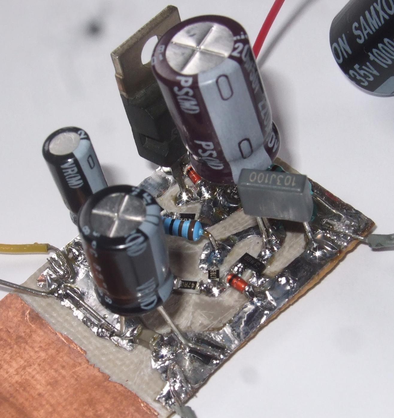

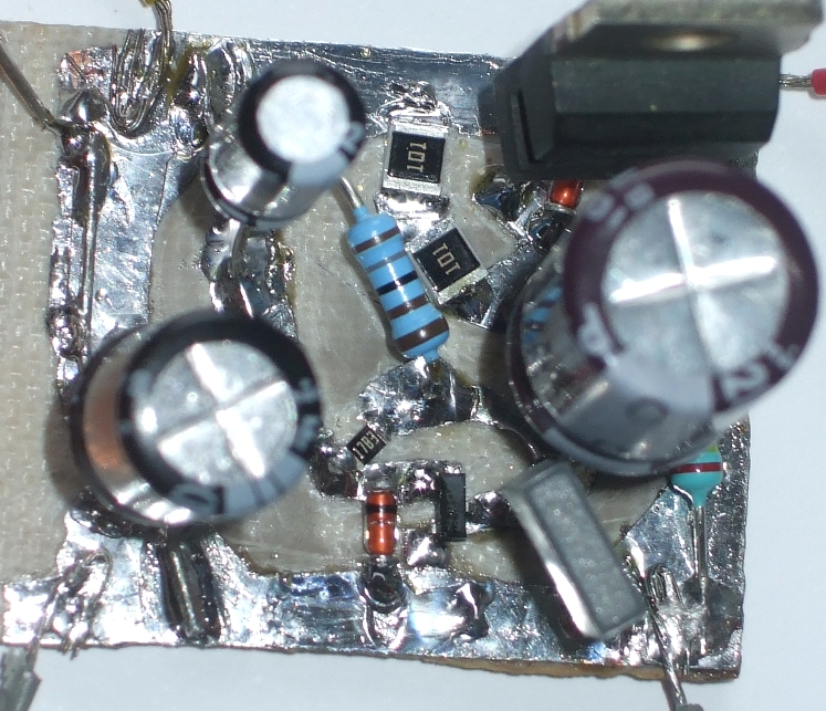

Ok , at last ... my experience with LV's DeNoiser.
Finally my components arrived and I could start testing. 2 x 15 V transformer 7,5 VA , just rectify and a 1000µF cap : 240mV rimple at around 115 mA load , with 4700µF , it went down to 55mV... still too much . So and CRC with 12 ohm after the 4700µ and a 1000µ : rimple 7mV.
7mV rimple is loud in a HP.
Standard LM317 + Cadj 22µF , and far below 1 mV ... steady 000mV om my Fluke DVM. Having no measuring equipment , I use the unscientific method of my ears. Put a 100µ Cap on the 15 V output , discharched it and connected the headphone ... nothing to hear.
(btw : if you do this you may fry your HP if there is a DC difference between the Cap and the 0. So use "disposable" HP's ! )
As a side note : I made white noise in Audacity 96khz 32 bit , full on 0 dB , then attenuated it to -80 dB and with volume on max this is clearly audible, even at -90 dB , -95 dB was my limiet that I could hear. In a fully quiet room -100 dB was not audible , but it could be the limits of my laptop's audio chips. These have +-2 V max output ( 4Vpp) , so 100 dB = 40 µVpp = 7µVrms is not audible . The Denoiser is 0,33µVrms ... according to LV.
Now LV's DeNoiser :
Again nothing with the headphones , no surprise there. I did see the start up , it takes about 23 sec to get full stability on the right voltage after meandering above and below the 15 V output.
But to all this there is a cost : I thought LV said something about that it consumes as much as the regulator LM317 , and I took that as : the whole circuit consumes the same , my mistake . It actually doubles the whole regulators working current . :mad:Running without load goes from 6 mA to 12 mA (because I didn't have 220 ohm , I put 2 x 100 ohm , so for 220 ohm it wil be slightly less , 11 mA or so). It gets worse , because of the base current of the LM's output transistor , this goes to about 17 mA with a 100 mA load ...! Quite a lot . (not the DeNoiser's fault of course) . I wanted to use 4 of them ... + & -15 V and L & R , that's 70 mA just for the regulators ! (at 100 mA out)
Remember a lot of posts ago , I said those expensive low noise LDO's from T.I and LT would be redundent for audio with LV's DeNoiser, well they weren't . Not just low drop but also lower quiescent current than the LM317 + DeNoiser.
6 mA more is not dramatic , of course . But the transformer I just bought ( 2 x 15 V) , gives me 21,5 V at 100 mA out ! So I get it from both sides , higher current , and around 6 or 7 V over the LM317/337 (depending on the 10 ohm R in the CRC) , so with 17 mA extra over an 100mA output current , that's > 700 mW .... so no cute DPAK for me , but a cooled TO220. Yes I could put some diodes in there to lower the voltage or even a Capacitance multiplier .
I don't know why the transformer gives me 21,5 V /side at 100 mA , maybe order an 2 x 12 V one ? I first put the 1N5822 Schottky's as rectifiers , they only go to 40 V ...they got around 50 with no load ... they didn't break though....:eek:
While lower noise is great , the question is : if I can't hear it the LM317/337 + C adj , is it worth another 6-7 mA for the DeNoiser ?
What was a (welcome) sure thing for my upcoming HP amp , I'm not sure now if I'm going to use it. Maybe I should test out the expensive and for me hard to get T.I and L.T's , although with 6 V to waste , a low drop regulator is stupid. Or I could just stay with the standard LM +Cadj.
Some numbers : with Vout = 15 V , transistor's collector 4,55 V , base 630 mV , both not changing with load.

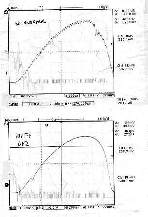

That's why Elektor put 10nF over the rectify diodes. After the CRC filter there is only a small 100 hz hum.
No, that is not why Elektor put 10nF caps over the rectifiers.
Their purpose is to damp the ringing which arises from the leakage inductance and the capacitance of the rectifiers.
If you don't see ringing when looking at the rectified output of the power supply with an oscilloscope, they aren't necessary. (Pic below is an extreme example.)

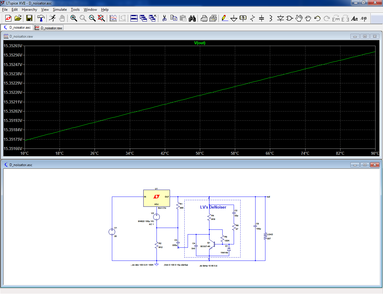

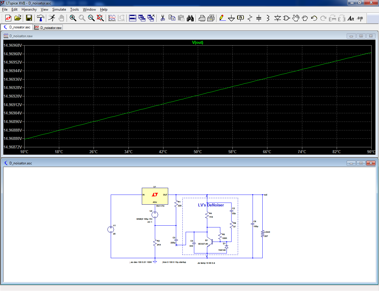

Here are the sims you asked for: first, the temperature stability of the initial circuit:
attachment.php
It looks rather optimistic, in particular the parabolic T° dependence does not seem to be modelled.
Anyway, here is the the modified circuit in the same conditions (I also changed the collector load, even though it has no effect):
attachment.php
As you can see, the difference is anecdotal, but the reality is probably somewhat different (though not much worse)

Thanks LV. You took it one step further with 680 & 6k8 , so around 3,3 mA instead of the 11-ish of the original. Battery operated devices will be pleased . I wasn't worried of the tempco of the DeNoiser , it doesn't matter much with regulators for audio amps . And even with 680 ohm , line and load regulation will not suffer much especially with loads up to only 200 mA , not the 1,5 A as specified maximum current of the LM317/337.
Most interesting will be whether there is a change in noise reduction between the normal version and the low quiescent current one.

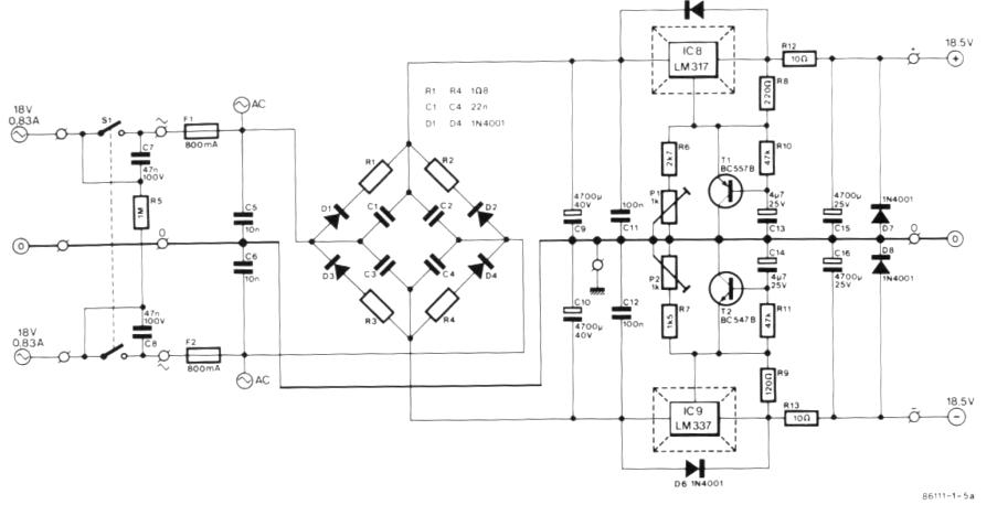

"I doubt you could hear any rattling directly" .
Well I did hear some very faint rattling , but it was gone after the CRC so now I'm not sure if I'm going to use the 22nF I already bought to put over the diodes. I use ultra fast diodes , just because I can and they're cheap.
Here's one from Elektor 86 's preamp, I think . Notice the big 4700uF cap after the LM. I could be wrong but I still trust Elektor more than some on a forum.
In fact no, the screenshot from LTspice distorts the figures, and I used your 6K2/560 values (but it does not really matter).
If the collector load is also changed, the base 180K should of course be scaled ~accordingly (and also the cap values)
The differences will be very minor
It depends on the definition of "rattling": the sawtooth of the ripple has a significant harmonic content, but does it qualify?
