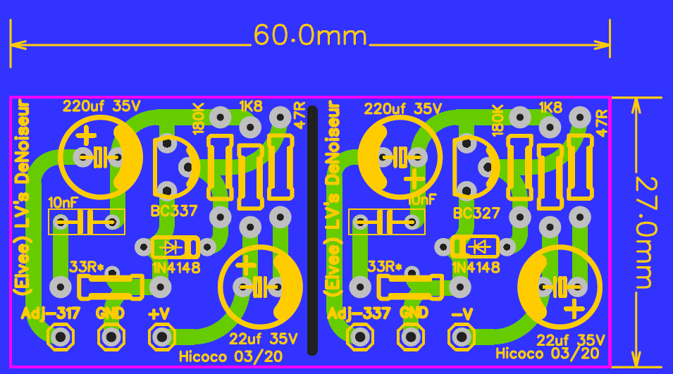

As I am working on a easier way to build the Denoise and Diego's version, I'm thinking of building that simple mod into the board.
It would demand desoldering one more resistor from the original regulator, when connecting the pcbs, but with potential improvements, I think.
That improvement is shown in TNT's article, thought I doubt it will show in any simulation.
Comments are welcome.
The important thing is to connect the denoiser as close as possible to the output. This means the input cap and GND (emitter).
Moving the DC voltage setting resistor to the same point could improve very marginally the DC load regulation if the original layout is lousy, but on the + side, the problem is similar and there is nothing you can do: the resistor has to be connected as close as possible to the regulator, not the load, which will generally be the case

822298d1583342494t-noizator-magic-active-noise-canceller-retrofit-upgrade-317-based-reg-pcb-noiser-single-layer-version2-png

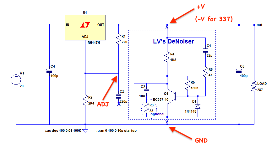

Hi Dotneck,
What 33R resistor is that you're using in series with 10n?
I don't have any resistor like that on my schematic.
Joined 2011
The 33R gives a pleasant little boost to the phase margin of the negative feedback control system. Elvee described it a few months ago. If you're experimenting with the circuit in software simulation, ".STEP" that resistor's value from 0.33R to 33R (2 decades), at 6 points per decade. Aha! There it is.
Start searching beginning with post #400 or thereabouts, and scan through the messages, 50 messages per screen, looking at the attachments. You'll find it quickly enough.
_
Exactly, but it is mostly suited to other, more "nervous" regulators.
For a regular 317, making it 0 is probably preferable.
The 337 is a shade less placid and can benefit from it.
For most other types, I didn't make actual, physical tests, and I cannot give definitive advices

I take the opportunity to rectify one or two mistakes:
828551d1585426367-noizator-magic-active-noise-canceller-retrofit-upgrade-317-based-reg-dienfix-png
C5 needs to be reversed
R3 should be returned to the collector of Q2 to increase the Vce
R3 could be larger than 180K for the same reason
A compensation cap is required, as for other versions; a few nF is sufficient. 10nF is safe.
