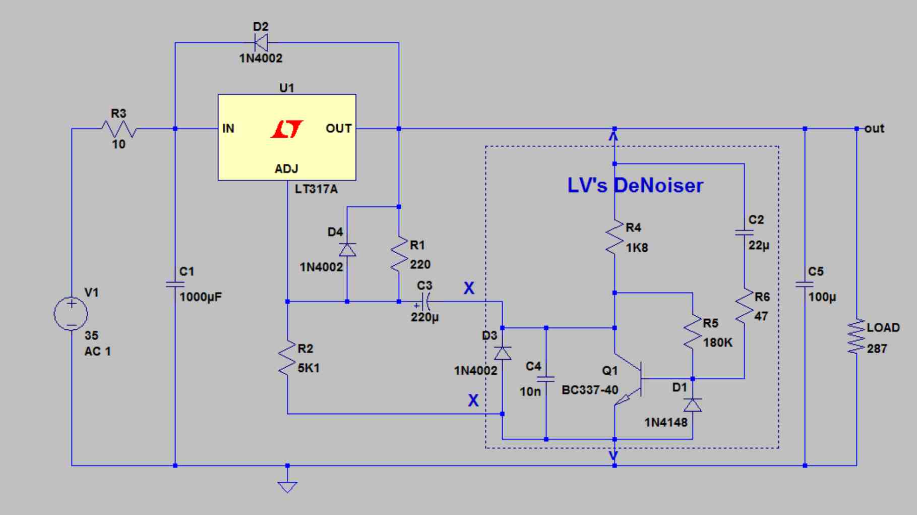

I intend to use an LM317 denoiser for a tube preamp heater supply.
2x 6SN7 in series for 12vdc at max 650mA.

I can see 2 arguments here:
a) This is a costly and inefficient way to go about maximising performance.
This rapidly becomes evident when considering the cost of the 10000uF caps which become necessary.
b) I am aspiring to a level of performance unnecessary for a heater supply.
Where is the line here?
Is there any point using a denoiser at all for a heater supply or would a simple rig with an LT1086 be more than sufficient?
Precede the LM317+denoiser with an LDO. Remove as much yecch and crudd and mains-ripple as you can, so the denoiser has less work to do. This one only needs 0.5V from in to out, only costs USD 1.96, and is rated for 1 ampere maximum.

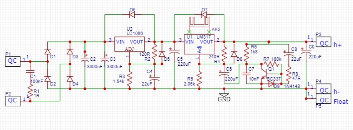

If I was to take Mark Johnson's suggestion of a regulator before the denoiser for additional filtering, and use a reg I have on hand such as the LD1086 (also, the datasheet on that BD00C0AW doesn't clearly explain to me what to do with the ctrl pin no matter how much I stare), I might come up with something like this:
Is there any reason why this wouldn't work or is particularly stupid?

If the BD00C0AW voltage regulator IC is too complicated/confusing, and if the LT1086 is too expensive at NZD 10.50 ...
Then perhaps a simple capacitance multiplier might be a cheap and simplistic compromise, to serve as a pre-filter before a deNoiser. A well designed C.M. will reduce the mains ripple by 20-45 dB and improve PSRR throughout the audio band. If you decide to build it for OTHER tube heaters which require quite a lot more than 1 ampere, that's quite easy to achieve. And if you decide to build it for 650mA, that's a little easier. Depending on the design style used, a capacitance multiplier can achieve an input-to-output voltage less than 1 volt, which appears to be quite acceptable since that's the datasheet spec of the LT1086. If you dare to employ depletion mode MOSFETs in the C.M., even less.
It will definitely work, it is not stupid, but it depends on what you mean at "work". There are several ways through which noise goes inside a tube amplifier, and heater noise (differential type noise) is only one of them. There is common mode noise too. So I want to warn you and to repeat Elvee quote:Is there any reason why this wouldn't work or is particularly stupid?

Why not in your particular case: if it is cheaper, has higher performance and the dropout and added complexity is tolerableAssuming the lower dropout is not a necessity which it my case it is not. A denoiser costs something like NZ$5 compared to NZ$10.5 for an LT1086 from Mouser. The denoiser seems to offer lower cost than the LT1086 and higher performance.
Ctrl is the ON/OFF switch: H to activate the output. it is TTL compatible, but you can just tie it to any convenient positive sourceIf I was to take Mark Johnson's suggestion of a regulator before the denoiser for additional filtering, and use a reg I have on hand such as the LD1086 (also, the datasheet on that BD00C0AW doesn't clearly explain to me what to do with the ctrl pin no matter how much I stare), I might come up with something like this:
It should work, even if the complexity is unnecessaryView attachment 841892

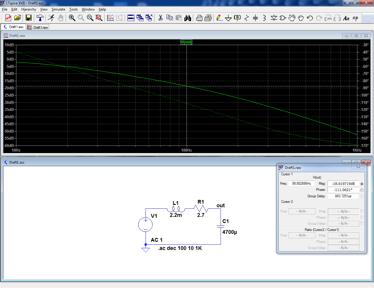

I have a question to ask if I want to try a low pass filter before the regulator. In fact, the use of an appropriate LC filter had previously been mentioned for better ripple (noise) rejection. So why not maybe an RLC (series)?
With the [FONT=MathJax_Math] ζ[/FONT] > 1 (overdamped) there would be no risk of having the peak that falls in the 10^2 range, producing a bad ripple effect. R also should be low for not too much voltage drop. So I calculated something like this:
R= 2.7 ohm, L= 2.2 mH and C= 4700 uF
With these values [FONT=MathJax_Math]ζ[/FONT] = 2, ωo = 300 Hz and fc = 50 Hz. It seems to me a good point, how about it?

Well, if i would go this way and sometimes i do(with RC filtering for tube projects) i try calculate RLC parts so fc is under 20Hz to put it out of audio range. Yes i know that for low voltage applications is a bit tricky and costly and maybe not needed for denoiser but what the hell, if you think then think big.
It gives you a rejection of a little under 20dB at 100Hz:I have a question to ask if I want to try a low pass filter before the regulator. In fact, the use of an appropriate LC filter had previously been mentioned for better ripple (noise) rejection. So why not maybe an RLC (series)?
If you really need that little boost, why not?
Thanks for simulation Elvee, as Khadgar suggests maybe I could go down for fc increasing L. At this point it would become not so cheap though, especially with rather high I(max) on L
