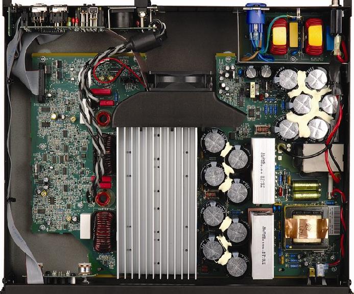

BTW: I am happy with my Half Bridge amp with +/-180VDC rails.....with less than 40mV DC offset at output. Have you seen QSC PL8KW .........its Half-Bridge with rails touching almost +/-200VDC

Ok then one nice question for you regarding floating Bridge.....
As far as i know in this topology there is single supply capacitor and the rails are floating. you can place a ground plane over the short length rail tracks or similar thing canbe done to reduce EMI, but the Filter cap's body is internally connected to negative rail , in your case its floating , wouldnot it will generate a good source of EMI then....
or i am lacking or missing something important.....

fredos said:Ground referenced bridge output should be grounded after differential output coil...So floating DC do not have any HF component..Or at least just a little...You should only have a ''pure'' DC floating PSU!

I have seen a Rockford Fosgate Floating Bridge Class-D 1500W amp, whose rail filter capacitors were worst generators of EMI
fredos said:No I did'nt see the 8KW qsc schematics...You have it?

Not schematics, i have access to that amp.......
