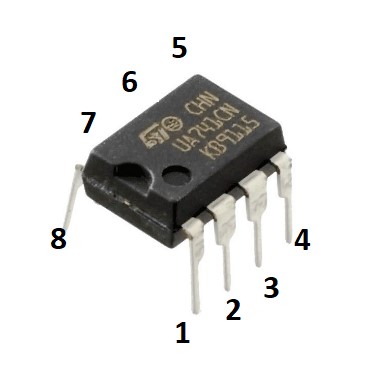

Re your post 33, the 18 volts will show up on pin 8 of dual and 7 of
single op amps and -18 on pin 4. Pin numbering was clear as far as
I can see.

Be absolutely certain you are measuring the pins correctly. All have this configuration:

the pic you put up regarding the leg numbers of the op amps was very helpful ,
