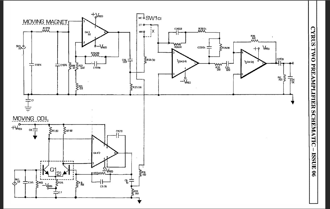

The first diagram is the actual circuit diagram for one channel. You will see the two upper sections, one called MM and and one MC. Which one of these is in use depends which inputs you are using, MM (the most common) or MC. MC has even higher gain than MM.
The output of these two circuits is selectable via the input selector switch. It connects one or the other to the following stage which is the lower one on that page and marked RIAA equalisation. That is another stage with gain.
CT will probably be 'centre or common terminal' but its not a common usage in this set up.
Now look at the next image. This is more of a block diagram than a complete circuit diagram. The output of MM and MC go to the 'end' terminals of a switch. The CT or centre terminal is the moving contact and that can select one or the other of these two stages.
The last image shows the input selector and how it selects all the different inputs. It is shown in the Phono position and the phono stage is set to MM. I've highlighted the signal path.
The balance control (shown on the last diagram) has the moving wiper of the pot connected to ground. Each end of the pot goes to the 'top' or input end of the volume control.
Notice the resistors R45 and R47. When the pot is turned to one end R47 is effectively connected to ground via the wiper. We now have R45 and R47 in series with each other and so the signal voltage at their junction (where the volume control gets its signal from) is reduced to less than half. This is why I say you should be hearing a change in level as you turn it.
With the control in the middle the volume control gets its signal via R45 and now the balance control adds its mid value setting of 50k plus R47 as an attenuating resistor... so now the signal level is equal for both channels.
Its just ohms law and a couple of resistors making an attenuator.
If you haven't a scope then you will have to begin by checking continuity from the RCA MM input to R17 on the MM input. Look at the diagrams to follow this.
Then check R15 at the MM output makes its way to R31/C19 of the RIAA section and finally that R43 connects to R45 when you select Phono.
Remember you can compare results between the two channels. The references numbers I have given may apply to the good channel anyway.

i have spent some time testing the caps and resistors in the riaa and mc and mm amps ,all seems good with no failures,i think ill pull the transistors and see if i can test them,i never trust transistors as they have given me trouble in many other things in the past,
being a twin transistor pack so to speak ,do i just test as a single transistor x2? how will i know which leg are from each transistor?
or shall i just replace both of them and be done with it?

i have taken every cap out in the whole phono stage and tested them ,tested every resistor and not found ant failed components ,i wish i had ordered the caps so i could have just replaced them as i went,but we live and learn ,
i reflowed the selector switch once i got to it and that is all ok ,i found no burnt tracks or bad solder joints,
im starting to think this one might bet me, im going to take those twin transistors out and have a go at testing them,im guessing as you would a normal one,

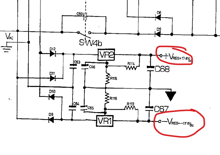

You have to be logical 🙂
Earlier you mentioned that the fault is apparent on both MM and MC inputs. So that in one go rules out the section with the dual transistor because that isn't used for the MM input.
Given that both inputs (MM and MC) appear faulty it would be a pretty safe bet to assume that actually 'neither is faulty' and the issue lies elsewhere and further along the chain.
For a fault like this you really should use an oscilloscope, it just makes it all so easy.
Without a scope and basic checks (which you have done) are that the opamp supplies are good and that all opamp output pins are close to zero volts DC.
That proves the DC conditions are basically correct.
You could try injecting a signal into the audio path if you can't get hold of a scope... or (with caution) apply a line level signal to the MM input and 'jump' the signal through the various stages with a jumper lead and see where the audio goes missing.
Removing and replacing parts in hope isn't recommended and can do more harm than good'. Always try and diagnose a fault with the minimum of intervention by measurement and diagnostics alone.

i can get a oscilloscope but i have no idea how to use it ,i have had some one try to show me once on some thing he was repairing ,but i guess i better go and see if i can learn ,
ill report back

An oscilloscope is really just a voltmeter that traces out voltage with respect to time and so allows you to look in real time at signals and their levels within the circuitry. It makes it possible to trace a signal through the circuit.
