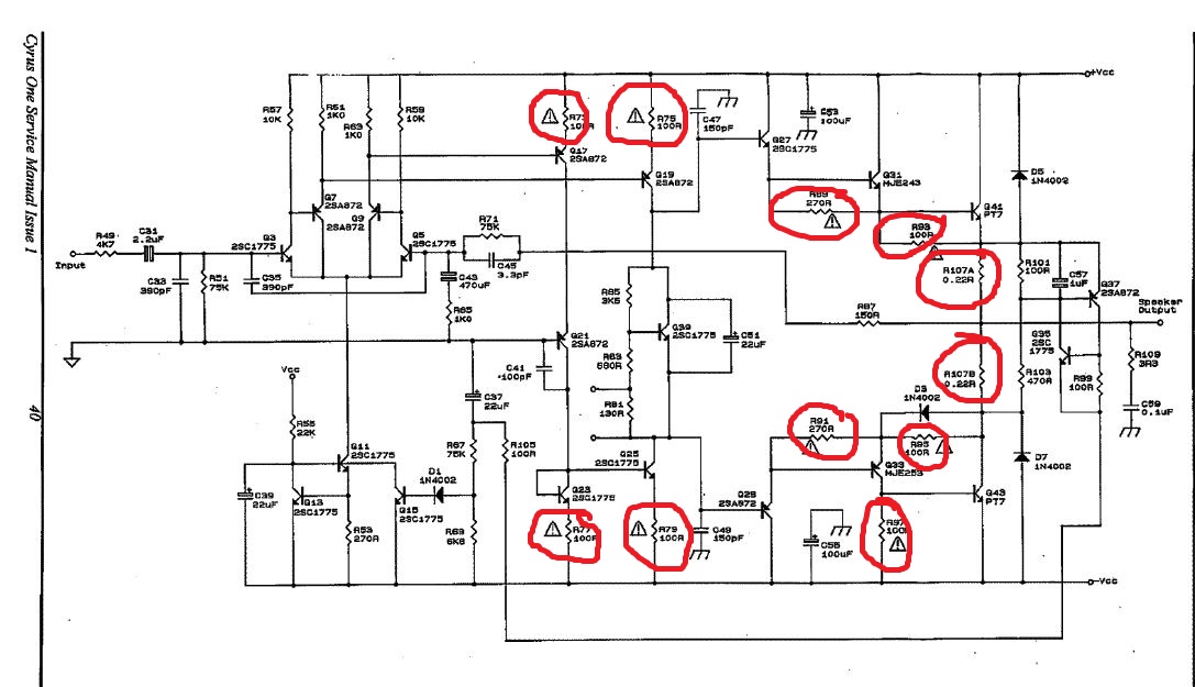

Cyrus 1 output transistor question. push-pull?
These were the resistors with exclamation mark. All low value types.

A dual 0.22 ohm can be replaced by two singles. They are just wired in series with the junction being what would be the middle leg of the original dual. The CPC ones in the link should be fine.
There is no need for any matched transistors in this amp.
The bias could be a real issue and so I would suggest ordering a 1k and 2k preset to play about with.
The drivers are the pair of transistors directly feeding the outputs, the MJE243/253 pair. BD139/140 should be fine for these. Other commonly used parts for these would be MJE340 and MJE350.
You're right unfortunately, for the cyrus one issue 07 they no longer fitted a bias adjustment. I wonder if i could add that back as I'm guessing the circuit board didn't change much. If not I think you were suggesting a work-around using preset components?
right, so, the outputs are all npn. But the drivers are one npn and one pnp ? I looked at each of the pairs you suggested. They seem to have different specs in regards to hFE , is it important to pick a device with the right hFE or is the gain decided by the circuit and all i need are drivers with sufficient headroom to cope ?

I have heard of the MJE3055T being used for replacement output transistors on the Cyrus. Cheap and readily available (CPC). BD139/BD140 for the drivers.
0.22 ohm/3watt resistors,
http://cpc.farnell.com/multicomp/mcknp03sj022ka19/resistor-wirewound-0r22-5-3ws/dp/RE07407

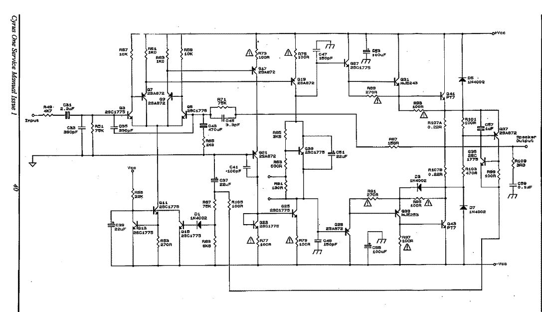

You need to check the value of all the resistors marked with an exclamation mark in the faulty channel. These are low value resistors and can be checked in circuit initially. If you don't see the reading expected then try reversing the meter leads. If it still looks wrong then lift one end and check. The shorted outputs/drivers may skew the result of some of these so remove the faulty transistors first.
The Cyrus appears to have non adjustable bias and this will be a possible issue using different non original semiconductors.
You may have to change the value of R63, a 680 ohm (hard to make the ref number out), perhaps even replacing it with a preset to give continuously variable adjustment.
Also you must use a bulb tester when working on this as it will save damage should anything go amiss.

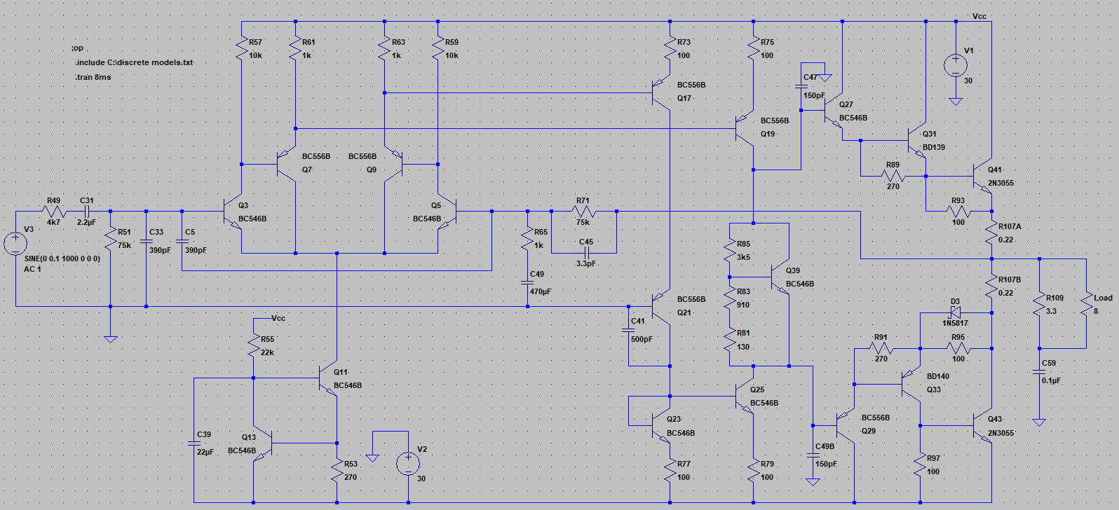

Hi, the service manual seems to suggest that the bias can be adjusted to reduce the voltage (measured at R107A & R108A) by increasing the value of R81 to 180R or if the voltage is too low, by connecting a 220R cross R81. Does that sound plausible ?
The bias current is calculated from the volt drop across either of the 0.22 ohm resistors (always with no speaker attached).
The bias adjustment is done by what is called a vbe multiplier and altering the conduction of the transistor. The network of R81 and R83 would be replaced by a preset giving total control.
The numbers in the manual are so poor (blurred) that its difficult to quote which transistor it is. I think its Q39.
The trouble with fixed resistors are that you have no fine control and in fact very few amplifiers use fixed.

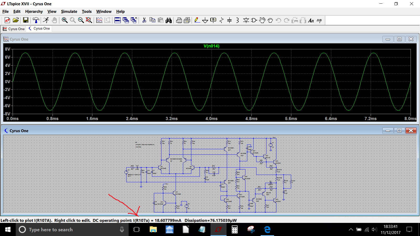

Here is the Cyrus redrawn and put into a simulation (it all works correctly) but I'm not 100% sure I've got all the reference numbers correct.

Thanks 🙂 and yes, very handy. I couldn't do that on a mobile.
