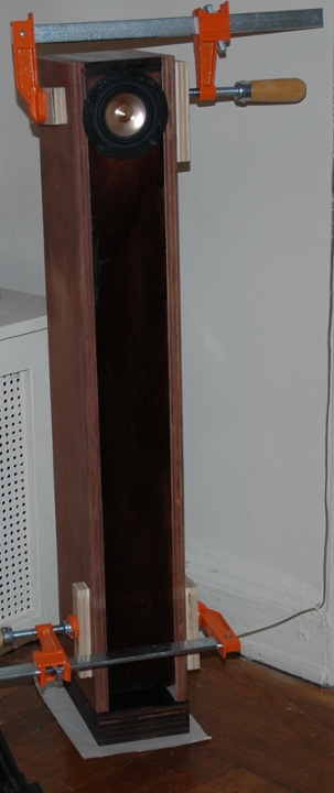

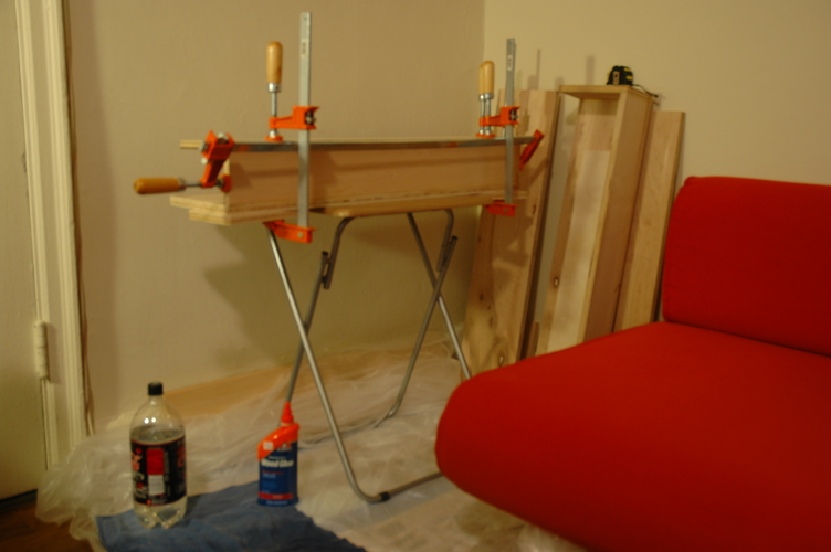

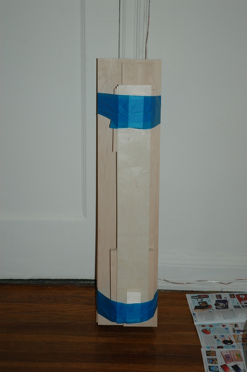

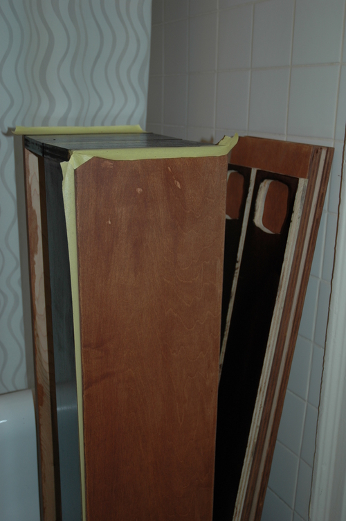

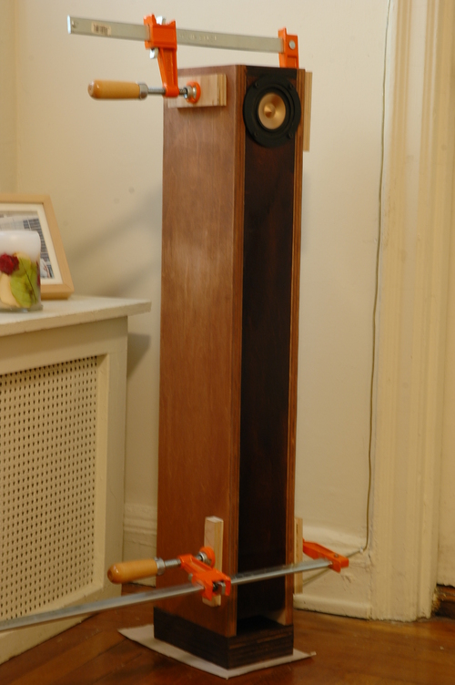

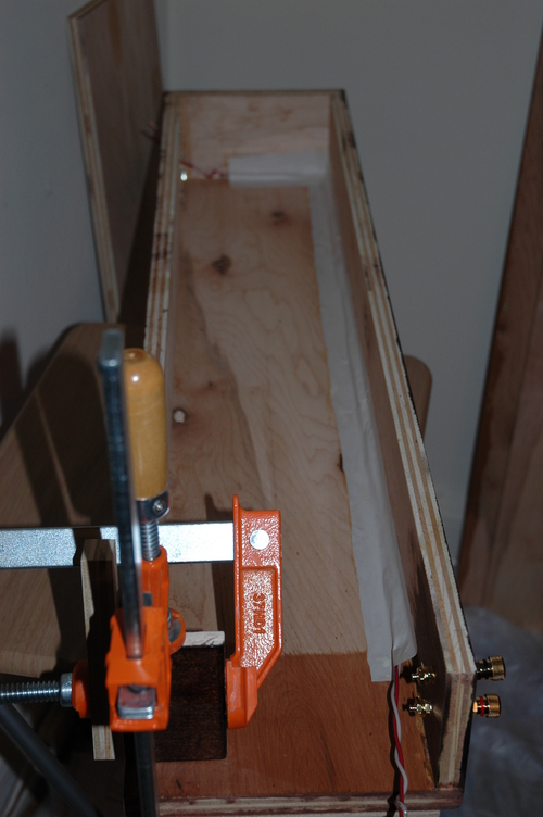

Needles with Mark Audio Alpair 6
I wanted to build the Needles about 1.5 years ago and read the whole thread here mostly because I wanted to find some opinions about currently available drivers as the Tang Bands Cyburg originally published the project with are not easily available anymore.
At that time there was only one posting suggesting Mark Audio Alpair 6 and I spontaneously decided to use it.
I built the boxes with plywood (and not MDF) using 3/4'' thickness for the walls and preserving the internal parameters given in the original project.
I'm posting some "making of" pictures. This was the perfect DIY project doable in a small Manhattan apartment requiring no more than 10 sq ft for about 2 weeks. Btw, the boxes are also perfect in size for that kind of apartments and have a very high SAF (spouse acceptance factor).
Sound: Having no conscious experience with full range drivers before, I was surprised how full the sound picture came out even with my (at that time) Kenwood receiver which I got for $20 over craigslist and the cheapest cables bought for $1 of the Chinese $.99 shop. Meanwhile I listen to the Needles using a hand made Class A SET tube amplifier and wonder how people can listen to their cheap commercial systems.
In fact my wife was initially skeptical about the sound and I was very pleased when she was talking even months after the Needles were working how she rediscovers our music every day. :)
I just wanted to inform anyone interested in playing with the idea of building the Cyburgs Needles that the Mark Audio drivers fit very well into this project.
Thank you to Cyburg (Danke Bernd!) and to this forum for the whole invaluable information! :)

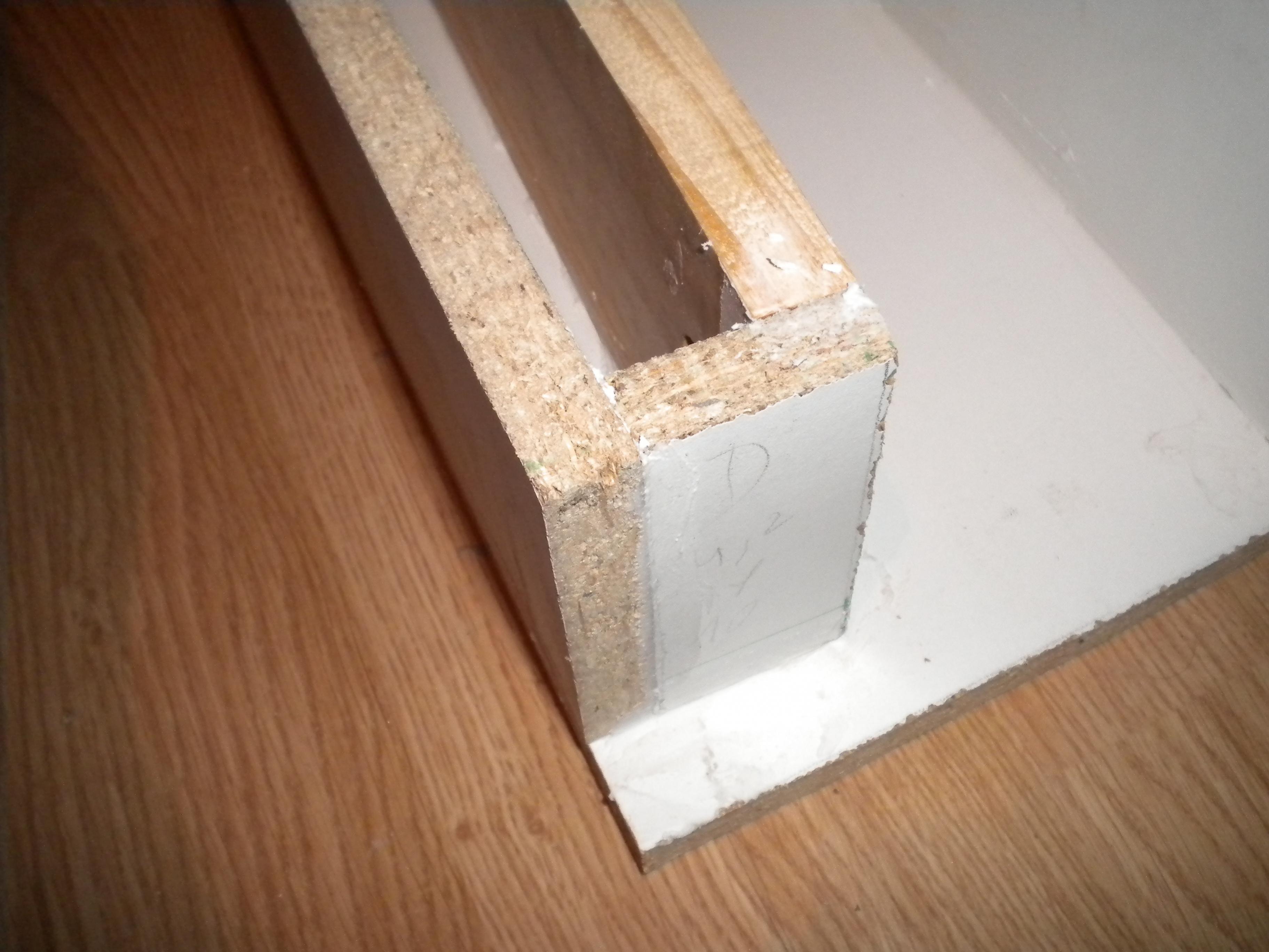

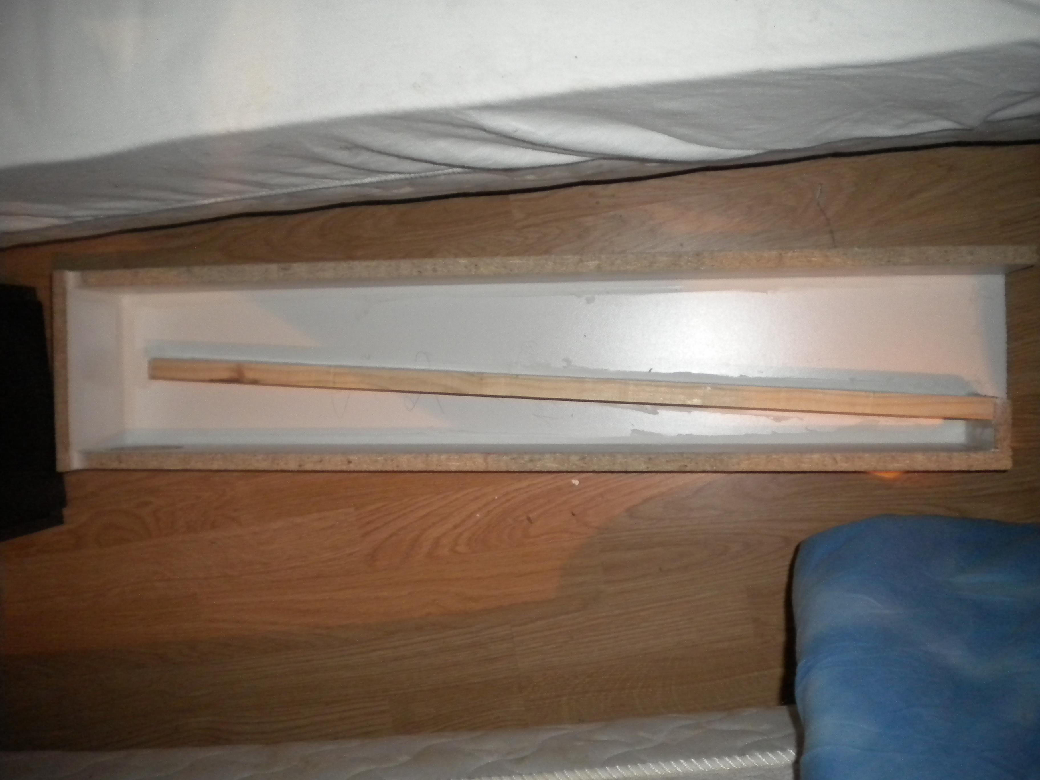

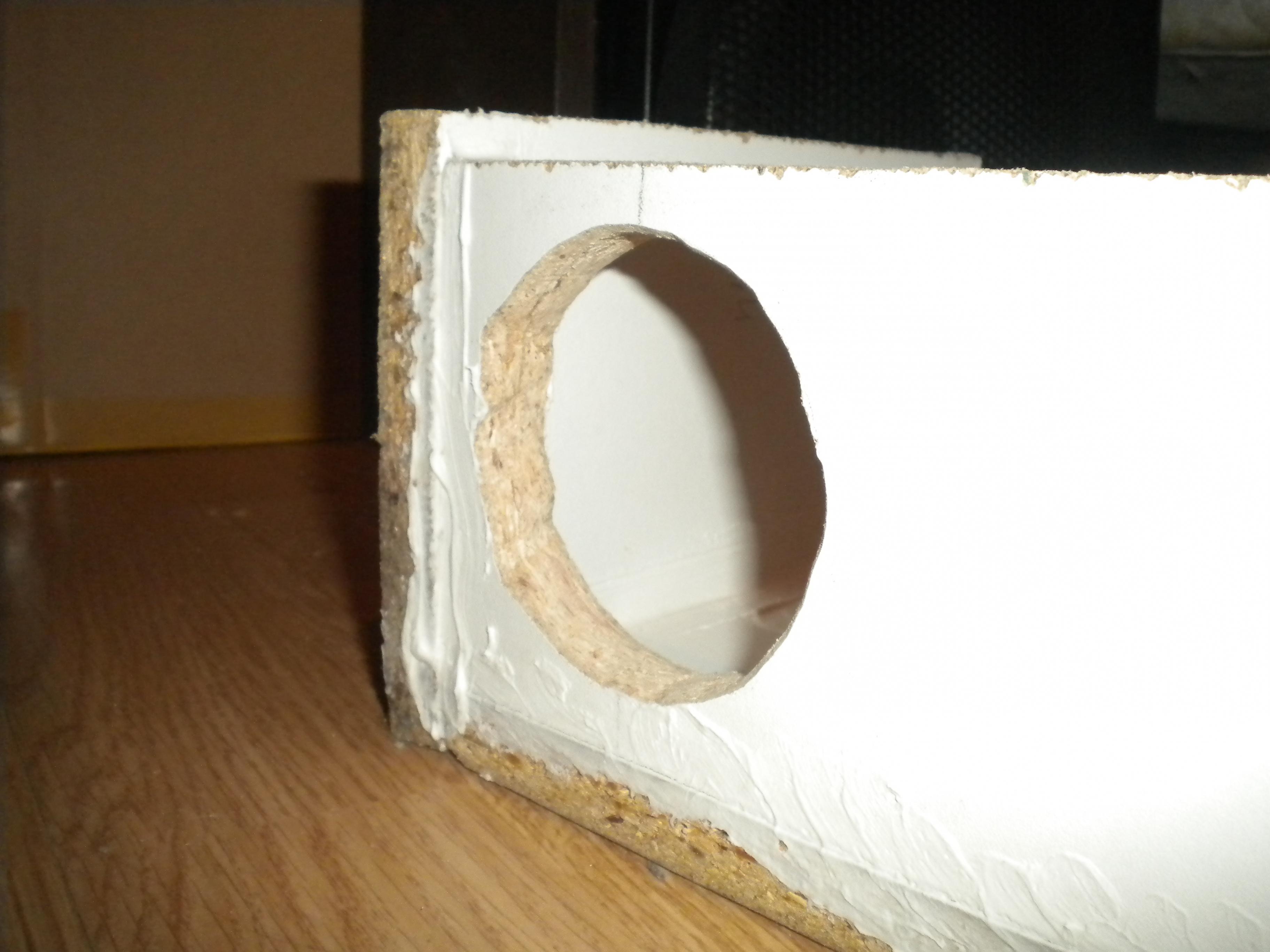

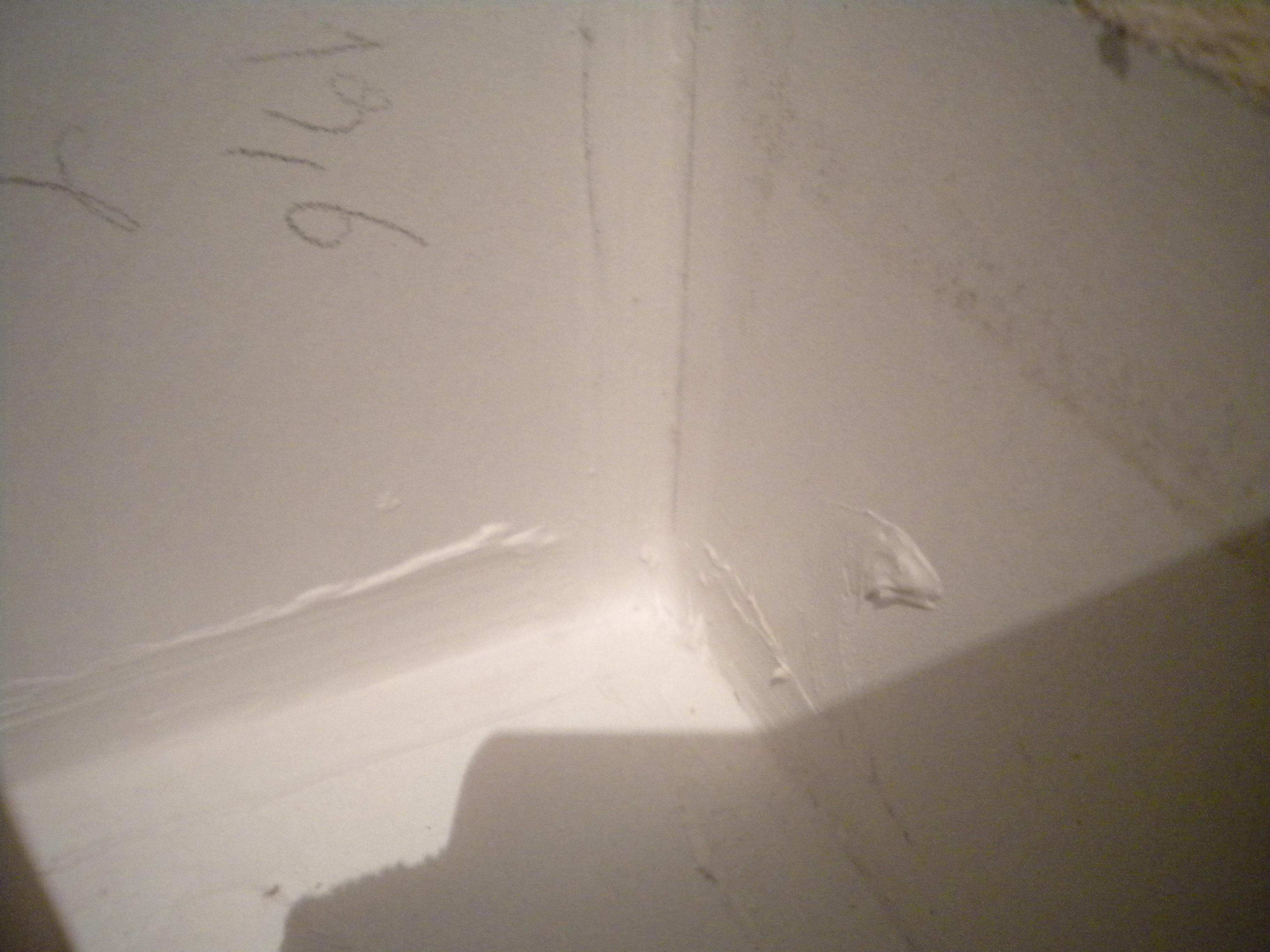

I have take some old pieces of MDF from various furnitures, 12mm :) For the C part, I used a piece from a bed :p It's just in order to do some tests, and if the results are good, I'll do two needle with nice MDF :)
I made the mesures and cut parts. I glued them with masonry mastic (for wood and rock). For the moment, I'm waiting that the mastic dry (12 hours minimum, 24 hours before paint it, 48 hours for maximum dry) and I'll test it with some foam (I don't close one side for now). I'll do some photos tomorrow ;)
So, I did some little things today: I used screw in order to fix parts eatch other (only mastic wasn't so solid). Rest to prepare and pait it (black I think)!
Sound great, not to low in frequences (I think 70Hz. I can listen 60Hz but I need to increase sound) but it's nice!
I'll post news photos when it will finish :)
